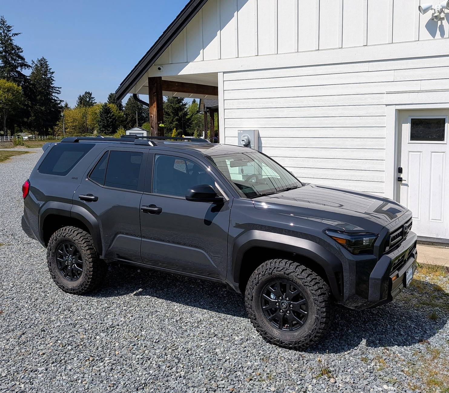

That's a lot of weird unsolicited commentary to just ask a question about tire size..
Anyways here is my SR5 with no stock suspension and no mods on 285/70/17 on stock SR5 tires with no lift or any other mods. Completely stock setup other than tires. They do not rub at all and the ride hasn't changed enough to worry about. They are Mickey Thompson Baja Boss A/Ts
Love the look! How do the Mickey's handle in the rain?

Not sure yet, haven't had any lol. They grip more around corners for sure when it's dry, that's about all I can speak of at the moment.
The unsolicited commentary was to provide needed emphasis on the tire attributes and goals. As commented by "Nubbins_" There are potential issues going with too large a tire on the stock rim.
Your choice of tire satisfies your needs and looks good but I doubt it would contribute to a quite, compliant ride on the road. I could be wrong.

Yeah, unfortunately with the rig being so new there is not a whole lot of "perfect" info on them. When I bought the tires I was under the impression that 285/75/17 were the largest tire with no modifications, I ended up going with 285/70/17s of the Mickey Thompson based on price at the time mostly which I'm glad I did in hindsight. There is another thread of mine that has a lot more photos of the fit / "poke" of them which there hardly is any. The tire shop that put them on had zero concerns though as far as fitment and installation. Ride wise the only difference that is even somewhat noticeable is a little more bounce when going over stuff mostly due to the load range being E (which this truck does not need, again just happened to have the best deal on them at the time).
