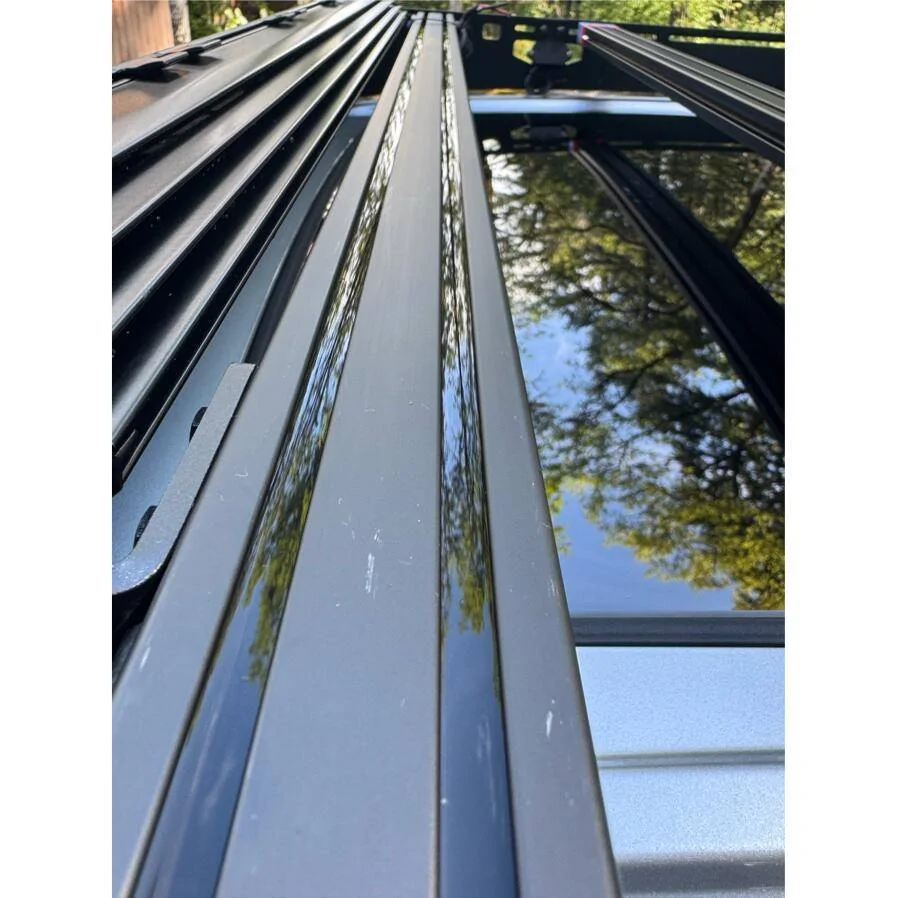

Just a quick postscript to my Sherpa Capitol rack install write up.
I discovered after washing my 4Runner with the rack on, that the T-channel slots on the tops of the crossbars fill up with water (they are essentially a trough enclosed on either end by the side rails) and would slowly seep out around the bolts over several hours and eventually evaporate.
2025 2026 4runner 6th gen Sherpa Rack (Capitol Roof Rack) installed on my TRD ORP iForce MAX IyzIH1-rsOEwQc_B2LBkhpvhtypzHSmfV
2025 2026 4runner 6th gen Sherpa Rack (Capitol Roof Rack) installed on my TRD ORP iForce MAX 2gX7GslmTgdqh5ADNtI8H5a7VdJ1crfhoA
I emailed Zach over at Sherpa and he pointed me to this product which goes easily into the T-channel slot and will block most, if not all of the water from getting in.
https://www.amazon.com/dp/B09KPZBTB9?tag=lastinglight-20
I installed it today, and it looks like it's going to do the trick! It's a soft silicone rubber that looks like it will hold up well over time, and it's very low profile, so it shouldn't interfere with my RTT and awning install.
Here's a photo of how it looks installed. I bought four of these on Amazon to ensure I had enough material to do all of the top-facing channels on the crossbars.

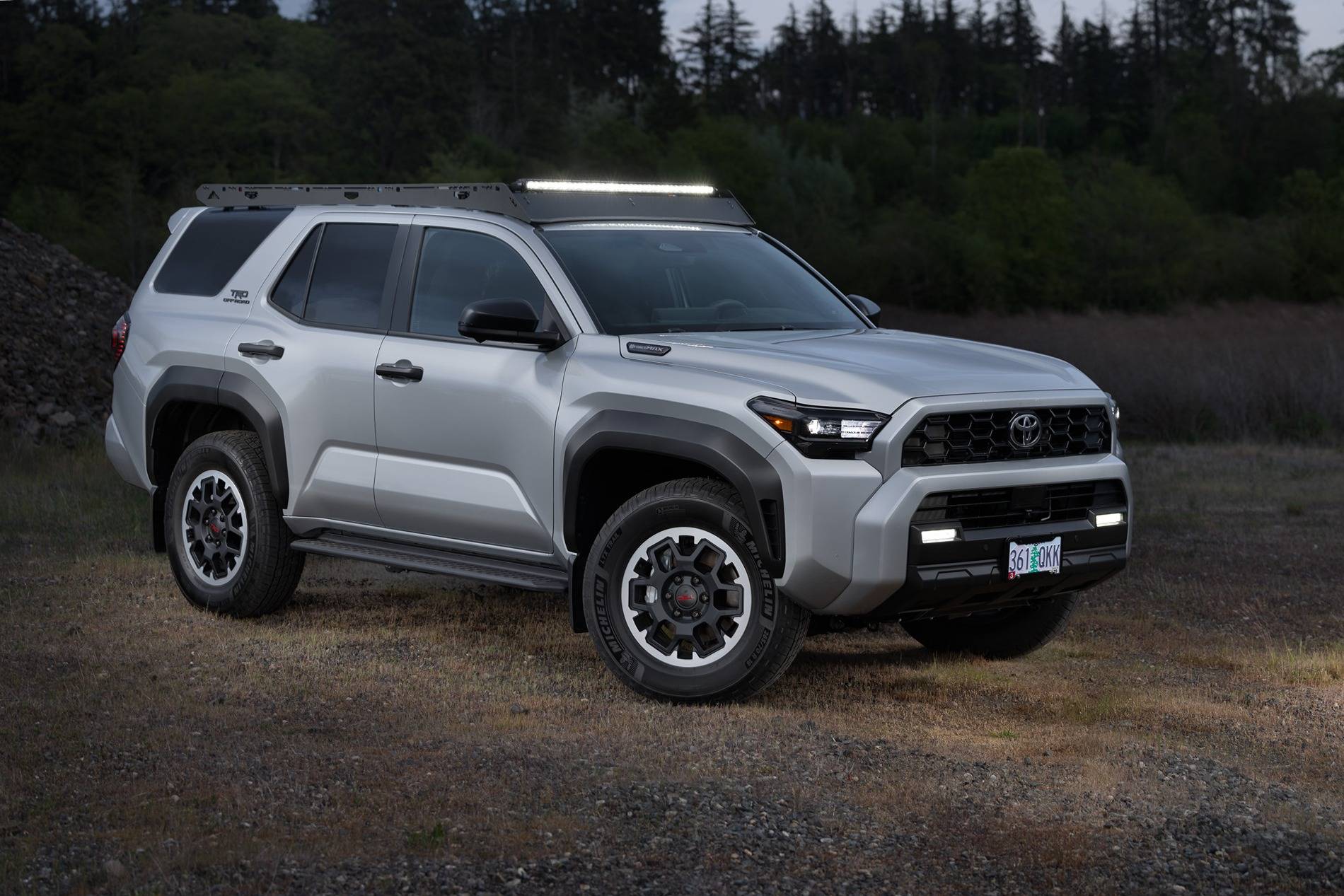

Can we get a pic with the light bar lit up? I’m debating between the full Sherpa and the half Sherpa w/light bar. Thx ??

I have the 1/2 height wind fairing from Sherpa for the Capitol rack with the RIGID SR-Series LED light bar, and there is very little light spill onto the hood. Works really well together.

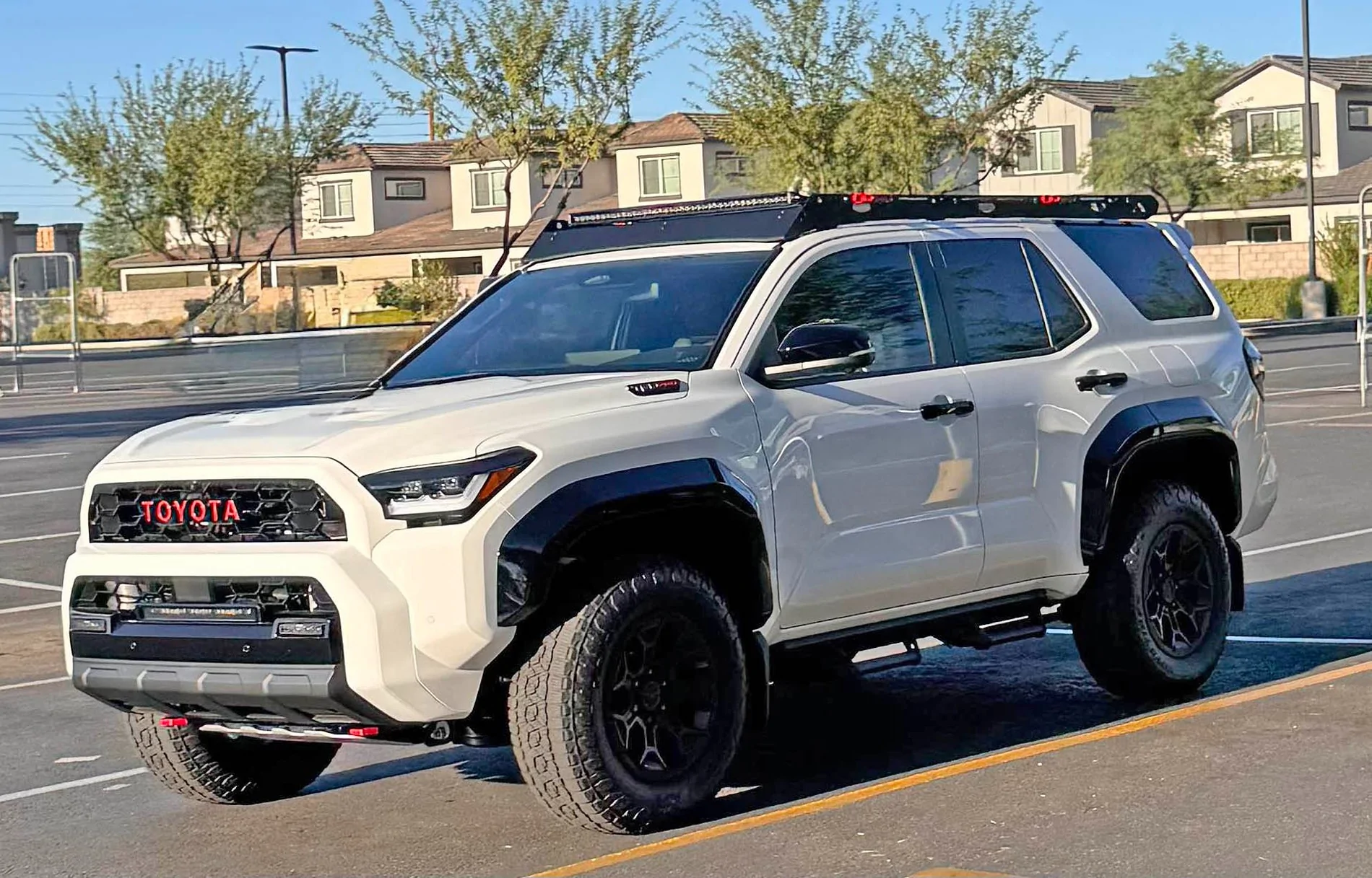

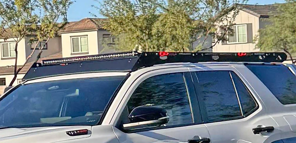

Another look at a 4Runner with Sherpa rack with Rigid light bar installed.

Which light bar is that, and what are the red tabs on the side rails of the Sherpa? Looks great!
