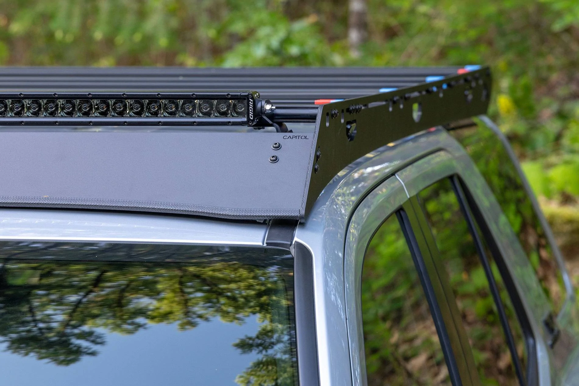

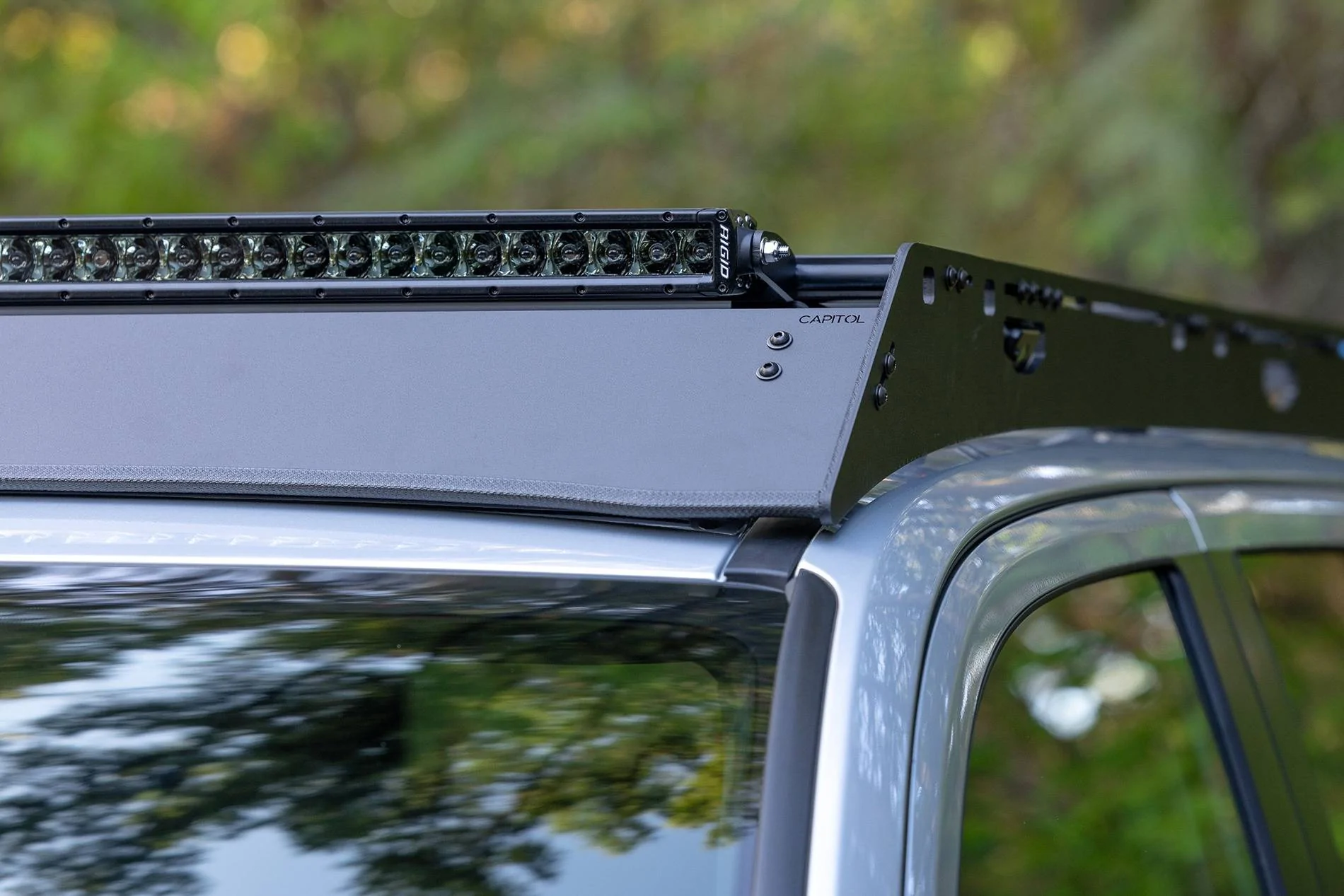

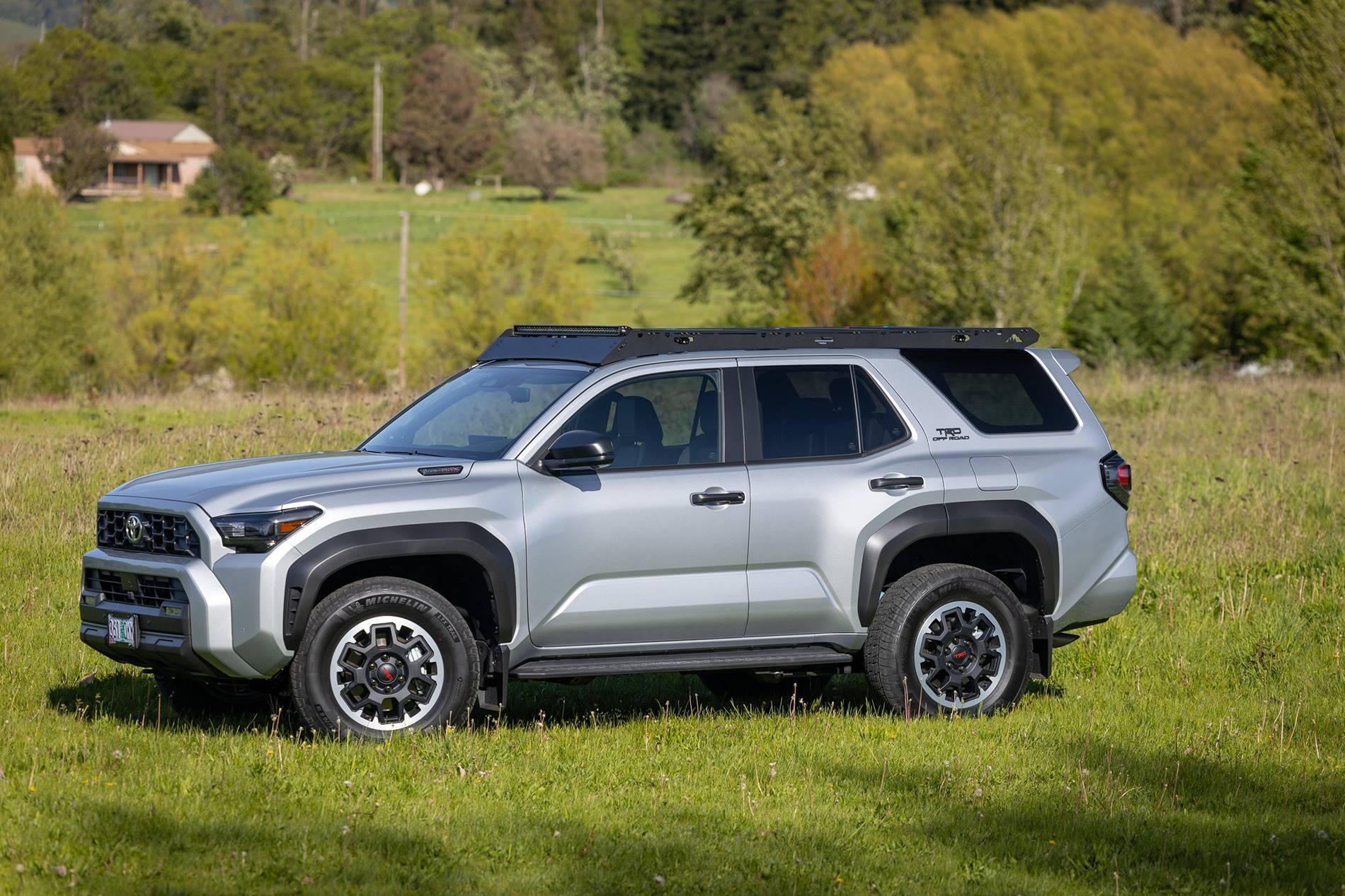

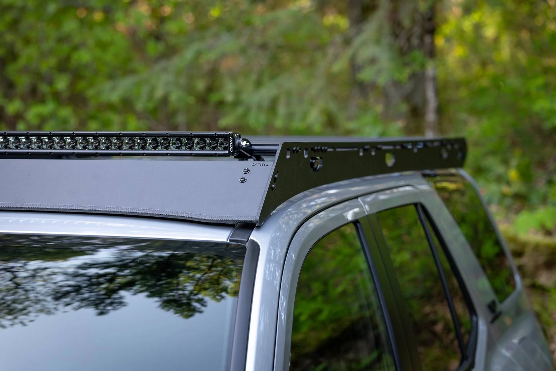

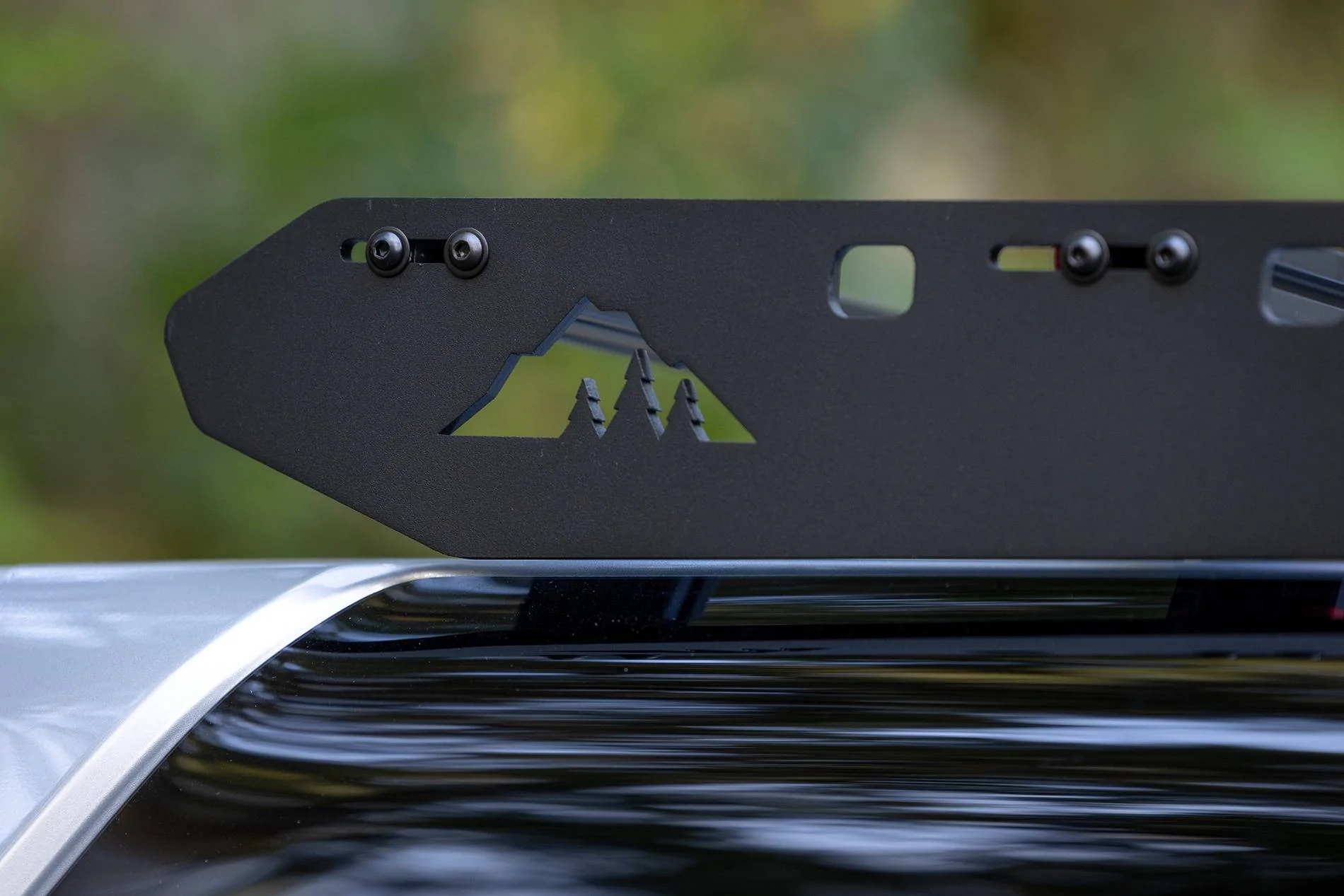

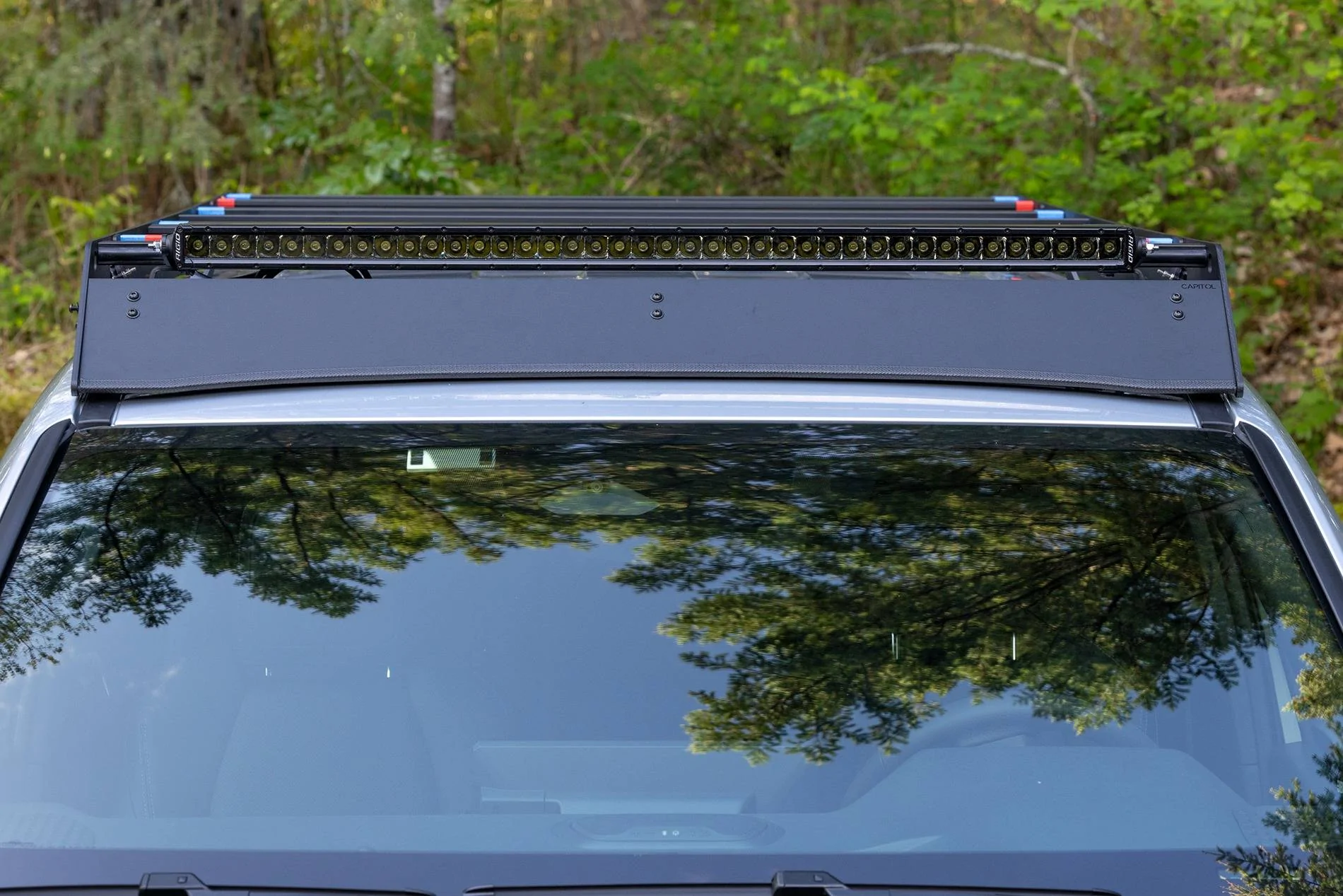

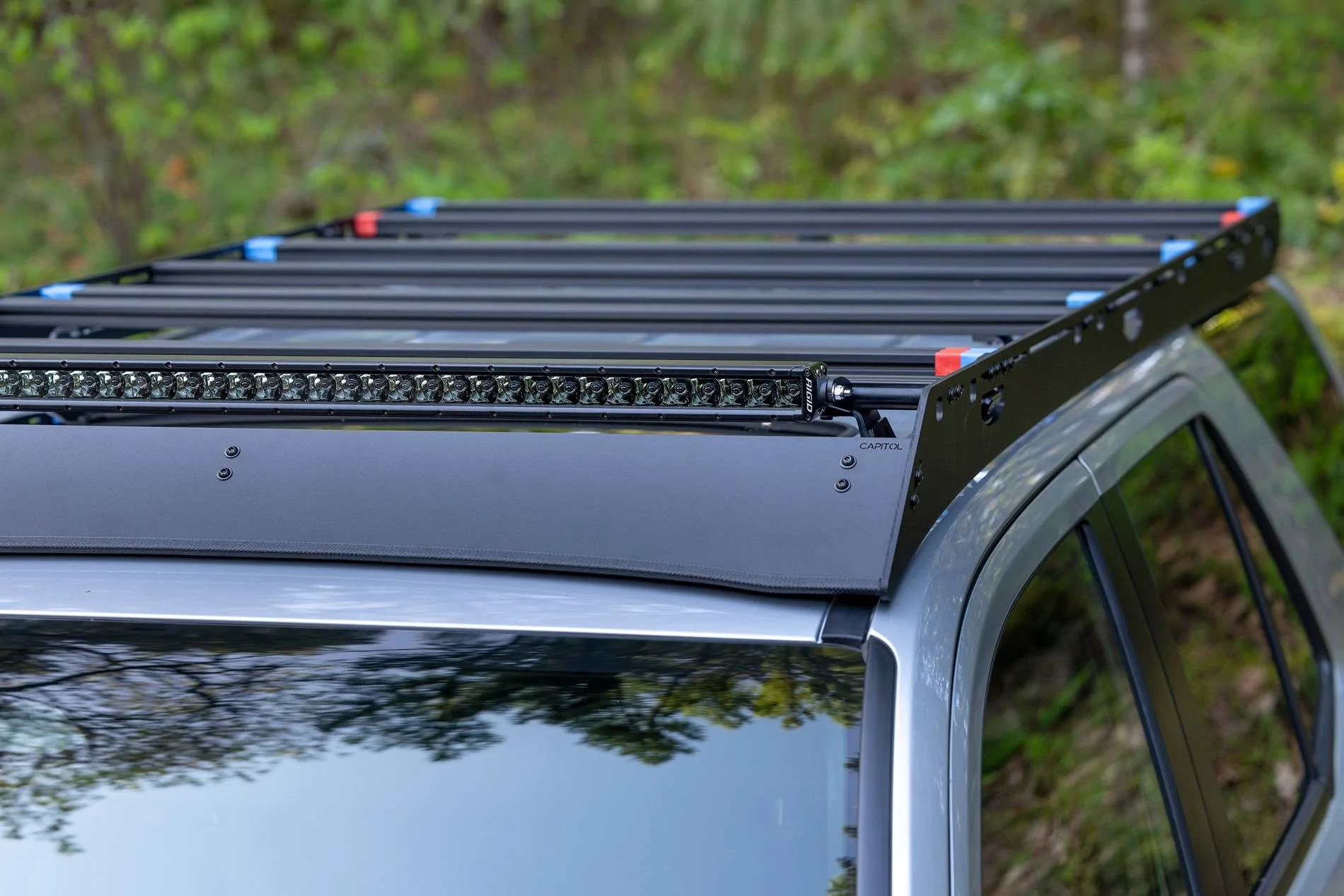

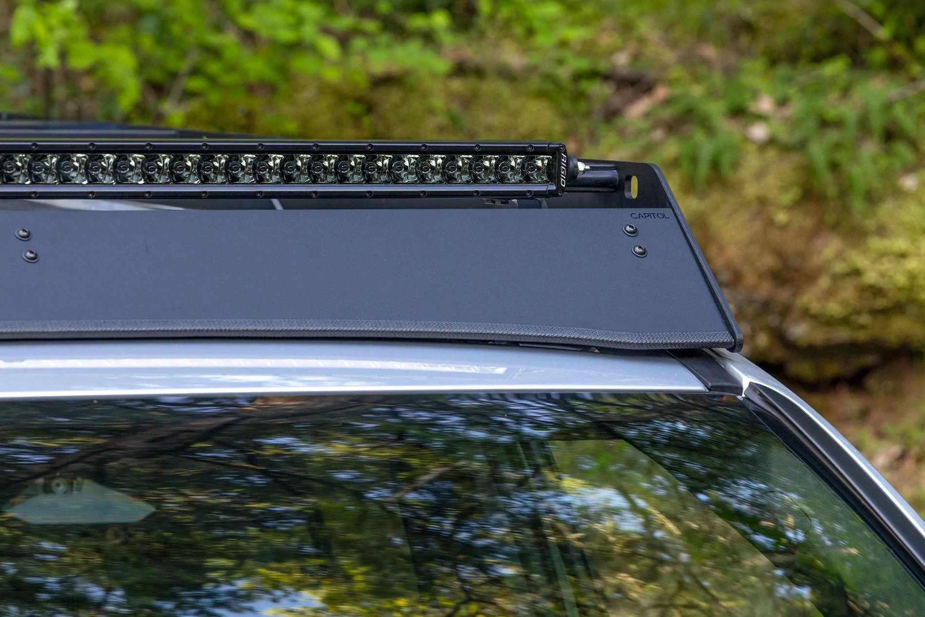

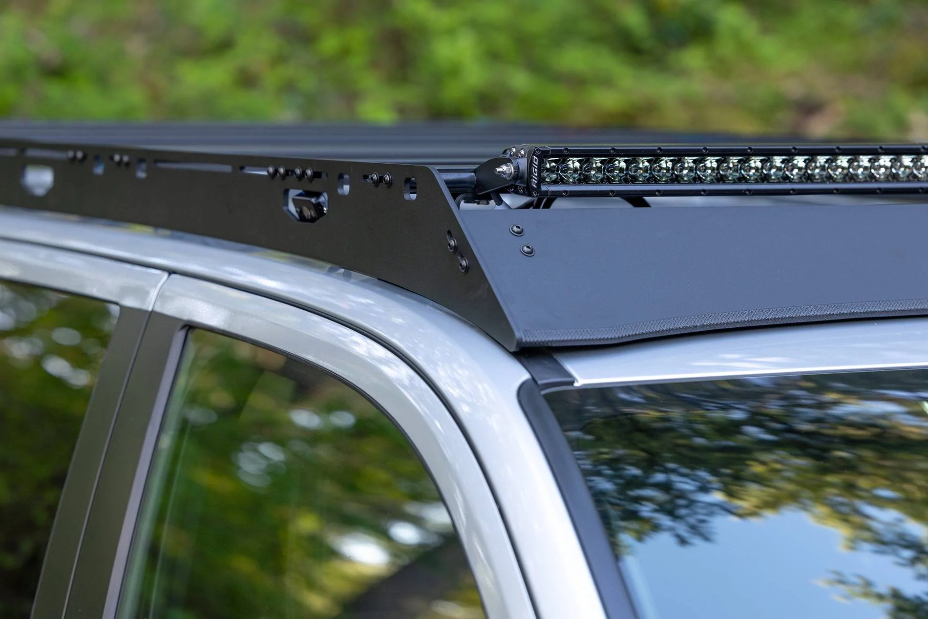

Here's a closer look at the Sherpa Capitol Rack on my TRD ORP iForce MAX. I debated between the Capitol and the Westcott Lo Pro but ended up going with the Sherpa, and I'm glad I did.
It doesn't have that much of a higher profile, but has enough clearance to allow for easy installs of the RTT, awning and other accessories. I can also confirm that it does not interfere with the sunroof/moonroof.
I installed the Sherpa last night, and the blue and red tape is marking the crossbars that will serve as attachment points for my FSR Aspen V2 RTT and a Kammok Crosswing awning. Coming soon!

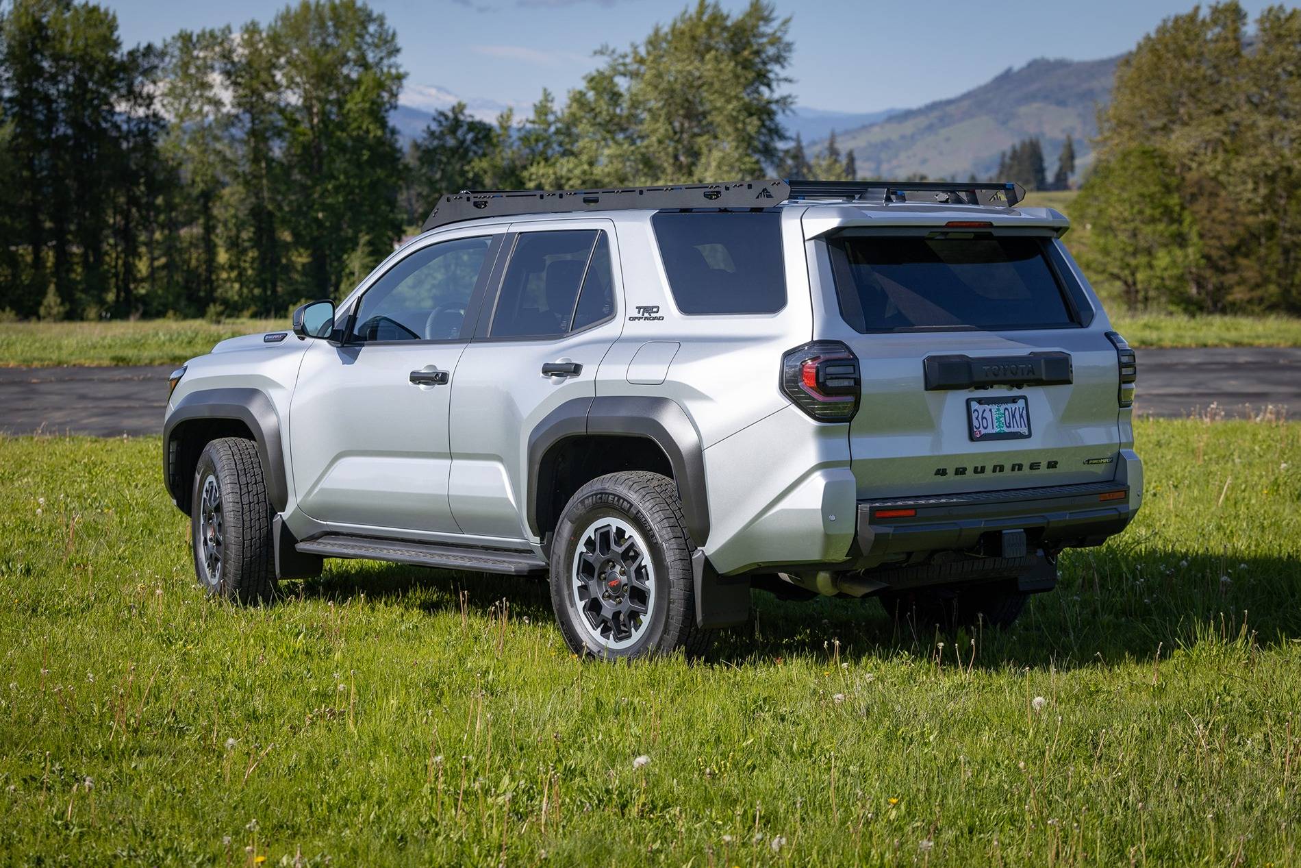

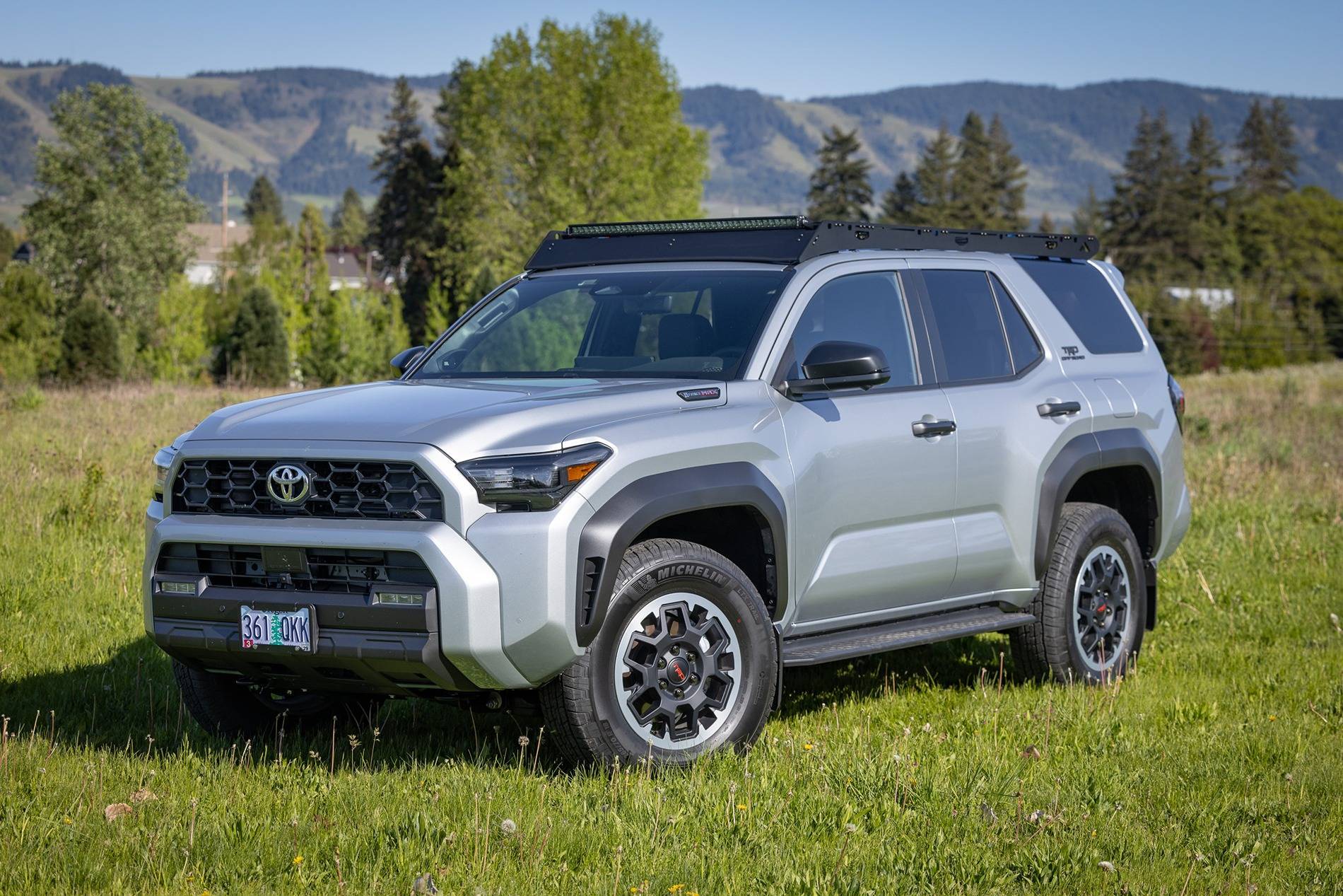

Great close up pics. Do you have any wider angle shots showing the entire rack and your 4Runner?

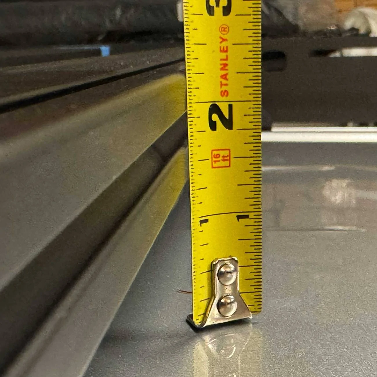

What do the think the min clearance is between the cross bars and the roof for the Sherpa Capital?
It looks to be about 1.25" at the closest point:
2025 Toyota 4runner Sherpa Rack (Capitol Roof Rack) installed on my TRD ORP iForce MAX IMG_9877
Also, the overall vehicle clearance with the Sherpa Capitol rack installed is 73.75" with the stock wheels and tires at rated inflation.

Excellent! Thanks! This should allow enough room for the Yakima Skybox mounting feet to clear the roof.

Where did you purchase the Rigid lights at and the side lights mounted on the side rail?
Concerned about the obstruction of view by a cross bar and wind noise if the sun roof is open.
Thanks!
I've attached a photo to show the top-down view with the sunroof open, but I think the real answer is that you can decide whether/where to place the intermediate crossbars to suit your needs/preferences. I'm mounting a rooftop tent on mine, which will block the sunroof anyway, so my crossbar placement doesn't reflect this concern.
I got the RIGID lights on sale in January. It's the 40" SR-Series Midnight Optics light bar, and it fits nicely with the Sherpa rack and 1/2 height wind fairing using the Sherpa mounting brackets.
The scene lights are the Baja Design LED Dome lights, and they mount behind the openings in the side rails.
