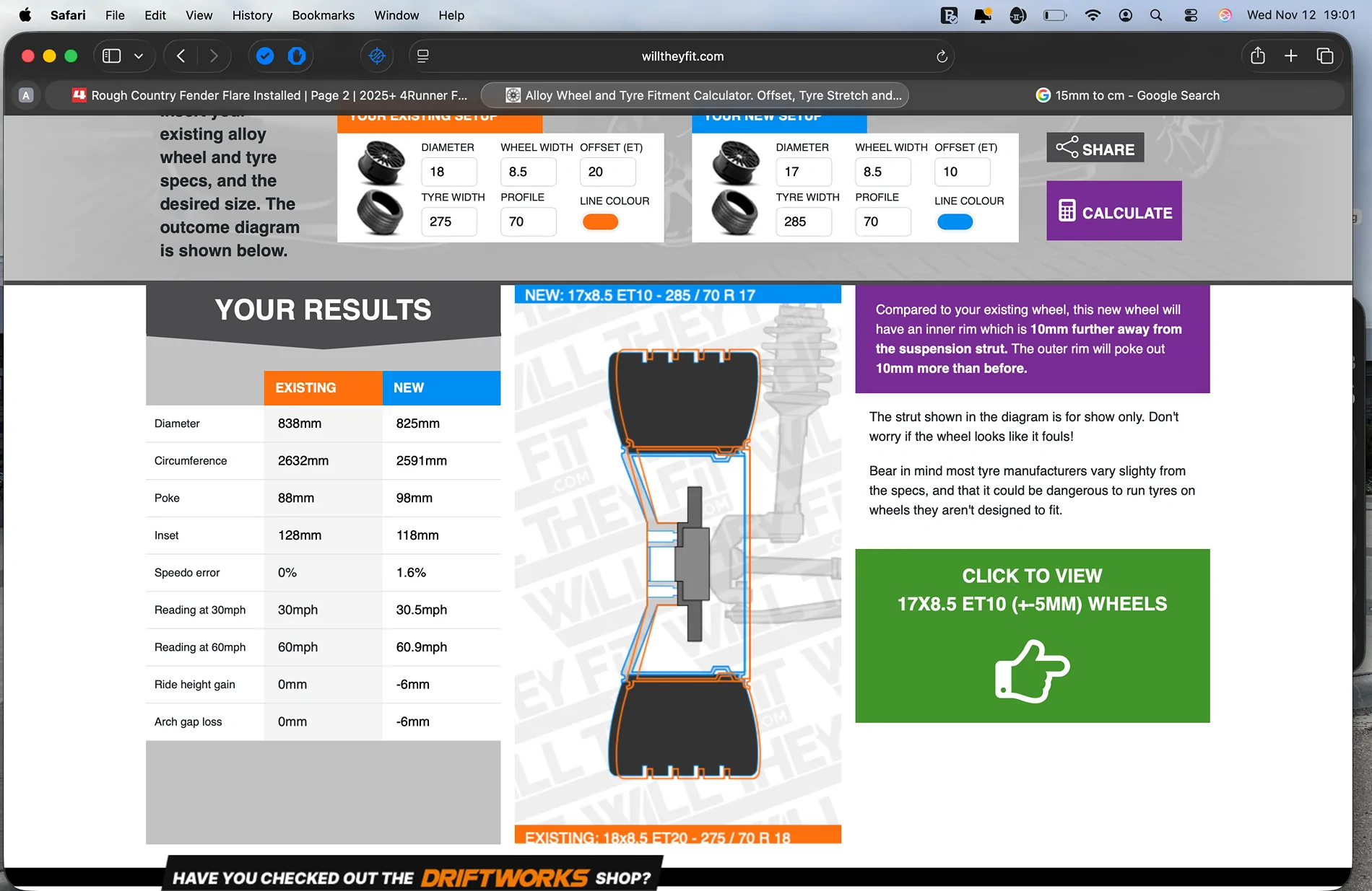

Thanks for the above pics/vid! I am looking to order these as well but was curious... is that 1.75" on top of the OEM flare? Or, in place of the OEM flare measured from the body? From some of the pics it looks like it's an additional 1.75" on top of the OEM flare but when I emailed RC they said it was 1.75" from the body (which is only 1/2" more than my TRD ORP OEM ones... which doesn't make sense).
I have +10 offset wheels coming so am wondering if these would fit well.
Thanks!

I had the same conversation with RC!
Confirmed it’s an additional 1 3/4” from the current OEM flare.
One image shows this!
Is your wheel width 8, 8.5 or 9" Wide? 17 0r 18" ?
I feel like 1.5" Would have been perfect with 17x8.5ET25 or 20
Thanks! Glad I wasn’t the only one haha
It’s 17x8.5 +10

Will have a RC 1.5” level kit eventually but for the winter will remain stock
Only going with 285/70 tires
Did you confirm this set up with stock suspension won't rub in the front ?
It should be ok for the type of driving I’ll be doing until the level kit goes on. Worst case I’ll install it sooner.
Mostly curious about how much poke there will be (if any) with that setup and these flares.
Comparing your set up the the TRD Pro with 18x8.5ET20 Wheels and 275's your gonna be 10mm further out. It's hard to tell but I think you are gonna sit pretty close to flush?!
If not Just under !

Oh that’s a neat tool
I think the RC flares are wider than the TRD Pro flares also? Or are they the same?
The TRD limited Griffin27 in this section you see has the RC Flares installed!
With TRD pro Wheels 18x8.5ET20 running 275/70R18 Meaning you will gain an additional 10mm outward with your set up. (Sorry I missed Griffin27 has a Limited that looks like a PRO)
Yes RC is wider than TRD pro flares
hopefully they sit flush or preferably poke out a tiny bit - I prefer it when they are that way vs being inside the flare.
I agree they look a bit goofy when sitting inside, and no one wants to be goofy!
Like the old Chevys and Dodges farmers had!

Heard back from RC again and now they say it’s 1.75” more than the base SR5 flares - less for OR/ORP models. Didn’t even know there was a difference in OEM flare size on all non-Pro/TH trims.
