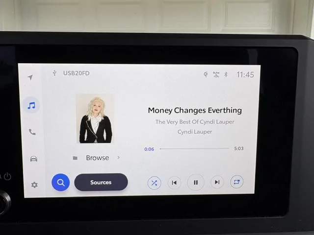

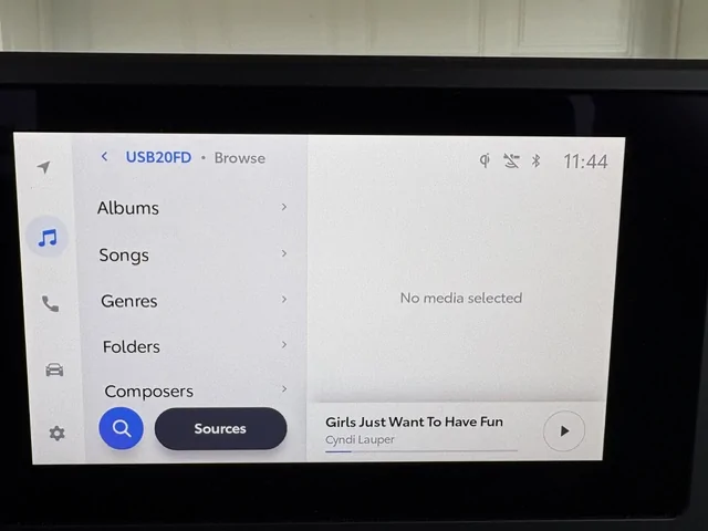

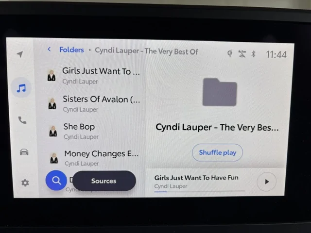

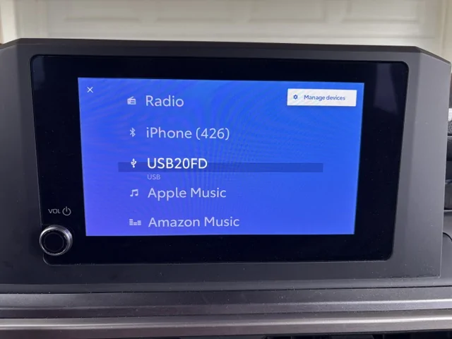

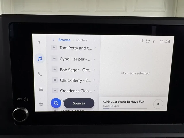

Thanks to Ross for posting about hooking up a CD player to his 6th gen 4runner. Others pointed out it might be better to rip the CDs to a medium such as a jump drive. Having never "ripped" anything in my life, it took maybe an hour to figure out how to do it right. I've now got 15 albums ripped to a 32GB jump drive, and couldn't be happier with the results. Here's a summary of the steps, followed by a set of pics outlining the procedure from ripping the CDs to playing them in the truck.

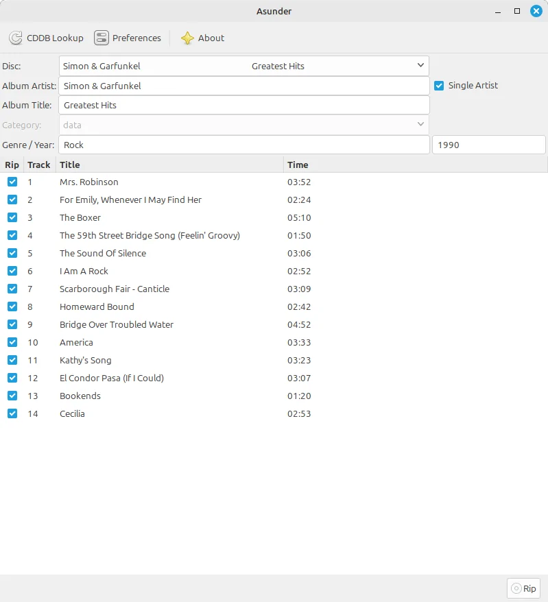

Off to Linux and there's a free tool called "asunder" that just works. I've included some screenshots below. To get the metadata, asunder goes online, defaulting to gnudb.gnudb.org I don't know what Windows Media Player tried but whatever it was didn't work.
Asunder automatically found the metadata and filled it in. I went into "Preferences" and told it to only produce MP3 files. It chose a default bitrate of 190 Kbps which I didn't dare touch. Hit the "rip" button (bottom right of 1st pic) and it took about 8 minutes per CD to complete writing to disk. Probably writing directly to the jump drive would work, but I chose to write to disk then copy to the jump drive which went very fast.
Now plug the jump drive into the infotainment (with USB->USBC converter if necessary) and enjoy your music.

Interesting. Does ripping to phone give all that same metadata indicated in my post? Note for e.g. Cyndi Lauper it even downloaded a picture of her.
I should also have noted when playing the songs in the truck, it automatically moves on to the next song after each tune. "shuffle play" probably works as advertised but I haven't tried it.
