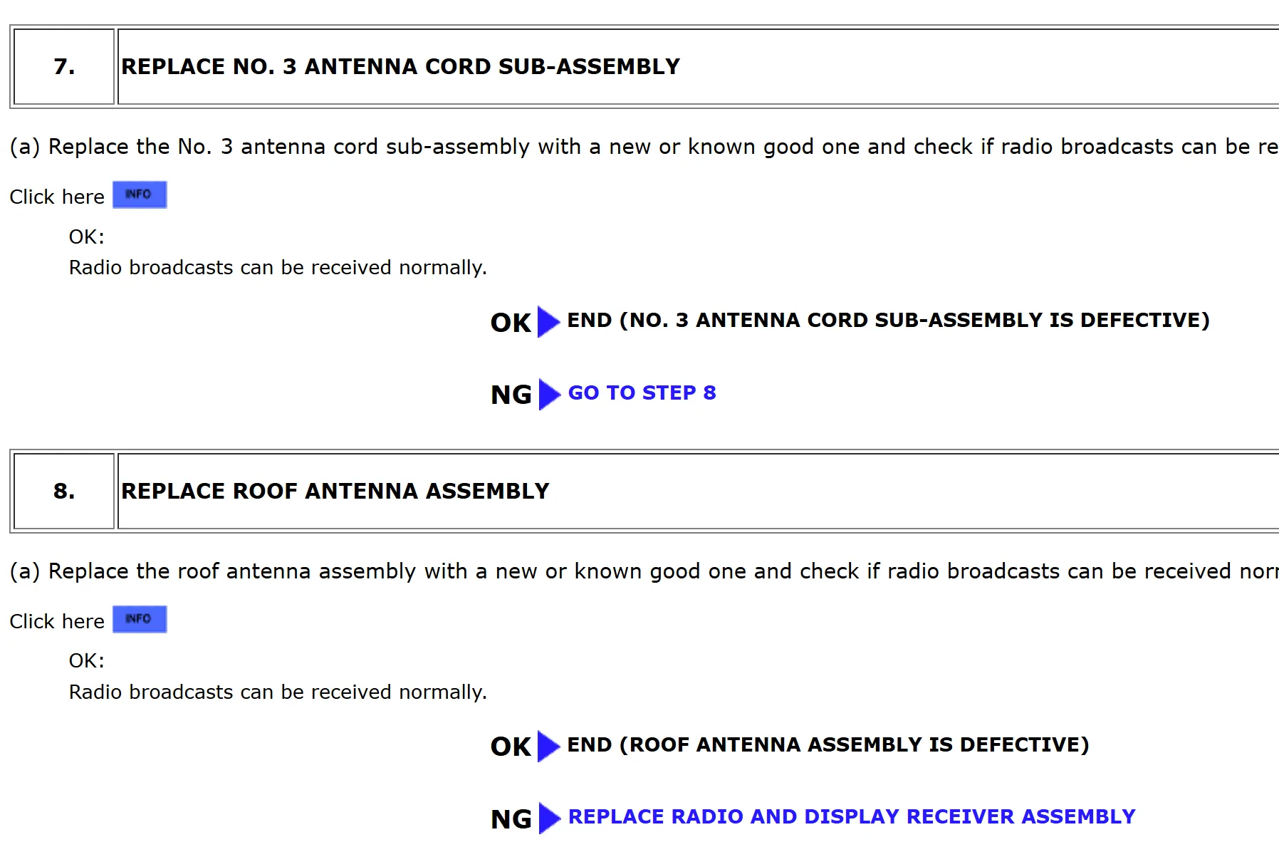

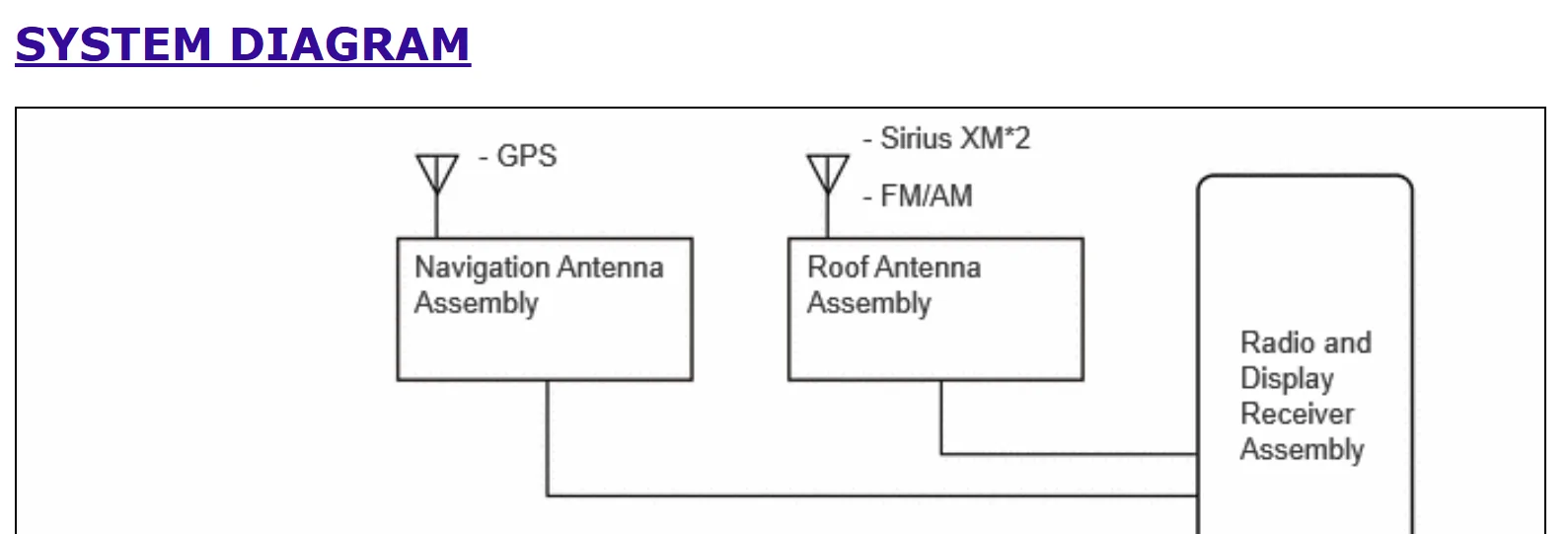

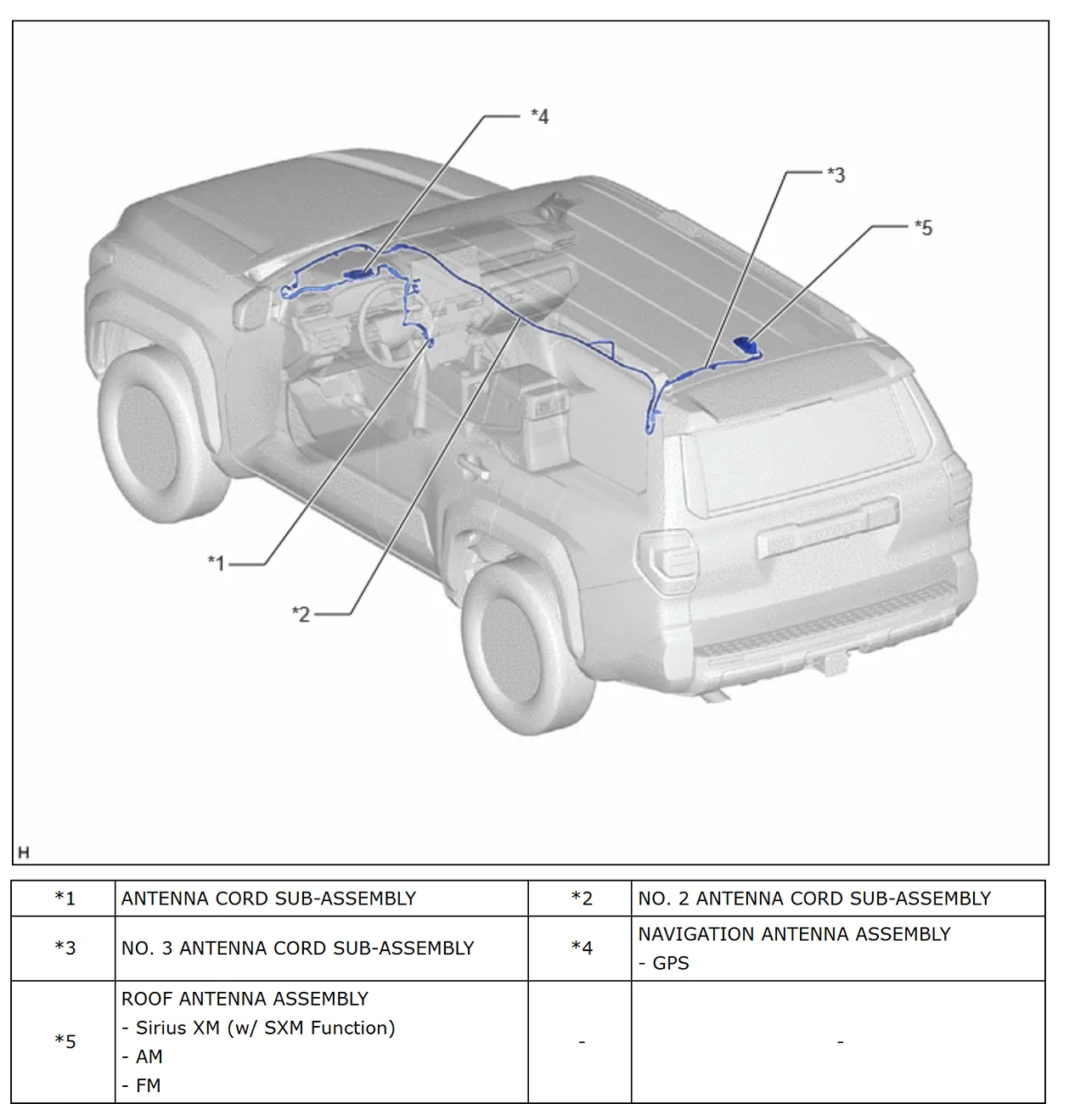

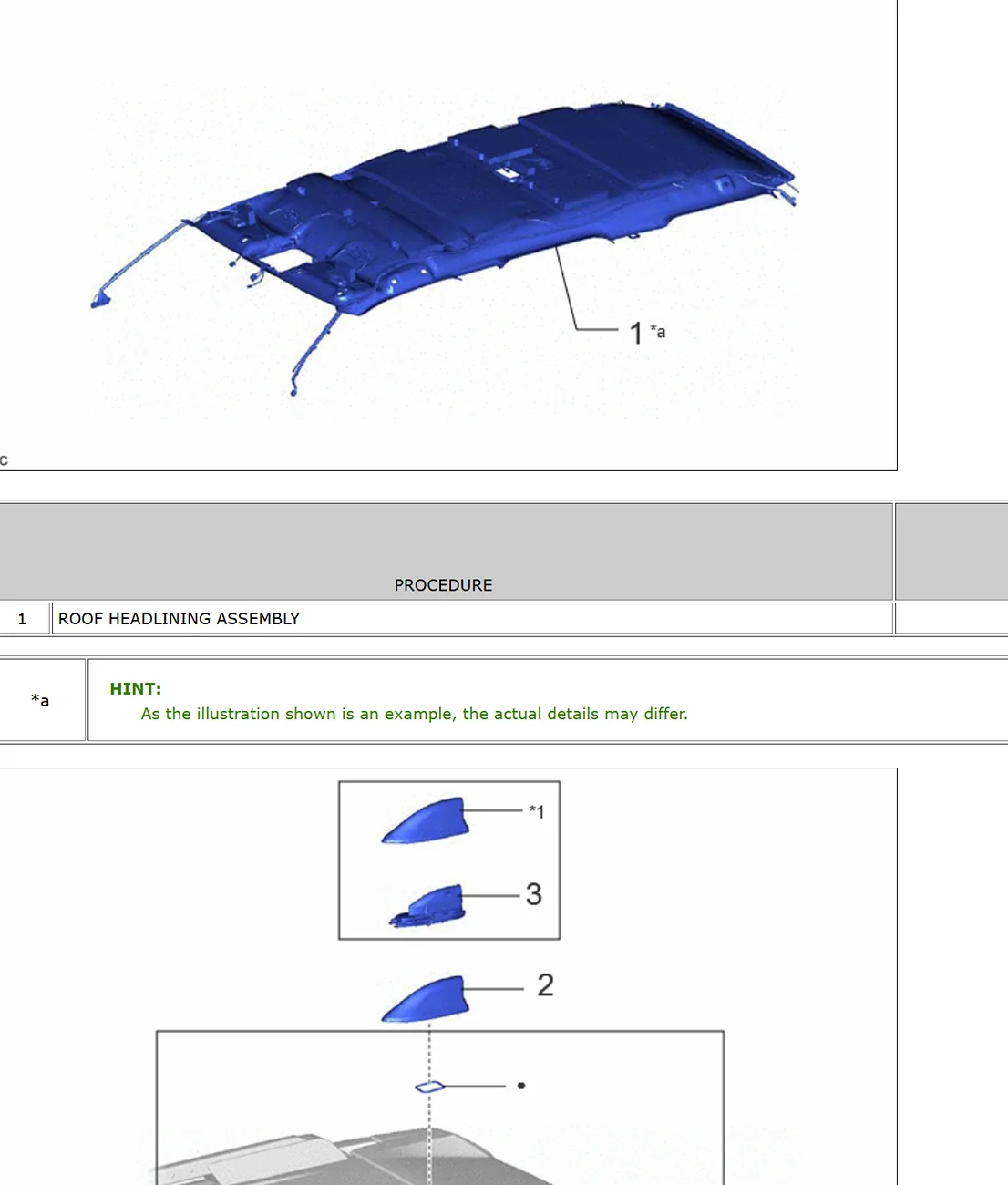

ah nope...
on older 4runners the added window antenna was on a fixed rear side window
in the 2025/2026 TIS there is one antenna, the roof antenna, that handles all of it.
no mention of any back door window antenna and no wiring diagrams for audio/visual/telematics reference it. am/fm/sirius is all in the sharkfin with added amplification
circuitry
2025 2026 4runner 6th gen Poor AM FM Reception on 2026 4Runner with JBL Infotainment System 1779360377226-4t
please show us the antenna connection reference to back door window
the am/fm poor reception diagnosis only references antenna cables in dash and
the roof antenna. no such back window glass antenna anywhere in TIS
2025 2026 4runner 6th gen Poor AM FM Reception on 2026 4Runner with JBL Infotainment System 1779360583458-u7
2025 2026 4runner 6th gen Poor AM FM Reception on 2026 4Runner with JBL Infotainment System 1779360733161-nn
2025 2026 4runner 6th gen Poor AM FM Reception on 2026 4Runner with JBL Infotainment System 1779360923856-bm

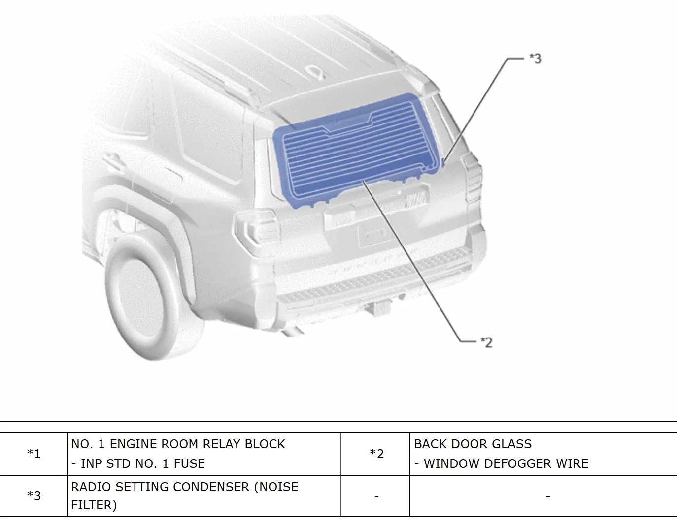

Now on the back glass there is a noise filter for the radio, which, when the defogger is ON, helps suppress the defogger EMI so you don't get static when defogger is on. this is NOT an antenna for radio, it is an EMI filter
Good info. Look like I have incorrect data. I wonder what is the antenna in the rear lift gate's window are for...🤔
Wahoo
Dec 2, 2025
Alabama
2000 Land Cruiser
The “antenna” in the liftgate window is for defrost/defogging.
