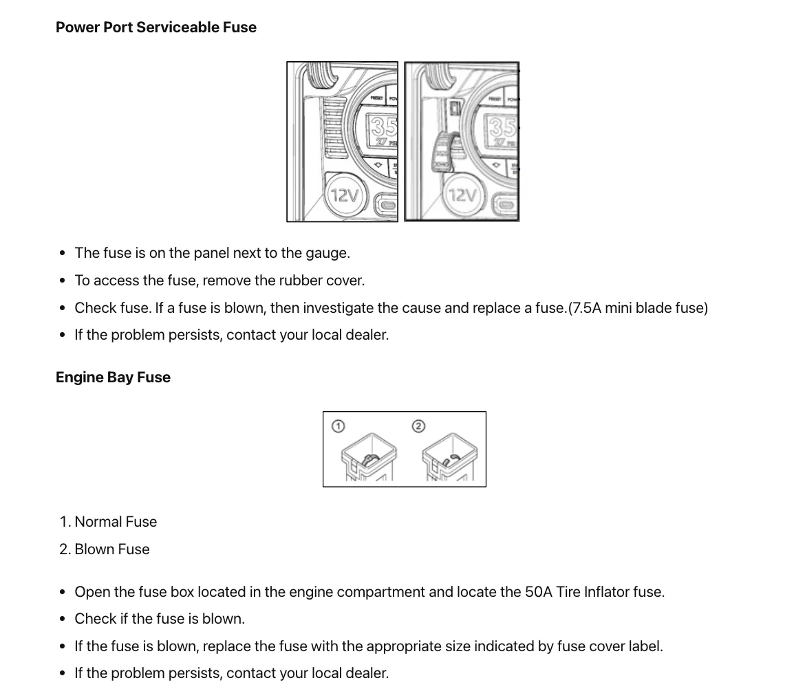

I am still trying to understand how these ports function. I just went out to mine and neither the 12v or the USB-C are working with the compressor turned on and the vehicle ignition on, "On". If you go into the menu of the compressor there is a settings menu, under that menu is an option for Power Ports > Manual & Automatic. Neither setting let them provide power. Still researching.

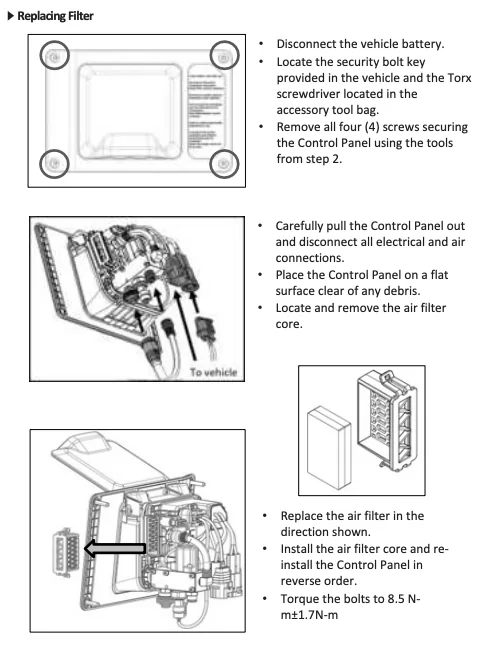

Also worth noting there is a filter in there that needs servicing at some point. Found a PDF for the compressor on a Taco.

Ah, thank you, sir! Sadly, the fuse is intact but I'm getting no power to it. The air pump powers up though.
Ugh, looks like the engine must be running to use these. I am not near my truck right now, but if you want to try if you are.

It appears that the air pump needs to be powered on for this jack to have power.
