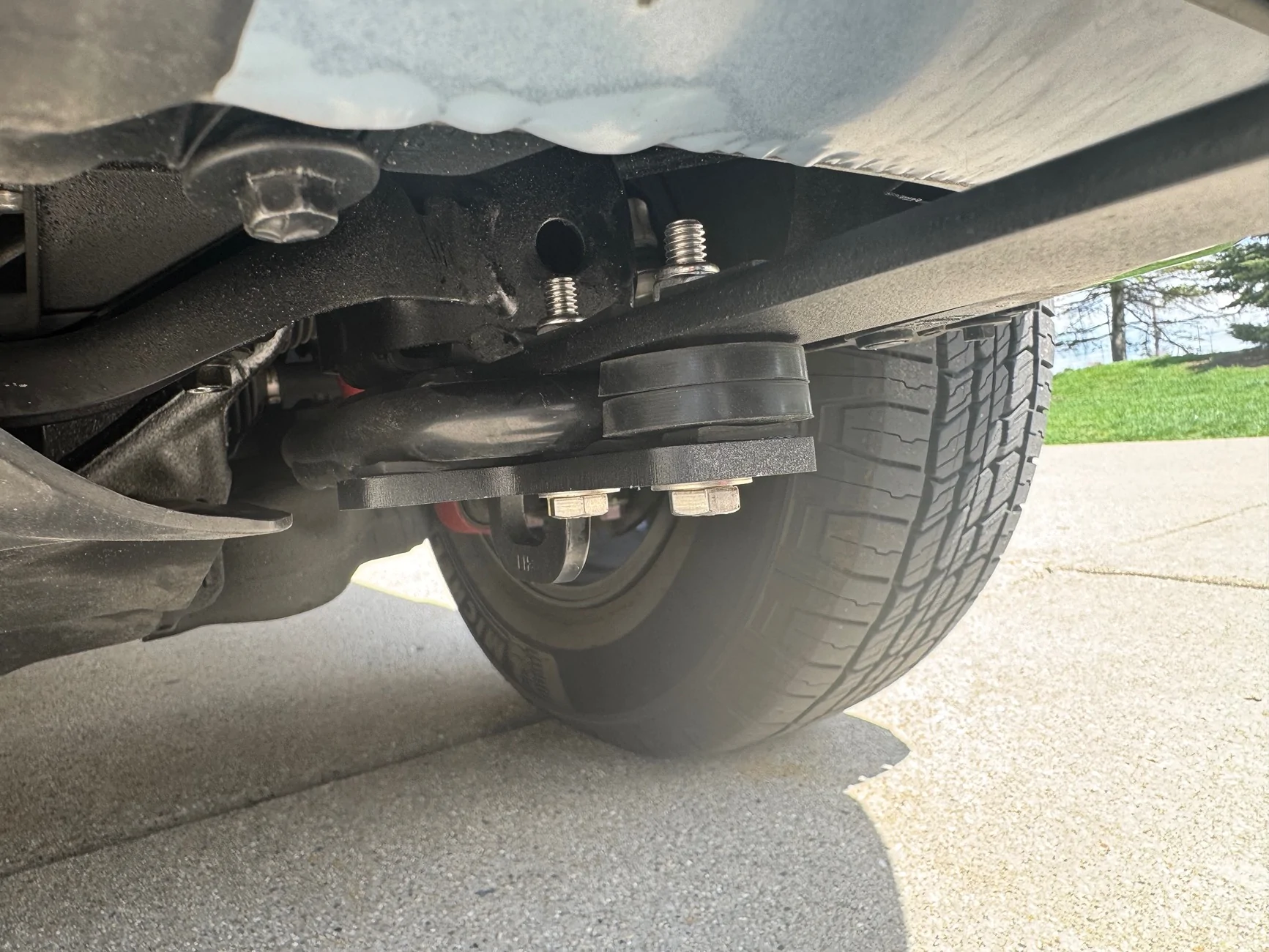

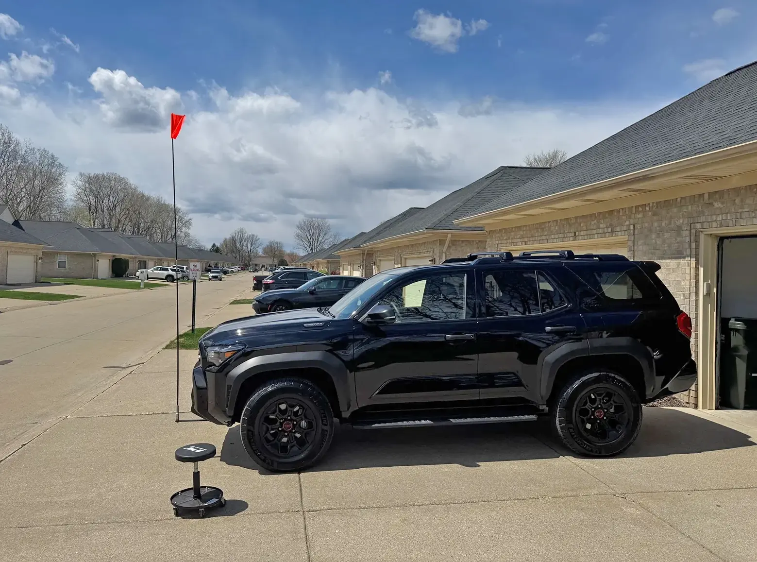

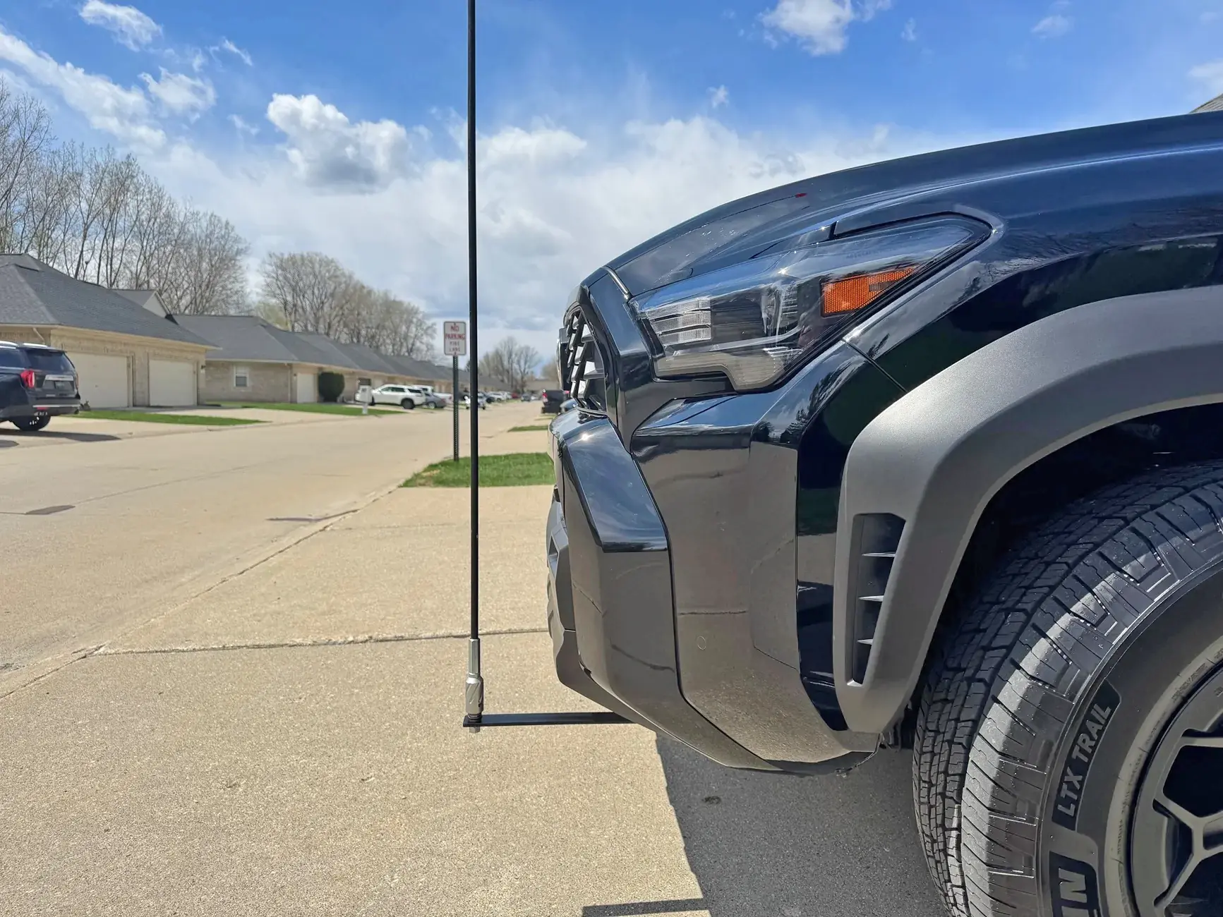

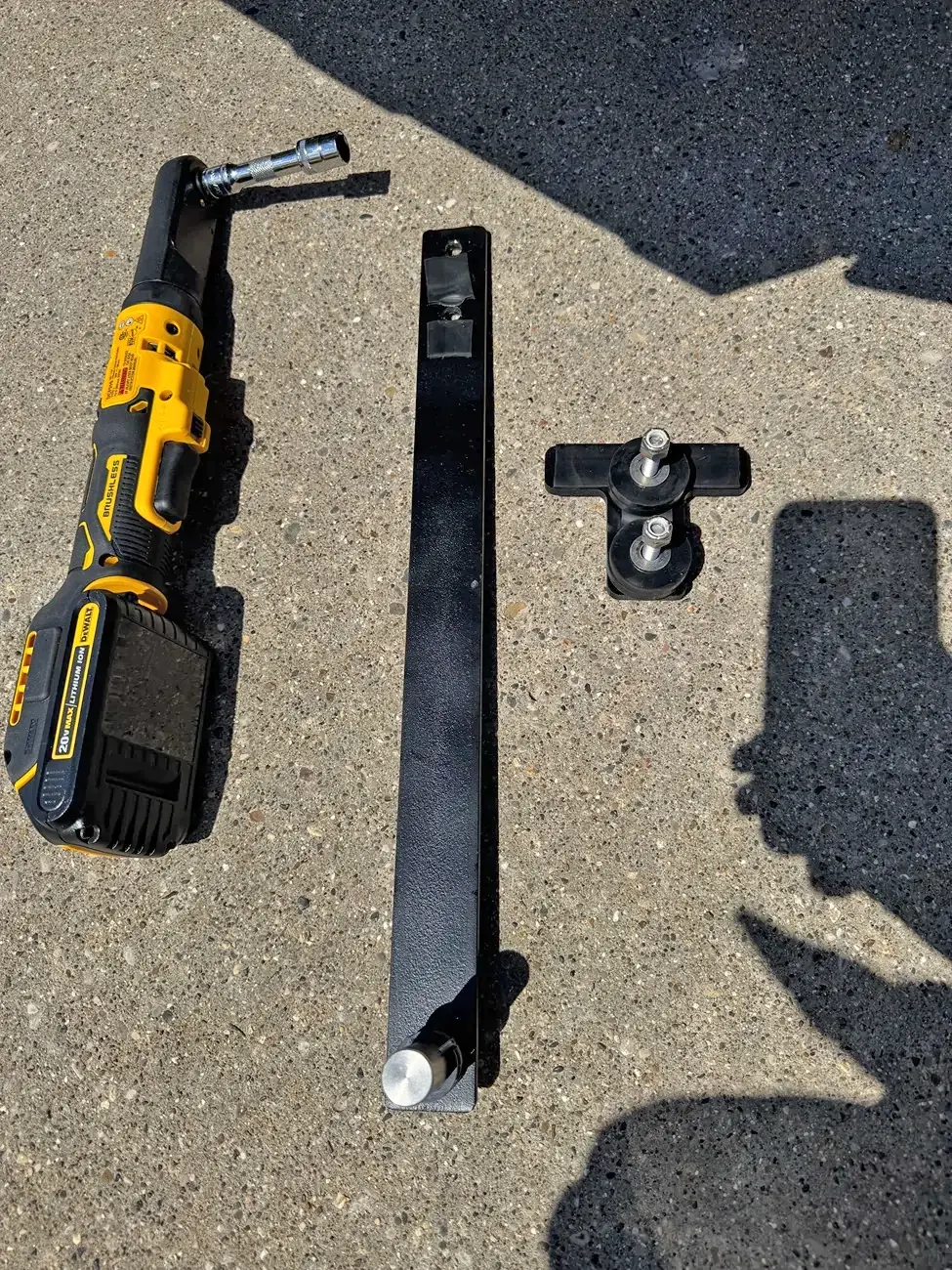

I haven’t seen much info about front mounted dune flags, which is required for Silver Lake dunes in Michigan. Here’s one I threw together using some scrap metal and some rubber washers from Amazon. It attached to the front recovery point.

Also, i assume you will leave the flag on when going to costco, to let people know you offroad? Maybe get a wittle wed trd flag?
All in all nice idea and looks awesome!!

Great idea . I was thinking about bolting a metal bar to the skid plate , but I like your idea better .

Have fun! I was just there a few weeks ago and it was a blast. The local shop also has in stock flag mounts that work for the new Tacoma's and 4Runners so I just bought one from them. It was around $30.
