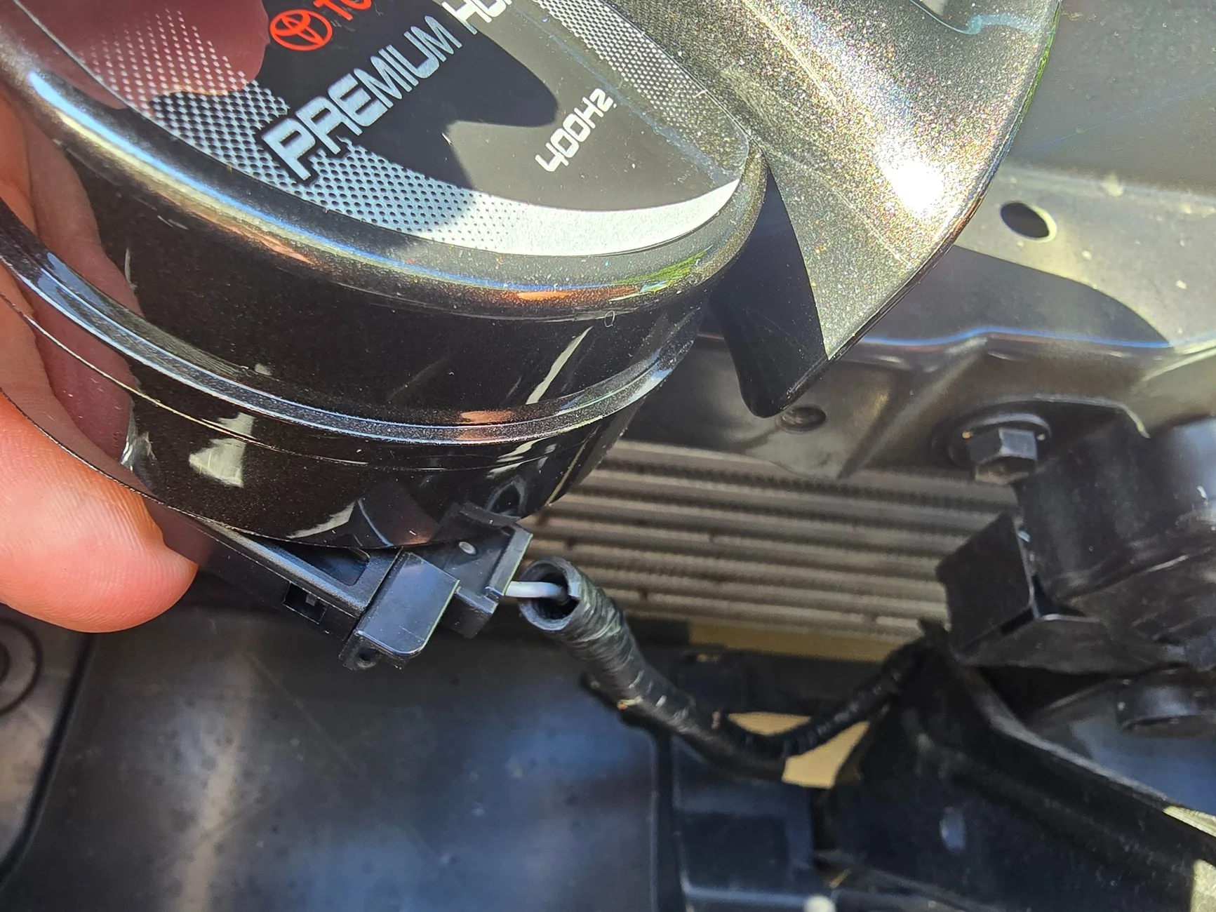

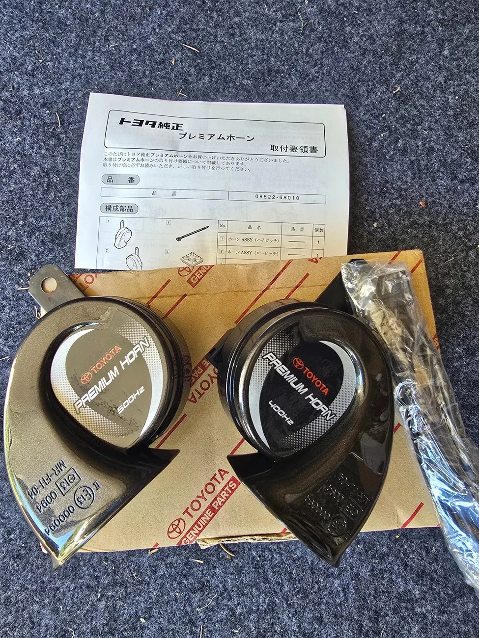

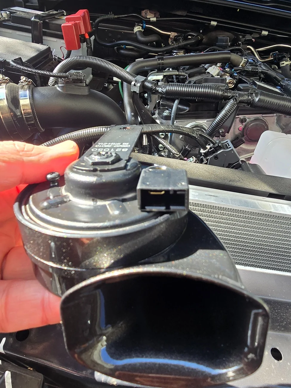

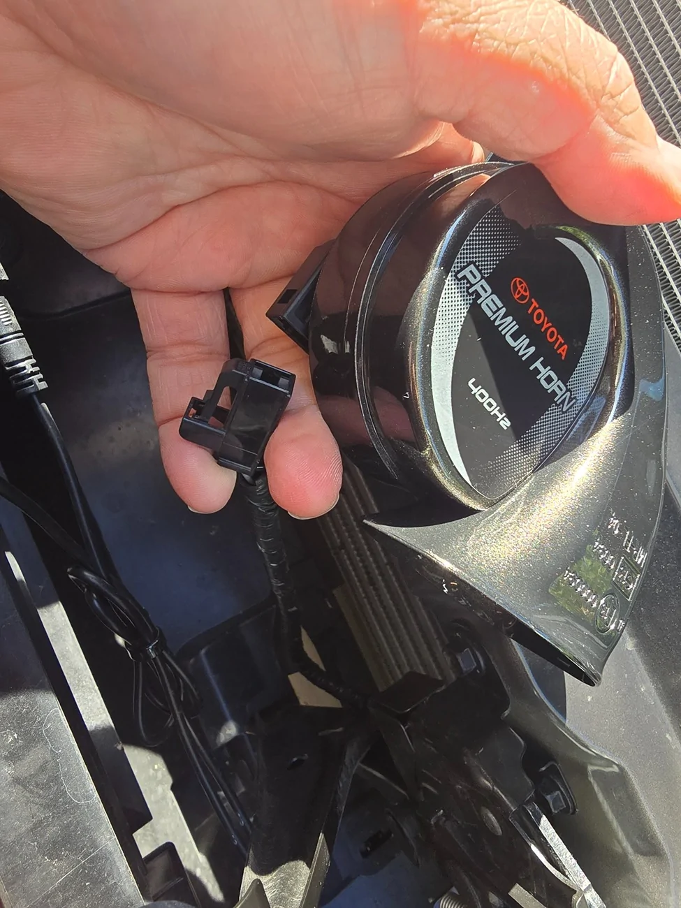

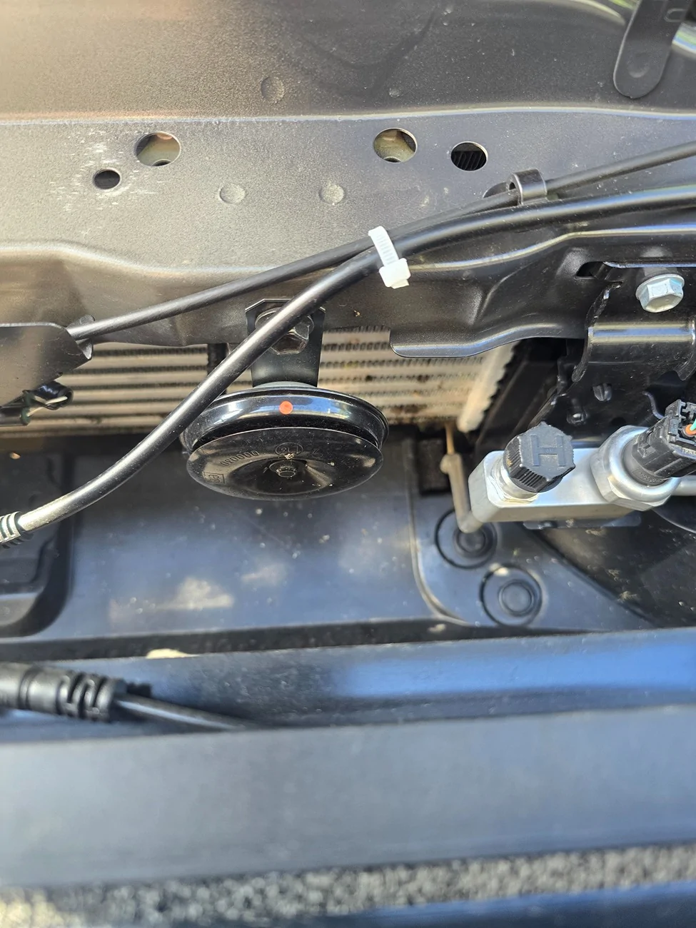

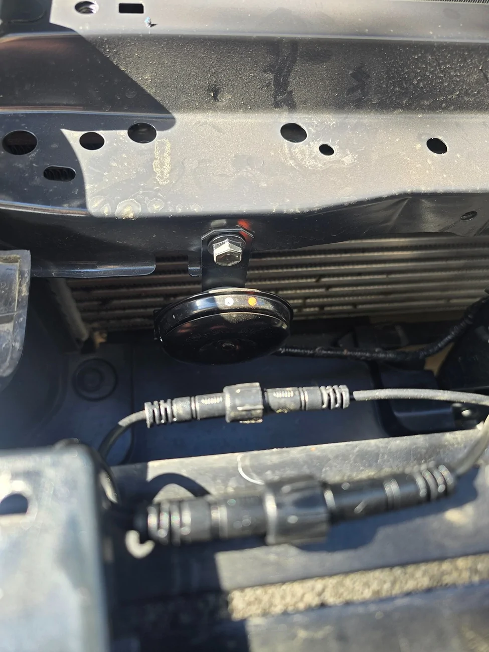

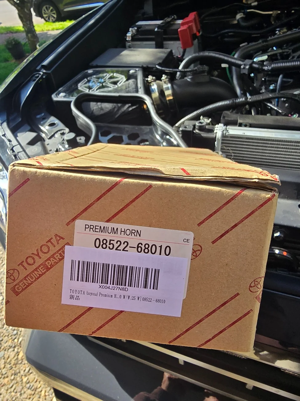

I installed these premium toyota horns. Purchased from Amazon (link below).
https://a.co/d/0bF7R0mc
These sound way better than the stock horn which sounded like something coming from a small car.
Install is pretty straight forward. Just unplug the stock ones, and plug in the new ones. Easy. 15min install.
I do plan on maybe getting something a bit louder (train horn), but we'll see in time.
