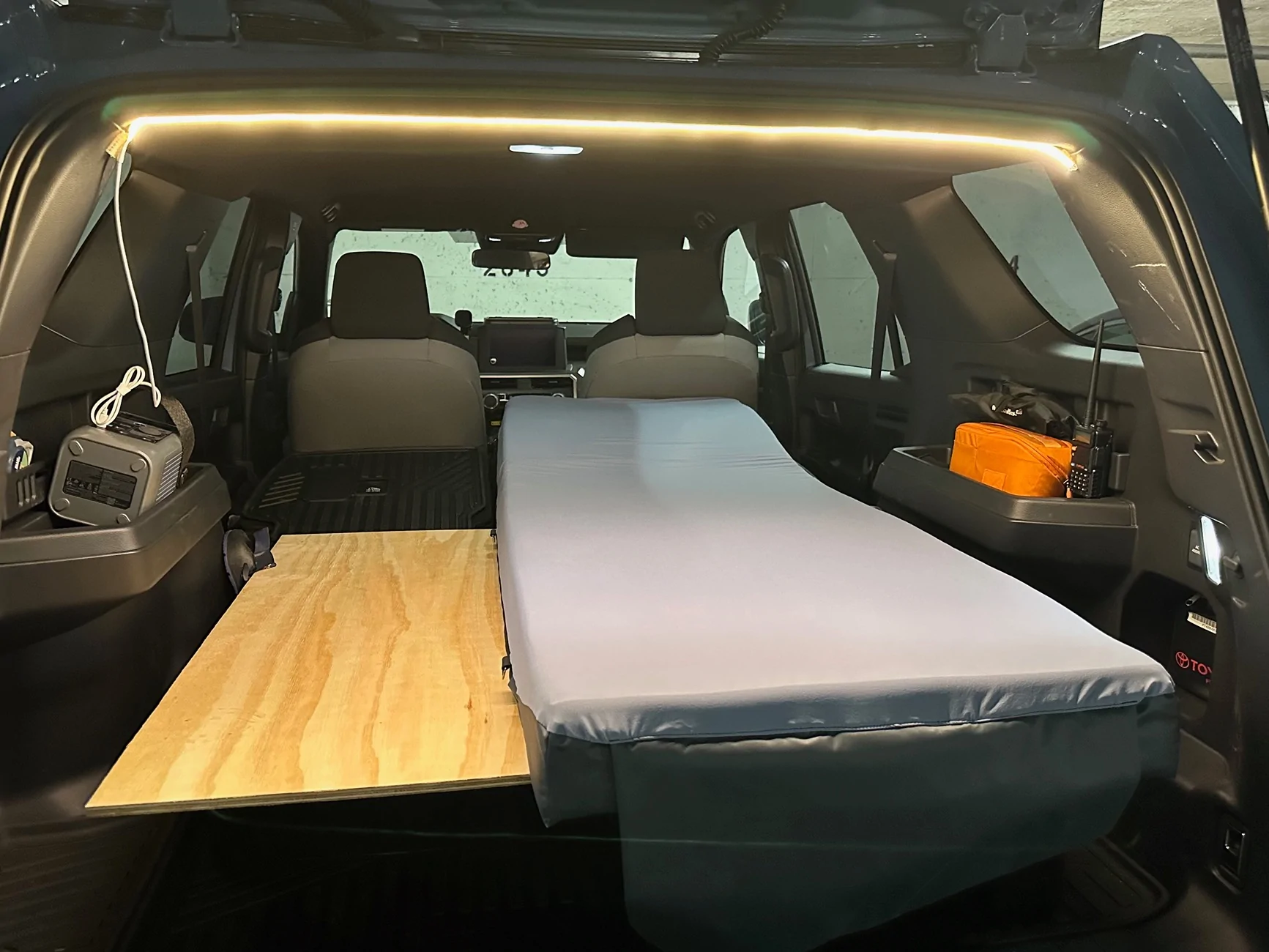

Mines just a 42"x42" piece of plywood on top of 2 front runner wolf pack pro boxes.
It's a bit too small though, might toss this one and get a 45"x43" and build some legs for it

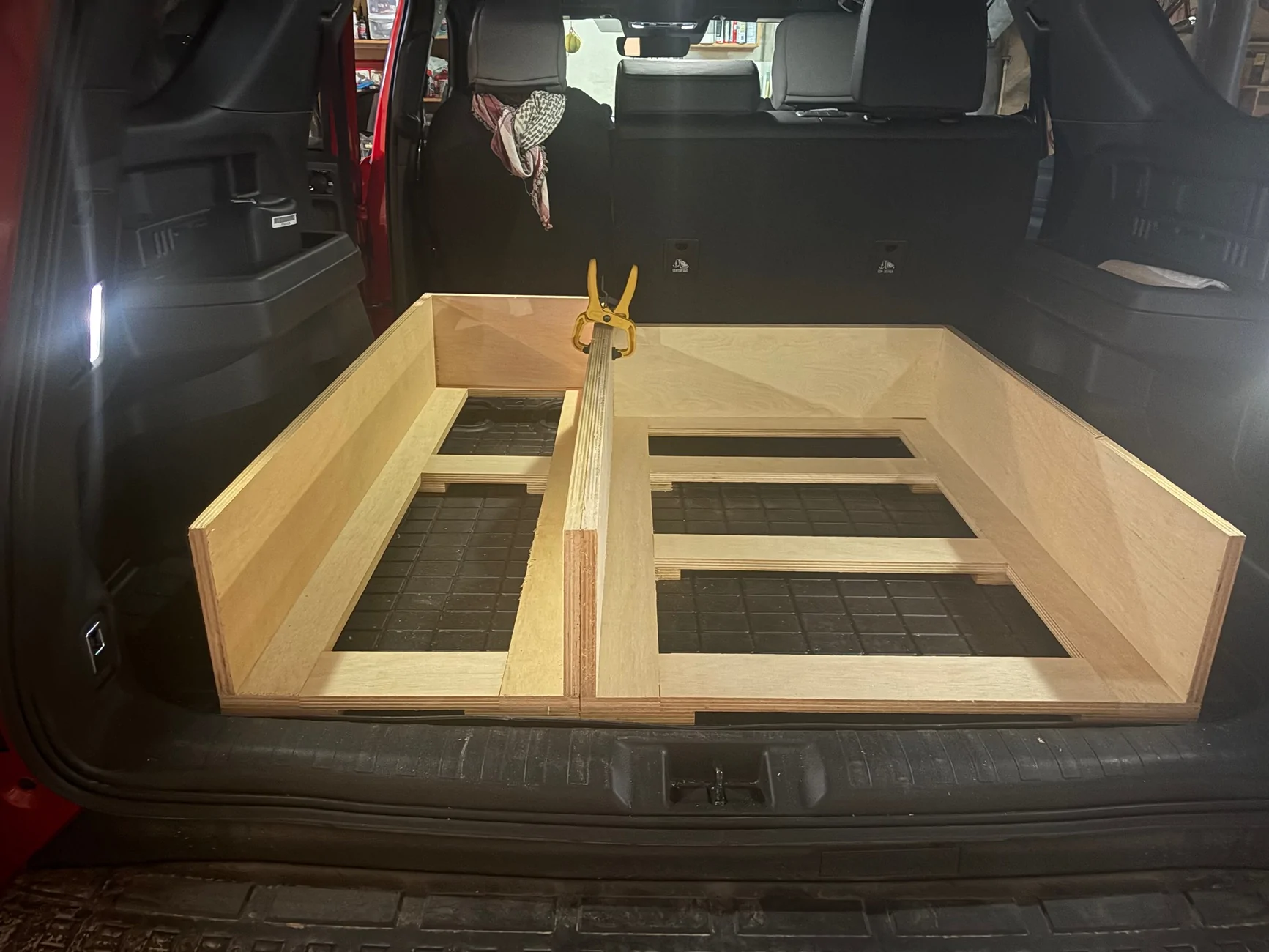

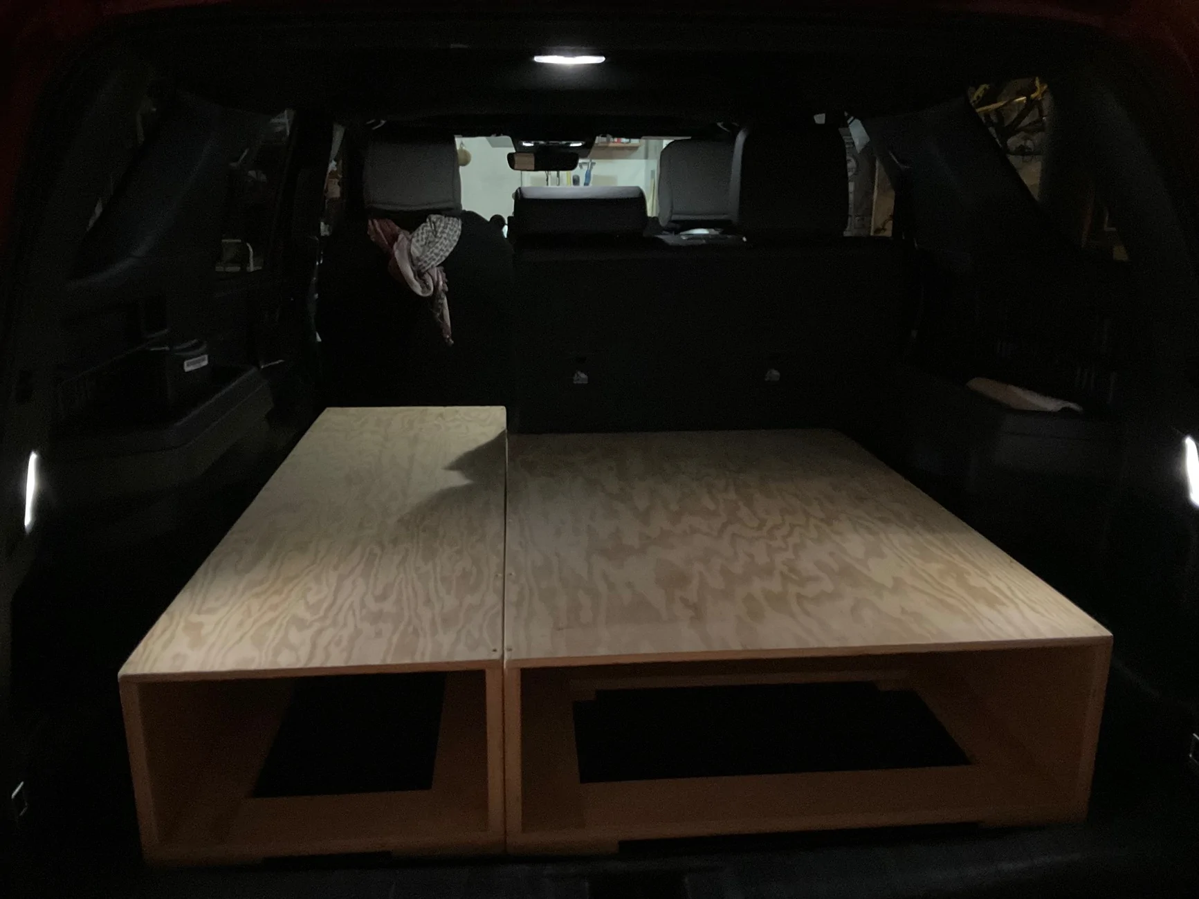

I’ve been working on this over the last week or two for my 2025 ORP. It’s a work in progress and yesterday I painted the boxes black and am letting them dry before re-installing in the back. I built a drawer/sleeping platform for my old 3rd Gen DCLB Tacoma (with canopy) and I miss the organization and storage.
The driver side rear seat has been removed and in its place is a platform to hold a cooler or day bags for easy access and is attached to a 4’ long enclosed box which will eventually have a drawer to hold long items like hand tools, hiking poles, my tool kit, jumper cables, small compressor, etc. The box behind the passenger side rear seat is wider but shorter (roughly 40” long x 27” wide). That too will have a drawer installed and will hold other items (camp stove, pot, canned food, camp kitchen kit, paper towels, tarp, hammock, etc.).
The height of both boxes is around 10”, more or less level with the rear pax seat when folded down. I’m 5’10” and can stretch out in that space with the tailgate door closed. I have a little more head room if I move the front pax seat forward. I have an expedition weight Thermarest I’ve used for years to sleep on.
I mounted some anchor d-rings to the sides of the box to secure to the OEM cargo tie down points, and another one in the front to secure the box/platform to the mount that the driver side rear seat used to clips into.
I’ll post some more pictures when the paint is completely dried and I put the boxes back in the 4R.
