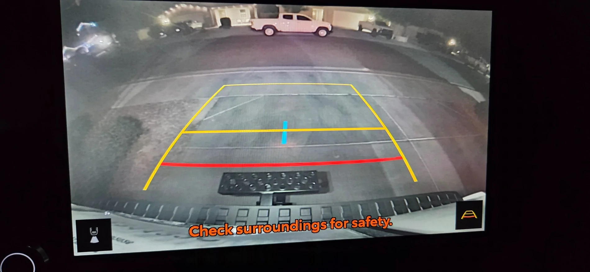

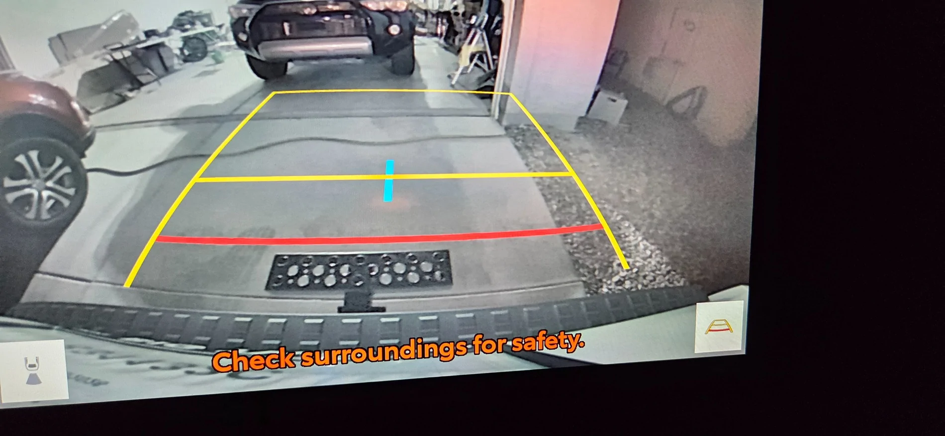

Eversince I got this 4Runner, I was never able to park it straight. I always reverse park.
Anyway, I tested reverse parking assist in my driveway paying attention to the guides... and sure enough if I based my parking on the guides, I always ended up a little diagonally parked.
I never had this problem with my 5th gen.
2025 2026 4runner 6th gen Parking Assist Guides Lines misaligned ? 20260419_203928
2025 2026 4runner 6th gen Parking Assist Guides Lines misaligned ? 20260419_202414
Does anyine have this issue?

I can see in the pictures you're not straight.... also that step might be throwing you off

Disregard the step. I am basing on the lines. Not just on the driveway but in every parking lot I go to.

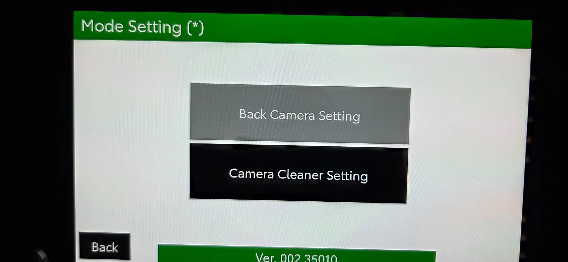

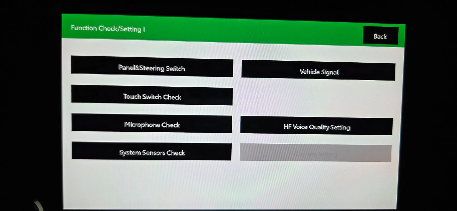

ignition on but engine off (2 presses on start switch)
access headunit, settings, display OFF
swipe screen left to right 5 times - ignore any message touch screen to turn on
swipe screen right to left 5 times - ignore any message touch screen to turn on
now you can access the hidden menus
the camera access may be greyed out, just press and HOLD, it will unlock
and now you can control and set several things rear cam related
BONUS: I just discovered: on SR5, by default, there is no ICON in the rearview
screen for rear cam washer...you need to activate cam washer via the rear wiper stalk
and push forward while in reverse, which does both rear window and rear cam if in
reverse.
so....digging into camera settings, I found how to enable the ICON. so now I can
be in reverse and hit the ICON at the bottom of screen and not need to use the stalk.
it's a minor thing yes, but annoying that other trims have this by default and
it is hidden on SR5's by default.

I tried so many times to access the hidden menu to no avail..

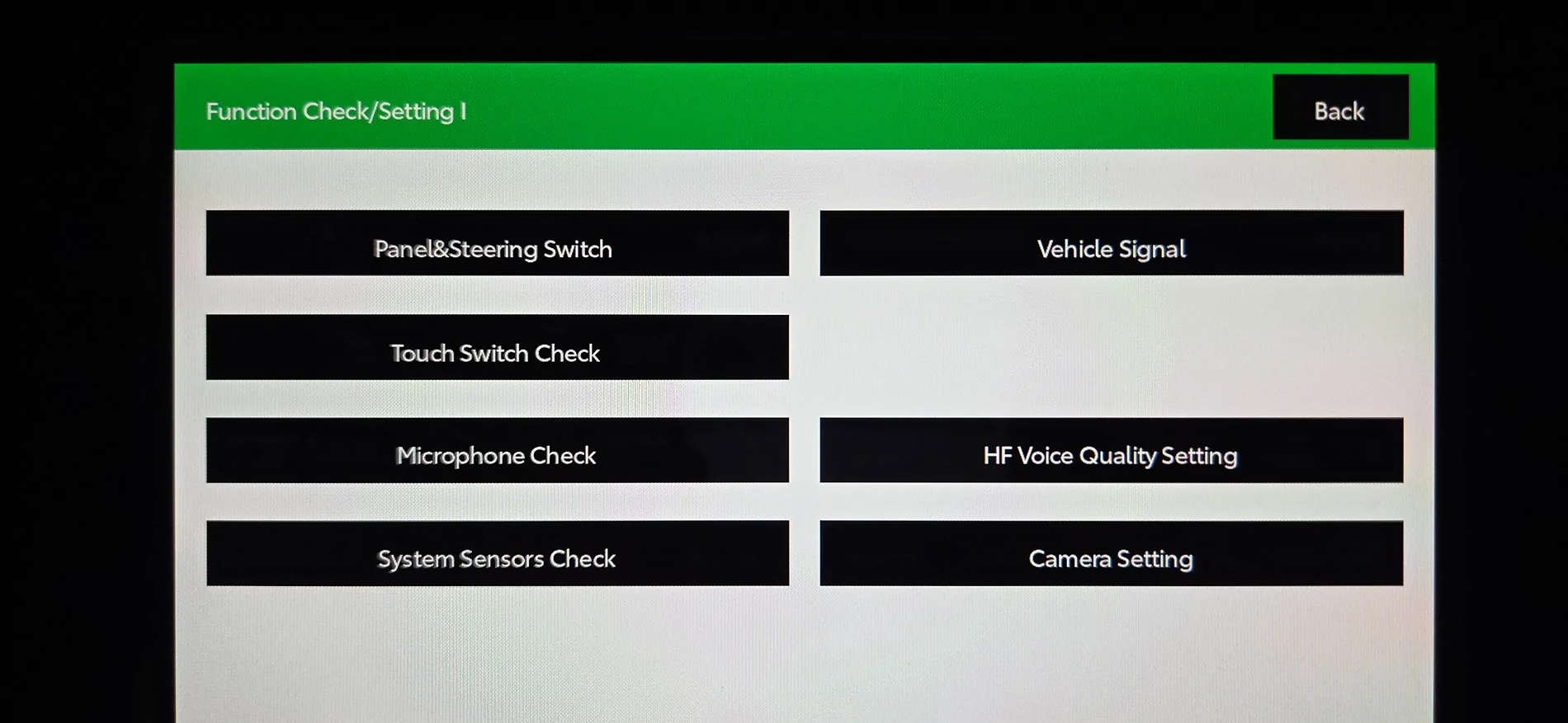

from https://www.4runner6g.com/forum/thr...n-recalibration-how-to-instructions-diy.7751/
Get in your truck and close all the doors and windows. From my testing, you cannot access the Service Menu if a door or window is open. Once you access the Service Menu, you then can open a door or window.
2. With your foot off the brake pedal, double click your stop/start button to access Accessory Mode
2. Wait until the infotainment (radio) screen boots up
3. Turn the volume all the way off
3. Go to Settings > Display > Screen > Turn off Display
4. Okay so here is the hardest part. You have to swipe left to right 5 times, and then right to left 5 times. Your screen may display "Touch to turn screen on" while you are swiping, but ignore the message.
4a. It may take 1 or 2 tries to get this to work. If you mess up, you just have to tap the screen to turn it back on, then turn it back off in the settings. Then continue with step #4 again.
5. If swiped correctly, you should see a Service Menu pop up.
6. Navigate to Function Check > Camera Settings > View Adjustment
