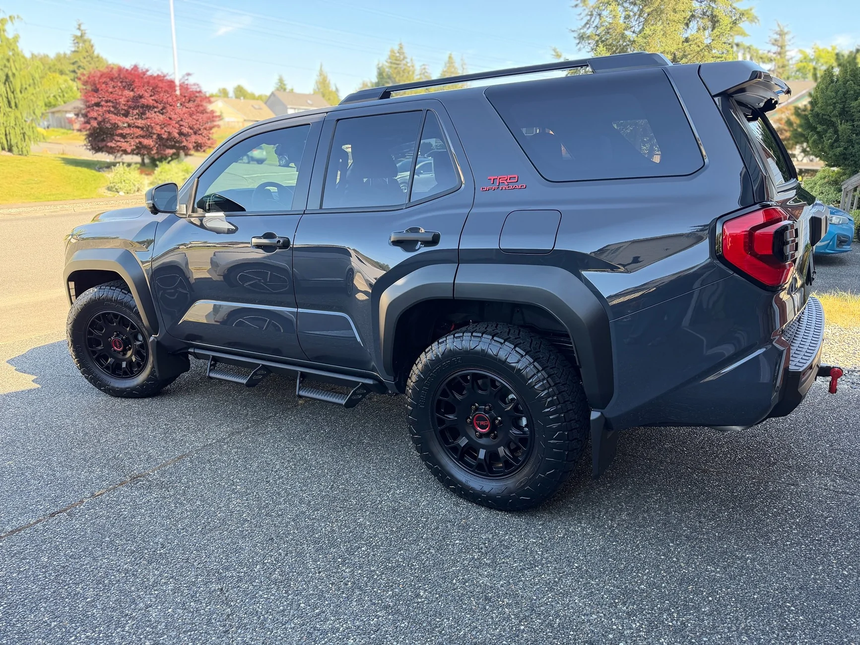

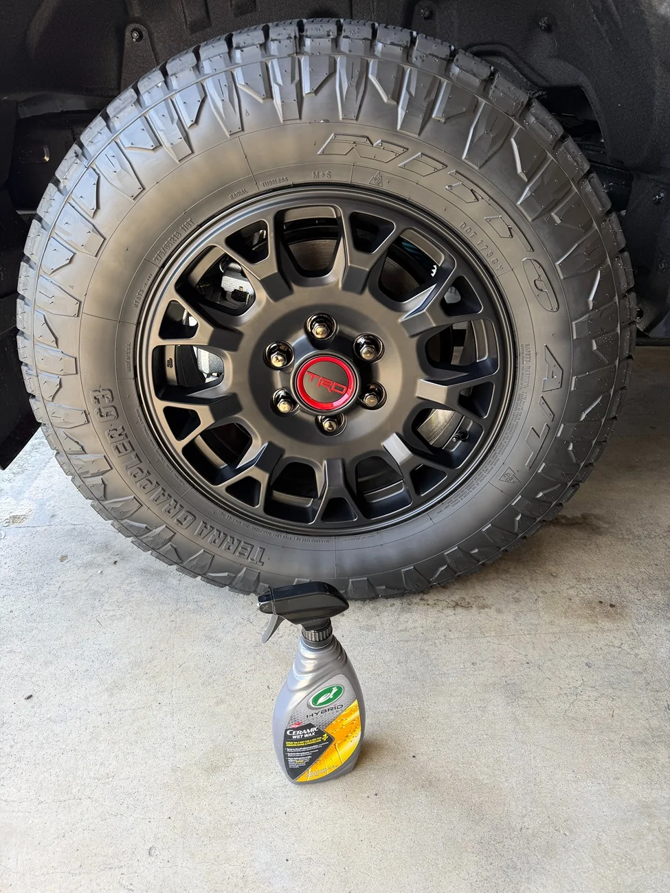

Go with the 275/65/18, gets you even closer to the stock size (height). I thought the Pro wheels stuck out too far for the flares and mud flaps so I went with the accessory wheel version. So close to stock size it's insignificant, with just a tiny bit more width. No rub or issues on mine.

A 275/70R18 tire (roughly a true 33.2") on 18" TRD Pro wheels at stock height will likely experience minor rubbing on the front mudflaps or liner during tight turns or compression off-road, but it is easily fixed by removing or modifying the front mudflaps.

Can’t speak of the trd pro wheels but mine is 285/70/17 +25 offset. No rub it’s close to the mud flaps though. Either way I’m getting ark ones soon. You might rub a tad bit. As far as tires go, there was another thread I posted in also, the tires I’ve had them for couple of wheels now. I like them a lot. I can’t hear any noise and ride comfort a little more rough than oem but nothing you won’t be able to live with. Mine is also SL load. I mainly wanted for wet/dry performance and as light as possible. Off-roading was secondary since I don’t do anything over the top.

Yep, I have 275/70R18 and I had rubbing until I trimmed the liner. (TRD Off-Road with TRD Pro wheels and Westcott level)
