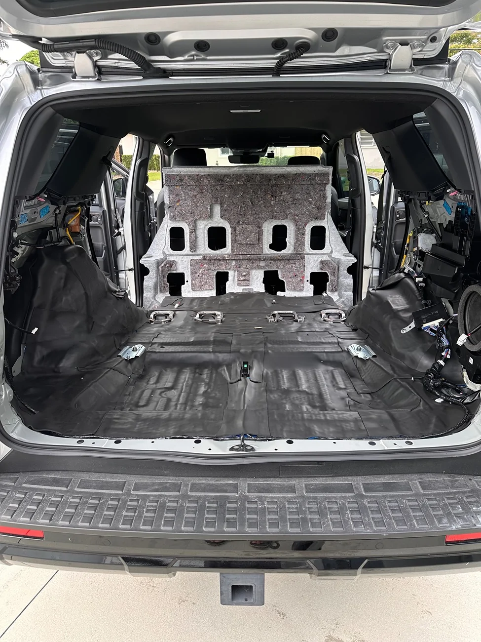

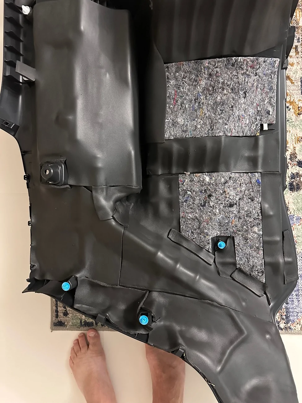

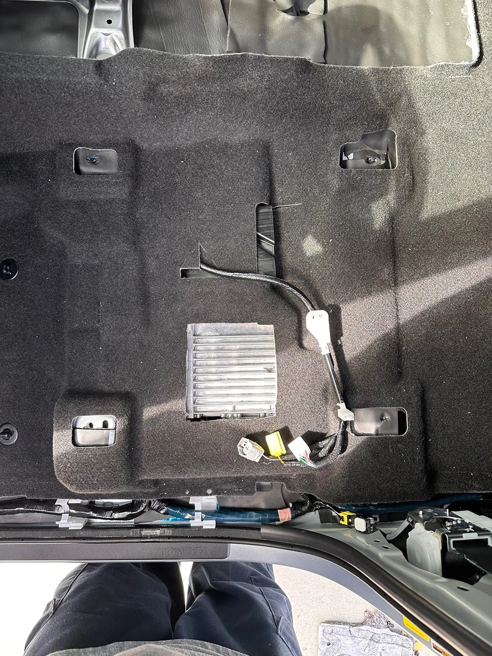

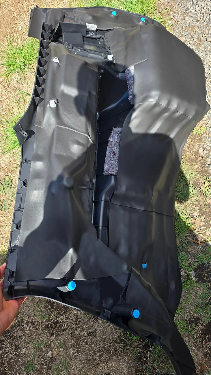

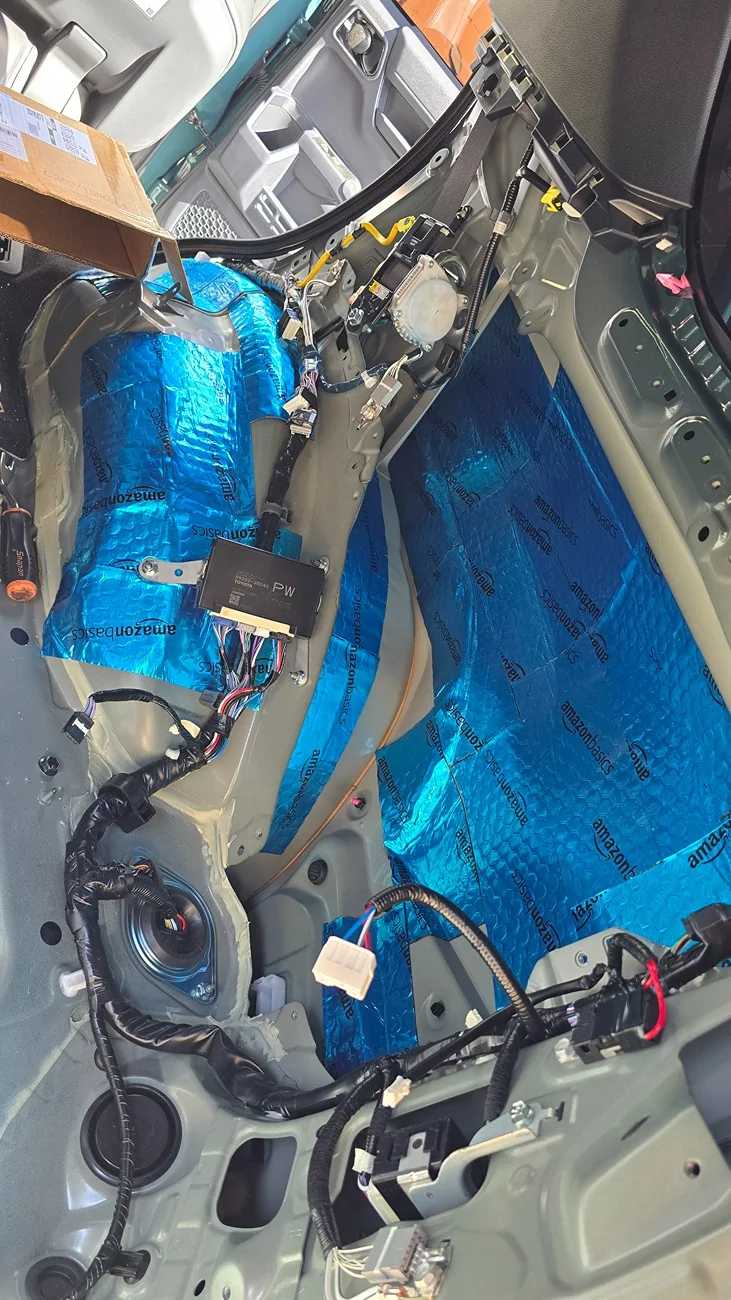

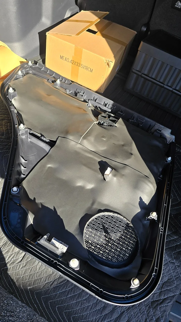

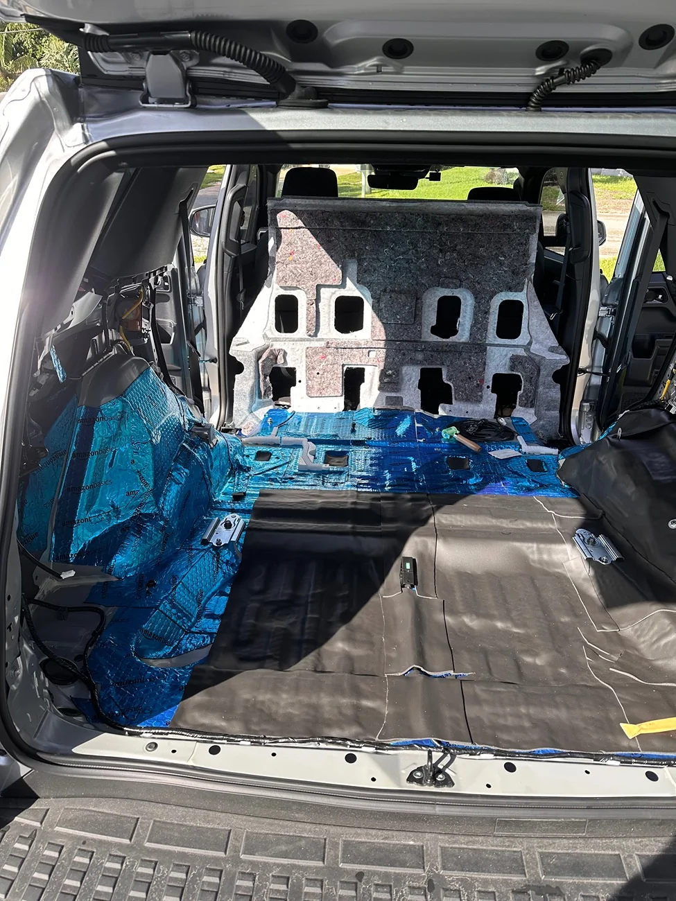

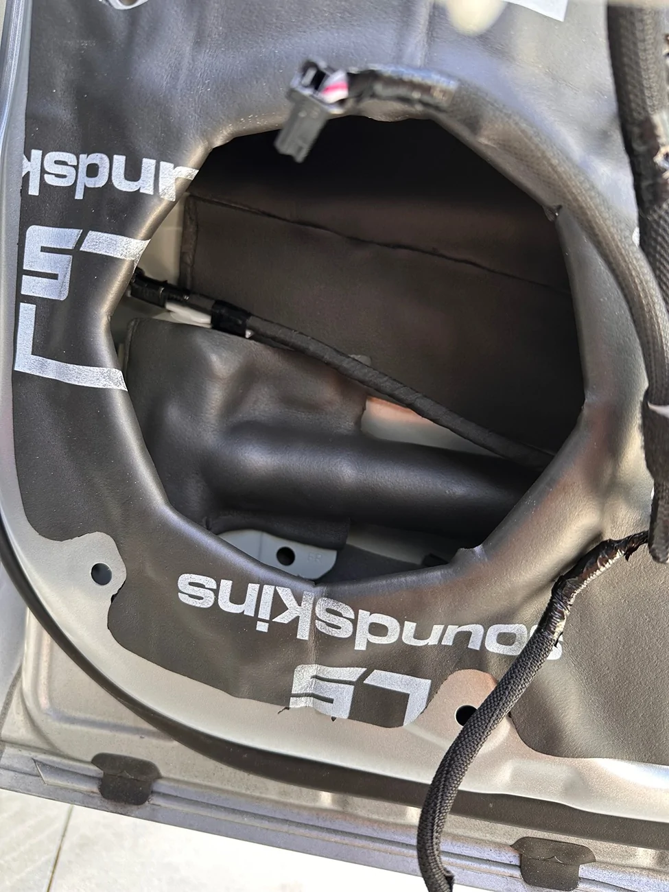

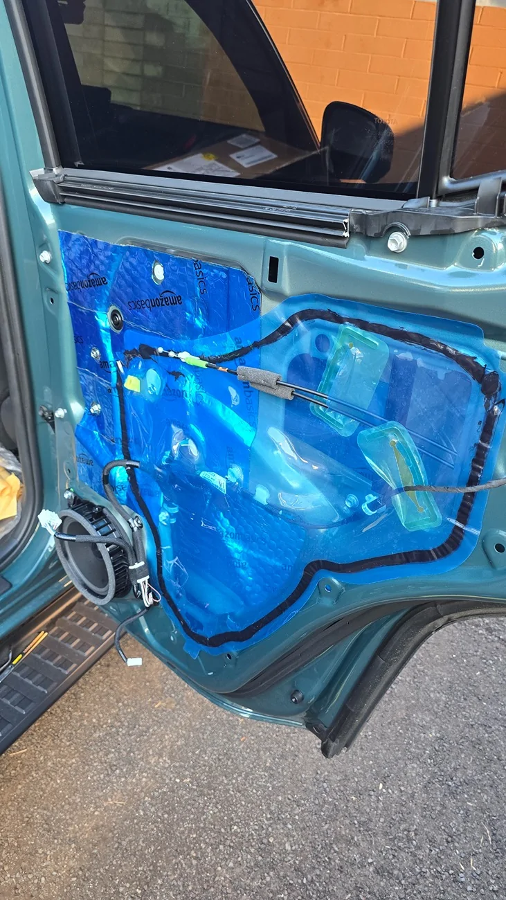

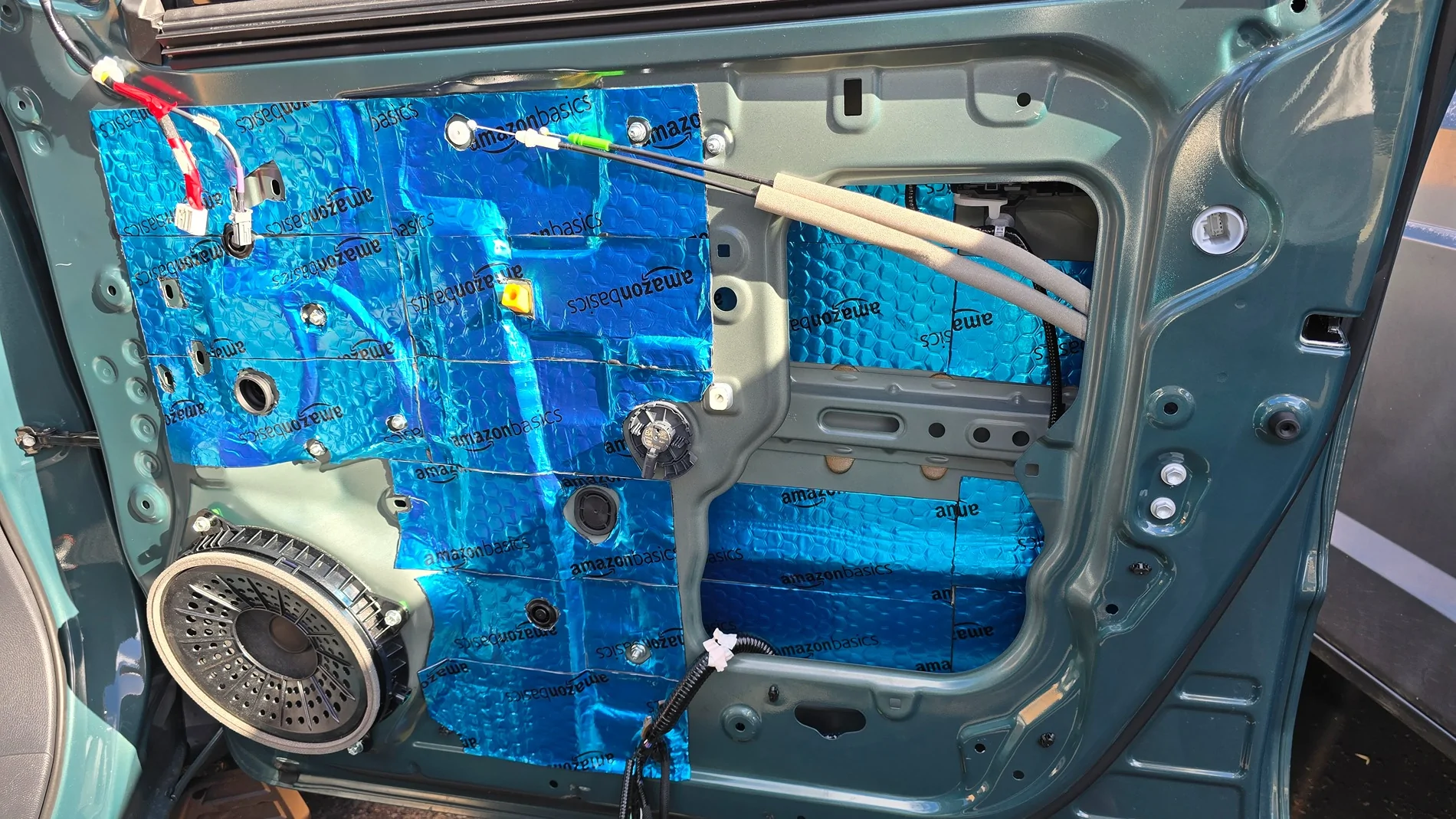

First I sound deadened the usual places in the vehicle with Amazon matting and closed cell foam sheets. Door sound insulators were retained just not pictured.

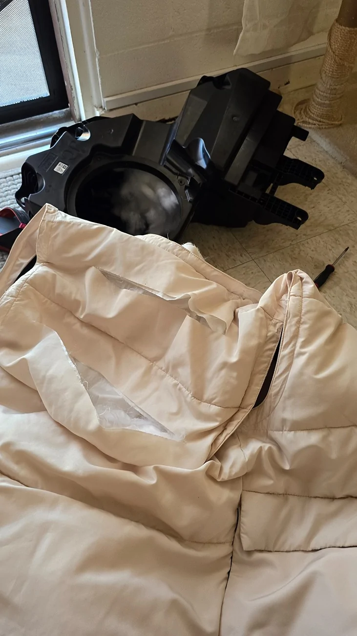

I also stuffed the subwoofer enclose with polyfill from an old jacket i never use.

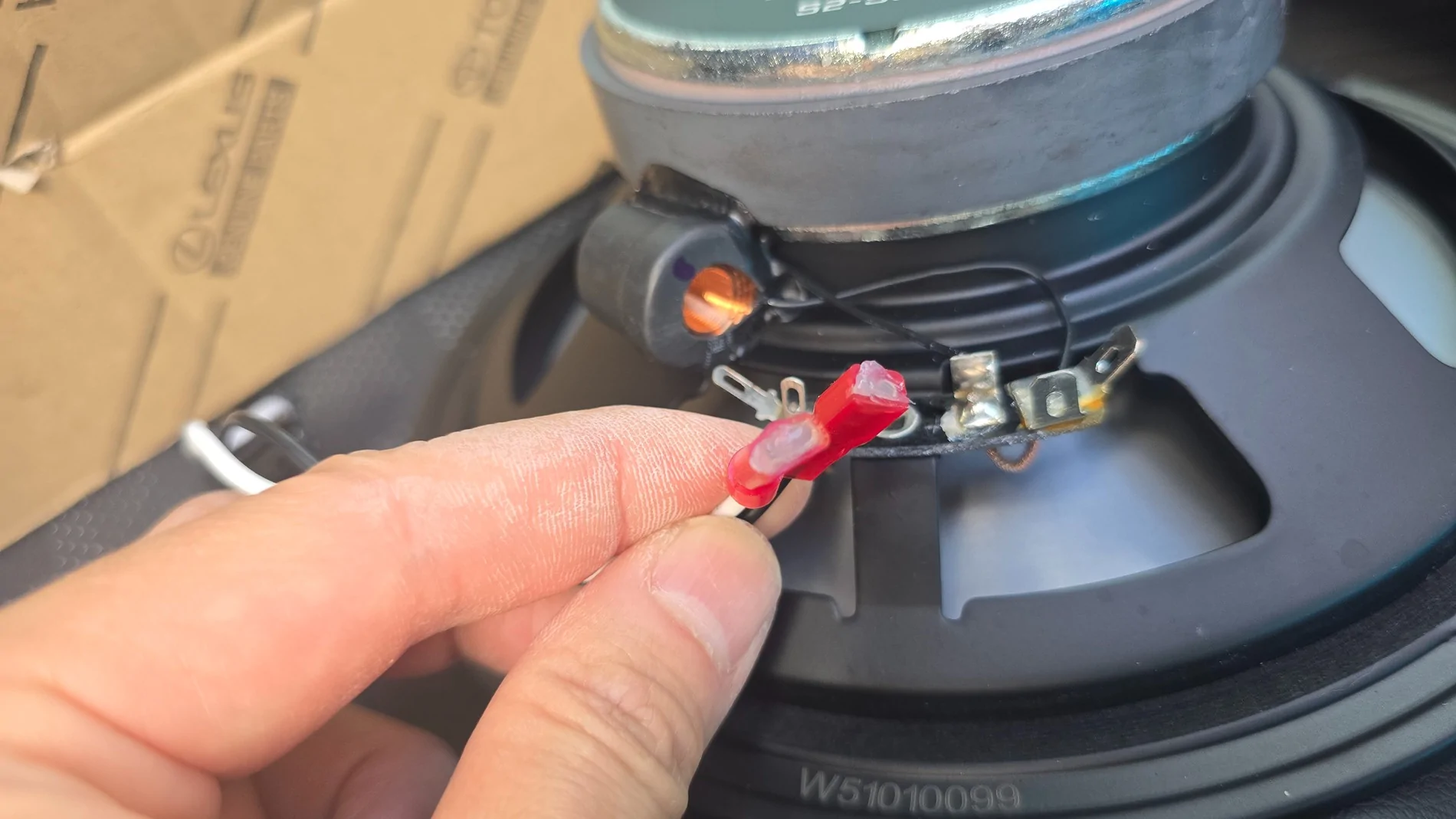

Then I tried to change the speakers with the set from trailgridpro.com
All I can say is that kit needs help and is not a direct plug and play.

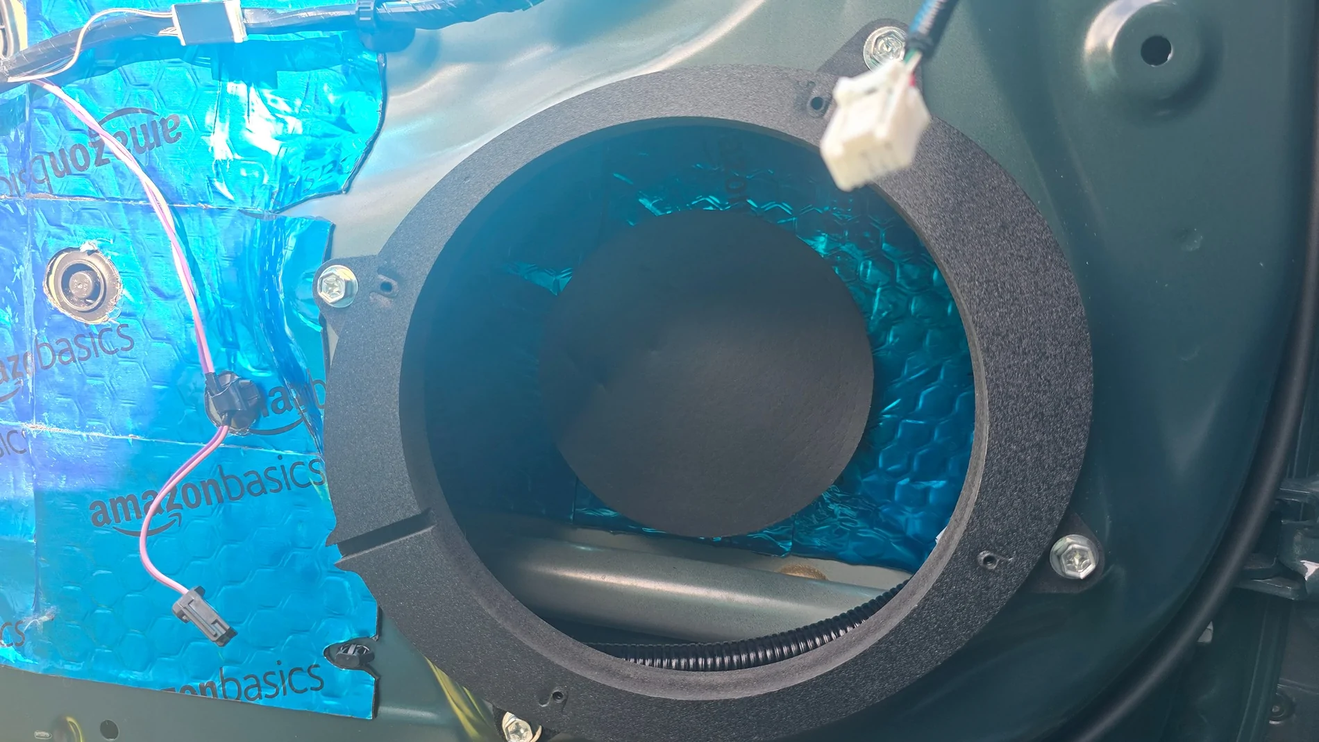

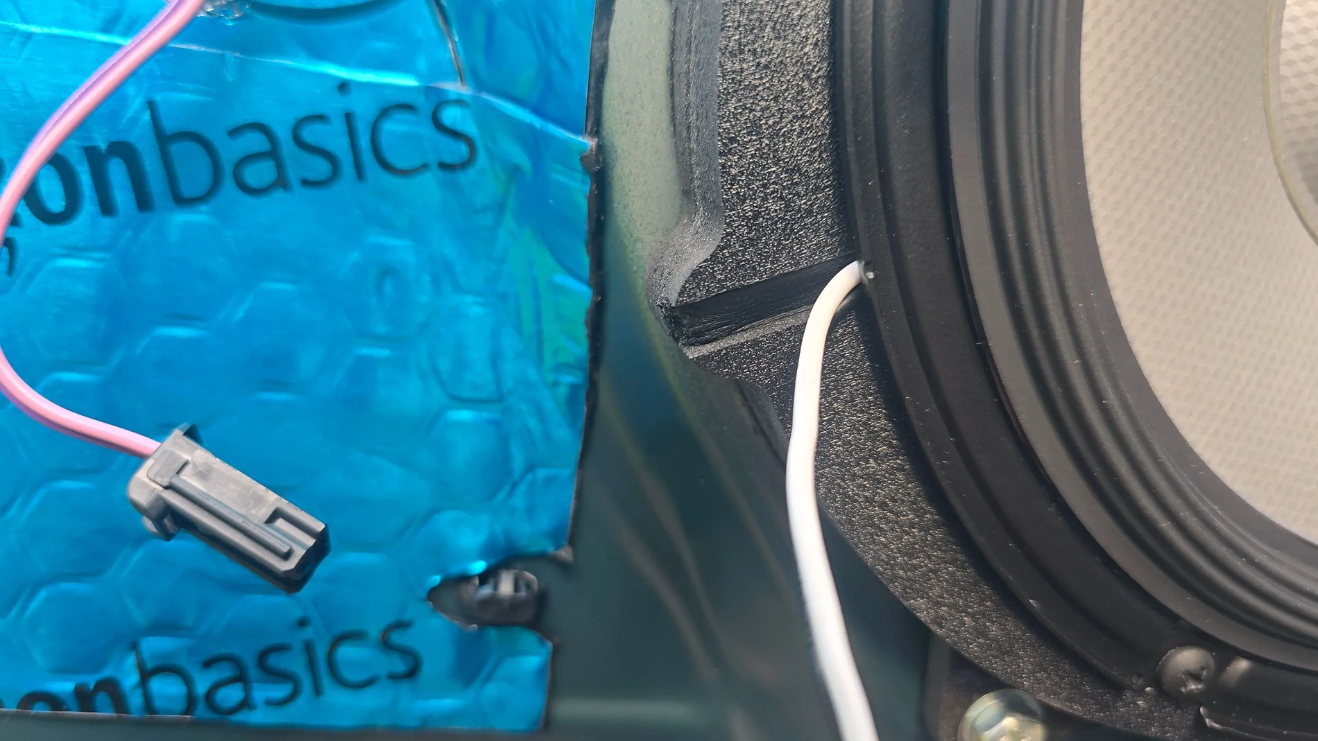

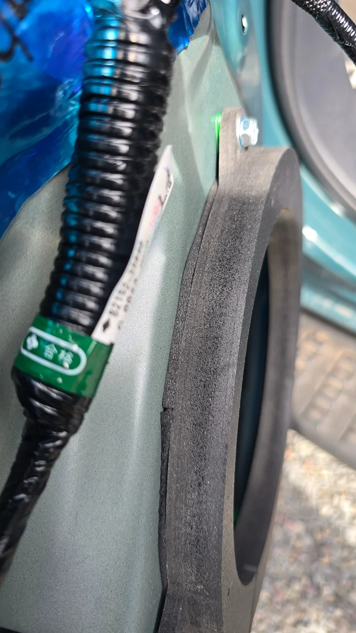

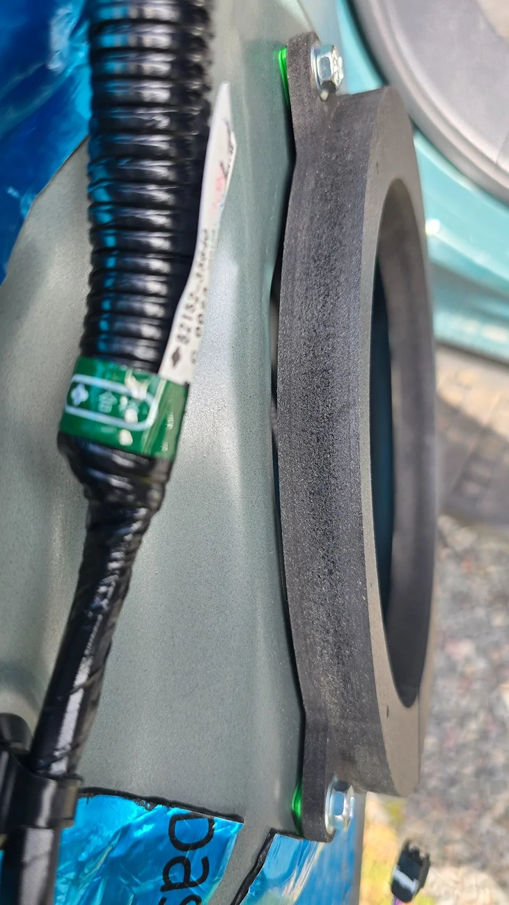

I had changed out the screws and nuts as someone else did for the dash speakers. The brackets for the door speakers were not lined with foam on the rear so after being bolted there was gap between the metal and brackets. I lined the bracket with some closed cell foam strips to seal. Also lined the cutout for the speaker wire to seal also. Also the harness adapter needed to be isolated with foam to stop vibration. Another thing is that dielectric grease needs to be used cause the speaker terminals will be exposed to water. Closed cell foam rings were added to seal against the door panel.

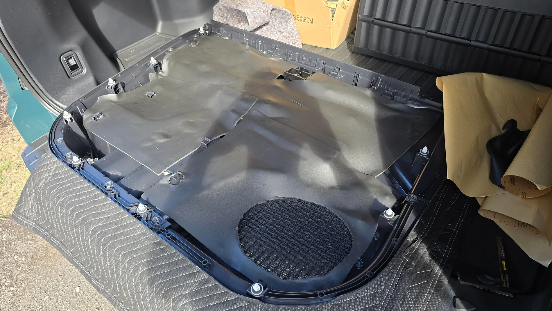

After the install the system did not sound right as it sounded harsh on the high-end and missing alot of midrange. It is due to the fact that the alpine dash and hatch speakers does not produce the correct range of frequencies at the right level. I believe its cause the speakers is smaller than the factory. So I replaced the dash and rear hatch speakers back to factory and it was much better.

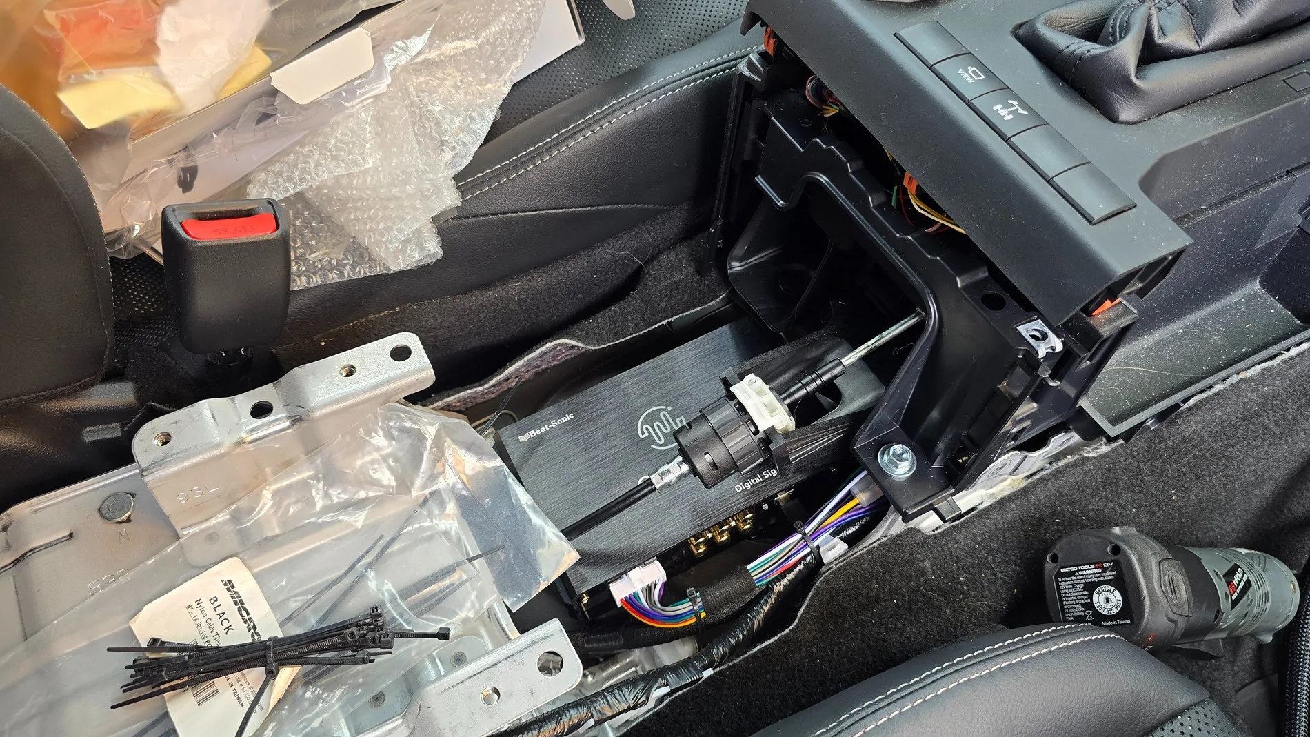

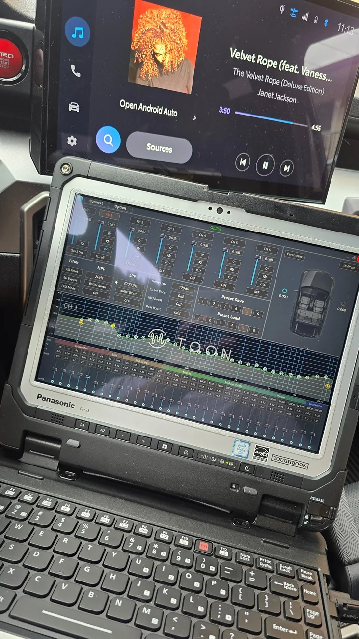

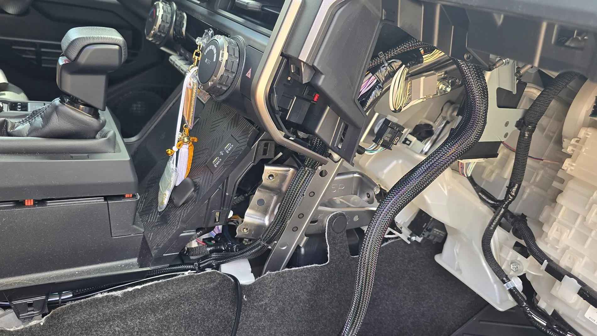

How the audio system works is that the signal from the audio unit is sent to the JBL amp from only the front. The JBL amp then sends the signals where it needs to go. So the Beatsonic DSP will only work with ch1 and ch2. You would need to zero out the time alignment as its done through the JBL amp. You only use this to make the eq curve better. You can not boost it too much or the signal will distort. You should always cut. I installed the DSP under the center console and routed the harness to the audio unit. I routed the USB cable to the passenger side and can easily hide or access it from the under panel on the drivers side.
Tuning is subjective and I used pink noise to get a base line and adjust by ear after. The settings on the audio unit i have it centered for the low mid and high. The fader I have it set to 1 click back for better surround. Don't waste your money on the beatsonic alpha and guess and pray for it to sound decent. One might be able to just get the DSP and tune for a decent output. The stock speakers are decent but not the greatest. If anyone does go this route let me know how it is compared to without the DSP.
