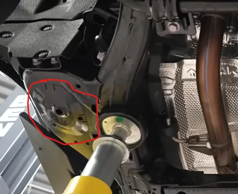

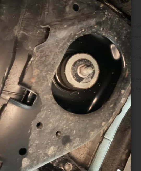

Hi group, am I missing some covers on the underside? My 2026 Limited has an open hole in the frame, and videos I've found on line seem to have a cover over this. area. Appreciate it if others can let me know if they do or do not have these!

earf
a bunch of Toyotas
all Toyota vehicles that ship using tie-down points, arrive with a plastic bag in the glove box
[or other area], and inside the bag are PDI plugs. to cover up the holes
example: some rav4 come with 2 plugs, but if the rav4 originated in Japan, it comes with 4 plugs
So if you are missing plugs the dealer forgot to do proper PDI and install the plugs. Go back to dealer and request the a PDI delivery sheet for a 4runner and see if the plugs are mentioned, there will be a diagram showing where they get installed.

It's installed on mine

Thanks everyone I appreciate the feedback. I will visit the dealership on Monday and ask for the PDI checksheet.
