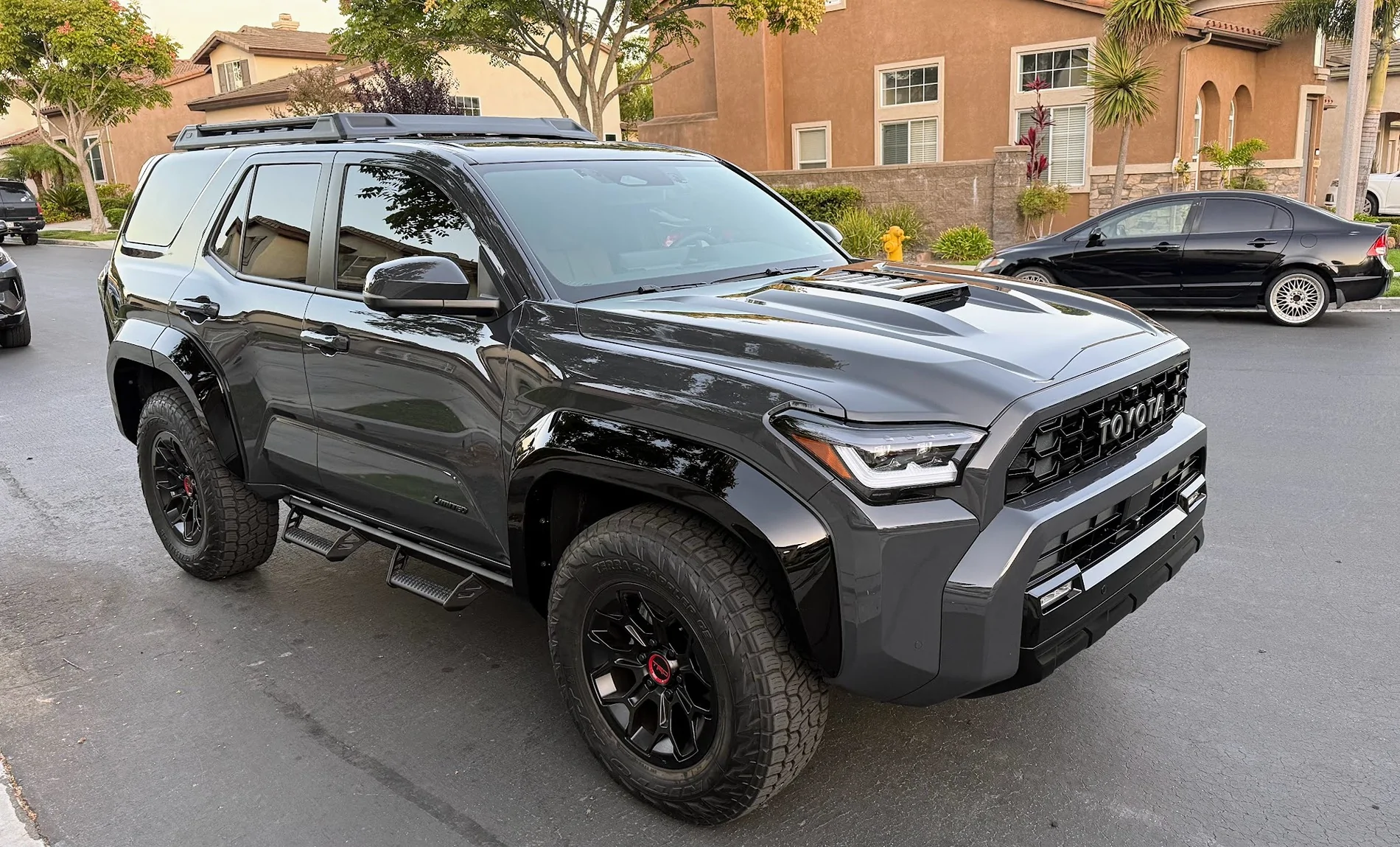

I swapped out my 20" rims and tires on my Limited and it made a big difference in the ride. I didn't like the stock ride, way too harsh.
I swapped to 18" TRD Pro rims / Nitto Terra Grappler G3 in 275/70/18 @ 33 PSI.
Ride is way softer than stock, no increase in road noise. I really like the Nittos.
I probably should have gone with 285/70/18 but I was scared my MPG would be even worse. I'm getting 17 MPG now.
However, it you go ABOVE 275 all the AT tires are either E or LT. Which are awesome for serious off roading but not as smooth on the payment for a dangerous trip to the mall or Costco :)
No rubbing on this setup.

Those tires you got look bad ass !!!
