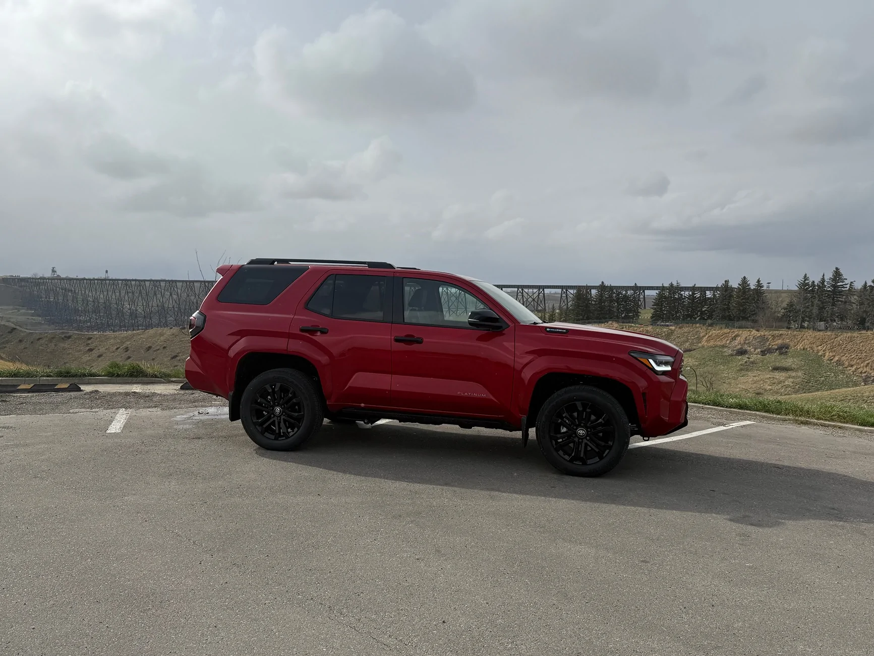

I’ve got a 2026 Platinum. I want to upgrade the wheels and tires, eventually I will put a lift on it but for the time being to avoid warranty issues I want to keep the suspension stock.
What’s the biggest tire people are fitting on the Platinum’s without a lift? Preferably without trimming.
I am leaning towards 17” or 18” rims and Toyo Open Country AT3’s.

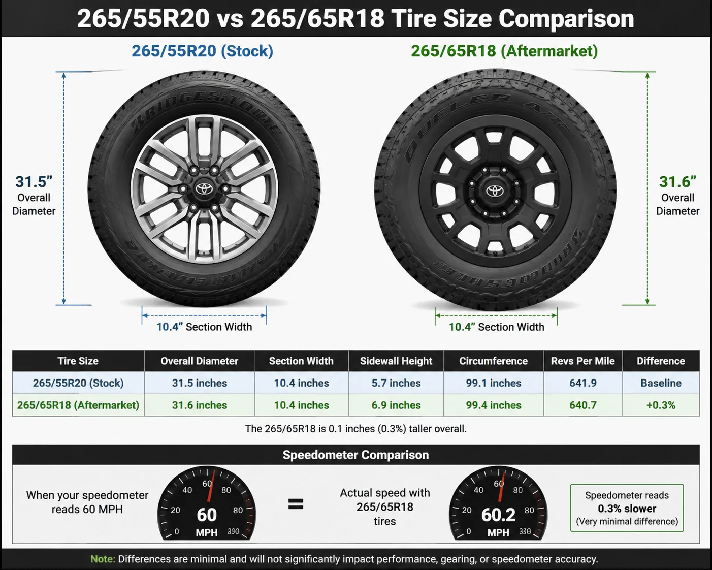

285/70r17 is an option lots of people on here have done stock height. I have a level with mine but never rubbed.

Tire sizes do not matter, you need to verify the physical mfr for each make/model. For example 35" BFG KO2 are 33.5", etc. Do your homework , tiresize.com.
