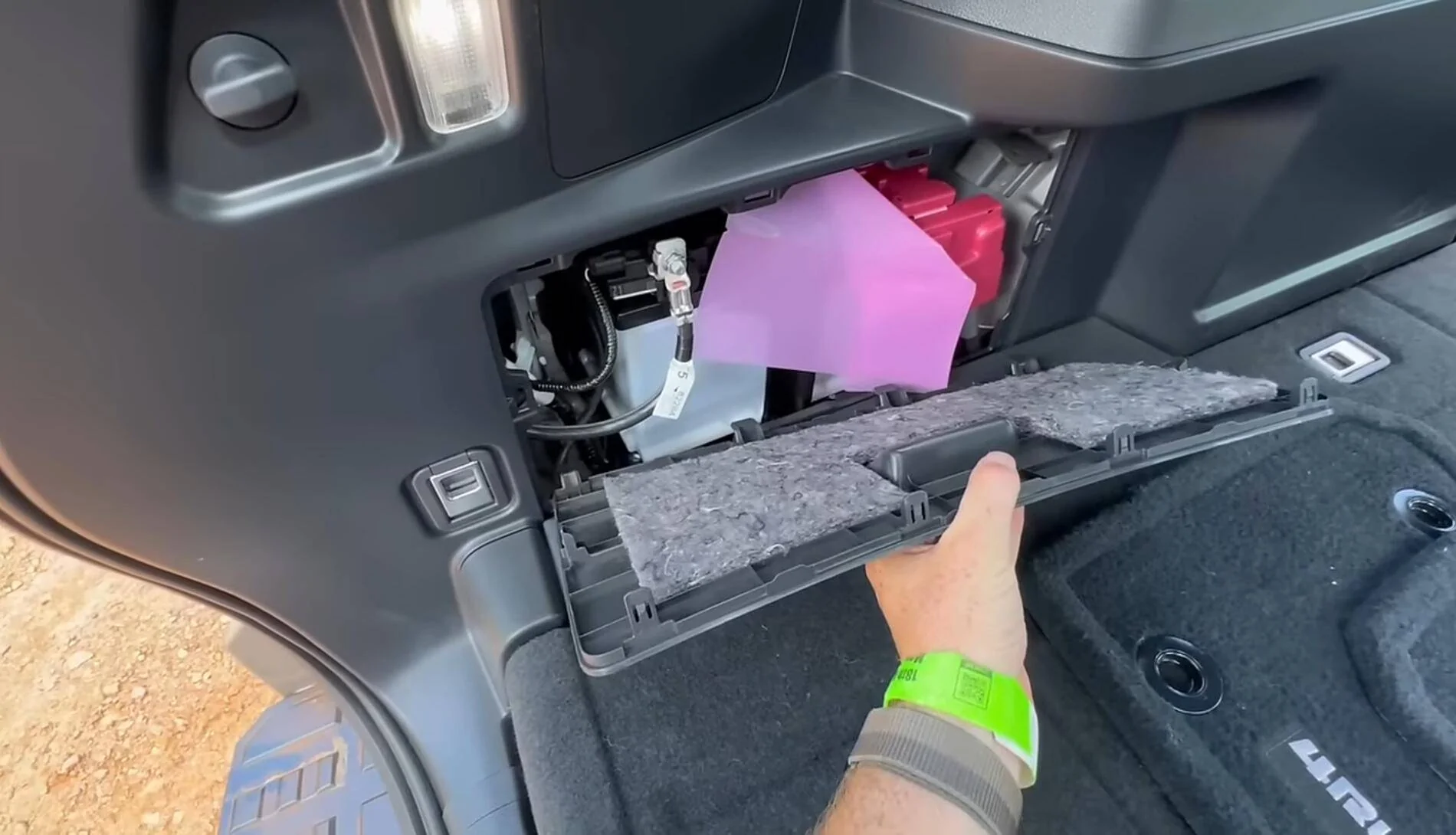

There is a regular battery in the cargo area so it should be the same process as before just out of the cargo area.
2025 4runner 6th gen Jump starting from a Hybrid 1746716255706-r8
