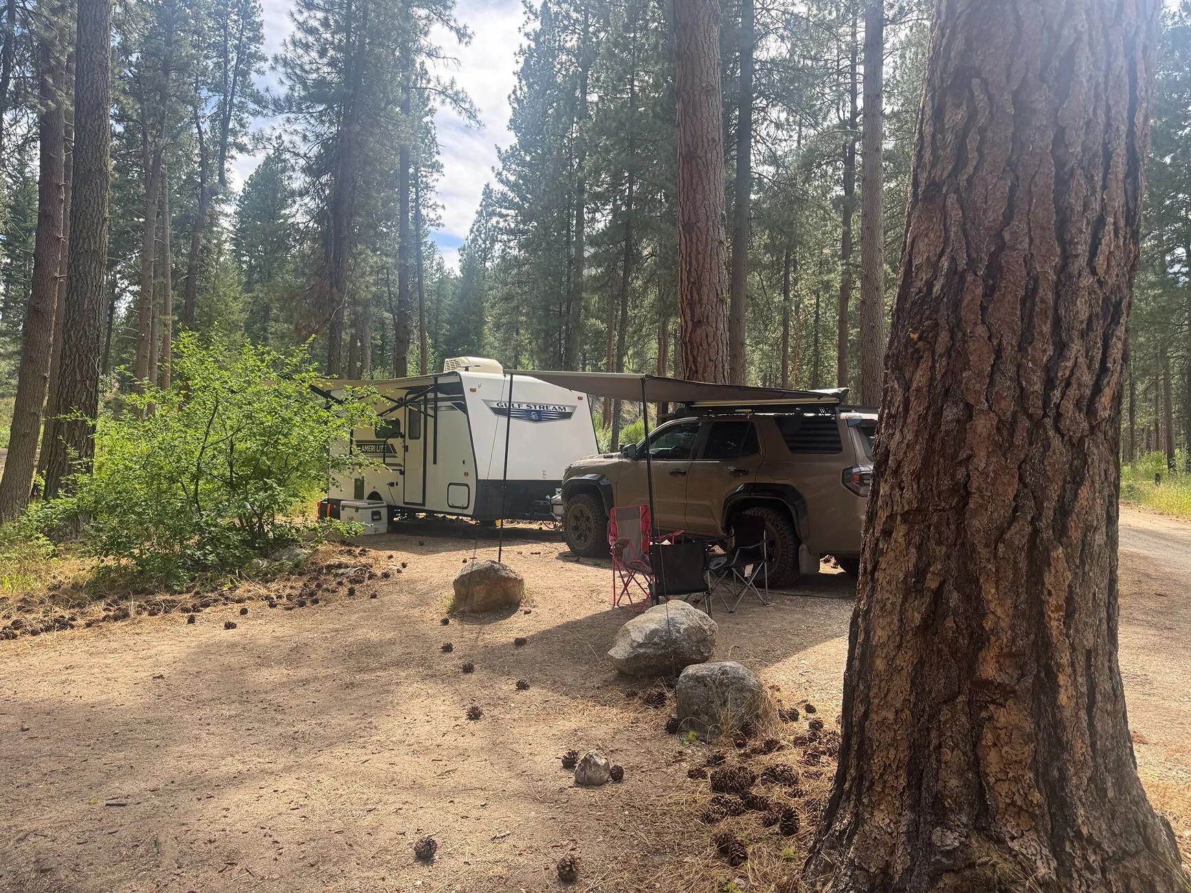

It wasn't long, 2 1/2 hours, but it was up into Idaho mountains. I rented a 2023 Gulf Stream 20' , 2810 pound trailer to go camping in for a wedding. The TrdPro had no problems pulling the load. Only thing I would change would be that if I was to do it more often I would get stabilizer bars. I had some trailer sway above 65 MPH.

was that empty weight rating or gvwr ? that seems light at 2810 lbs for what looks like a fairly large camper. the dry weight is usually between 3100-4300 depending on options.
the gvwr probably was closer to 5000 or 5500 or 6000, which then i can understand the swaying
right now i am looking at a escape 17 with around gvwr around 4500, looked at a 19 but the gvwr is pushing to close to 6000 for my comfort

The owner that listed the trailer claimed that as the Gross weight. But wouldn't surprise me if it was heavier. It was a single axle though, 20' if that helps any.\

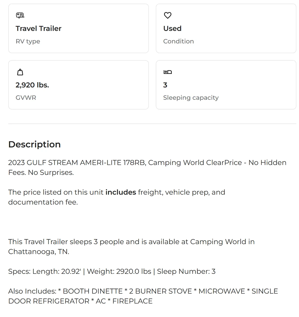

i think i found your specs for the one you rented, that sloped front end is easy to distinguish from the 20RBS series.
i thought you had a 20 series not a 17 series
2023 Gulf Stream AMERI-LITE 178RB

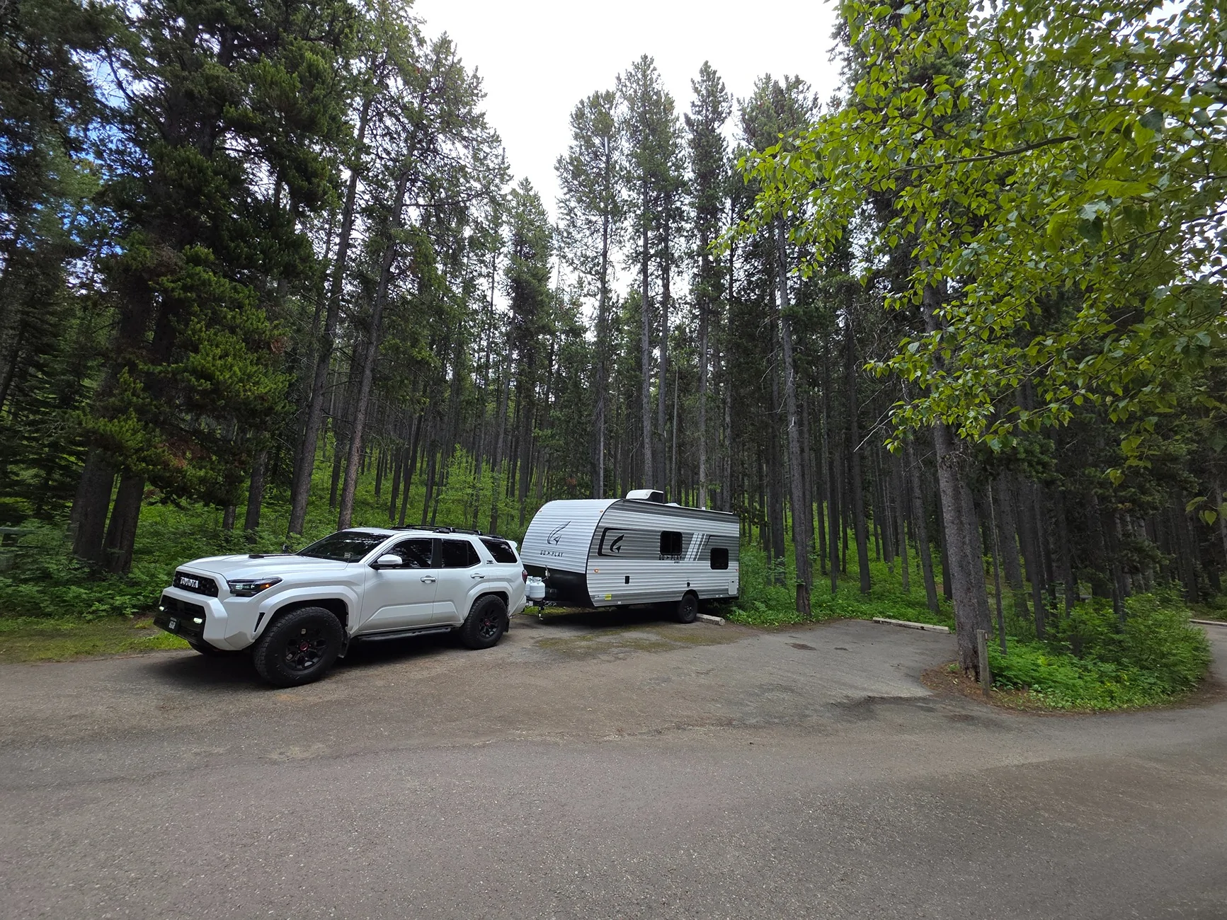

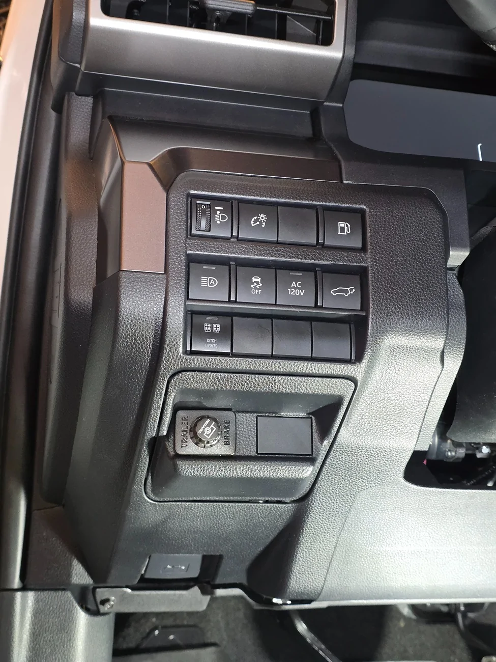

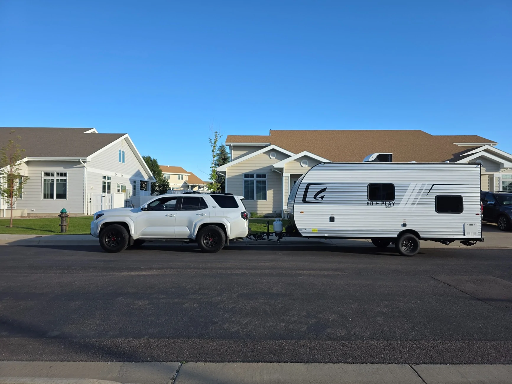

Does your model comes with trailer brake? If not, I'd suggest install this REDARC Tow-Pro model: https://amzn.to/4pljqjb. Don't get the crappy bluetooth model from CURT.
Our 6th gen has trailer brake connector to use with this. Easily 20 mins or less project.
I towed 3k lbs, 21 ft long camper with no issue. Make sure the trailer is balance & level. Your MPG will crap the bed. I was averaging 9-10 MPG in the mountain pass.

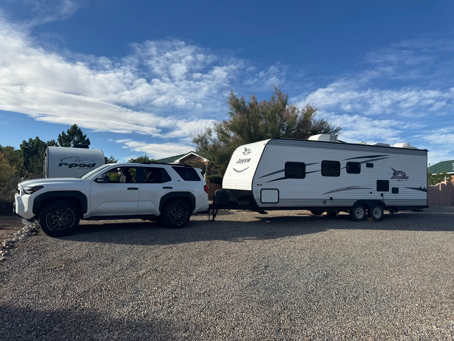

I towed our 29’ rv trailer about 300 miles for our last trip. I have the redarc tow-pro liberty installed and an anti-sway load-leveling hitch. I was only able to tow at about 60 mph for the trip due to wind and slowed down for hills. Overall did great, averaged around 10mpg. Total load was ~5500. I have the SR5 so more towing capacity and running bfg tires. Go slow, don’t push it!
