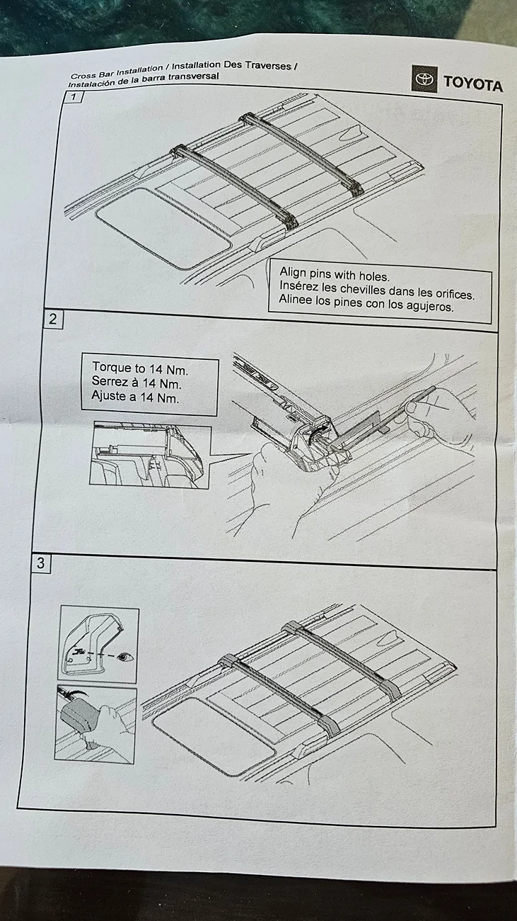

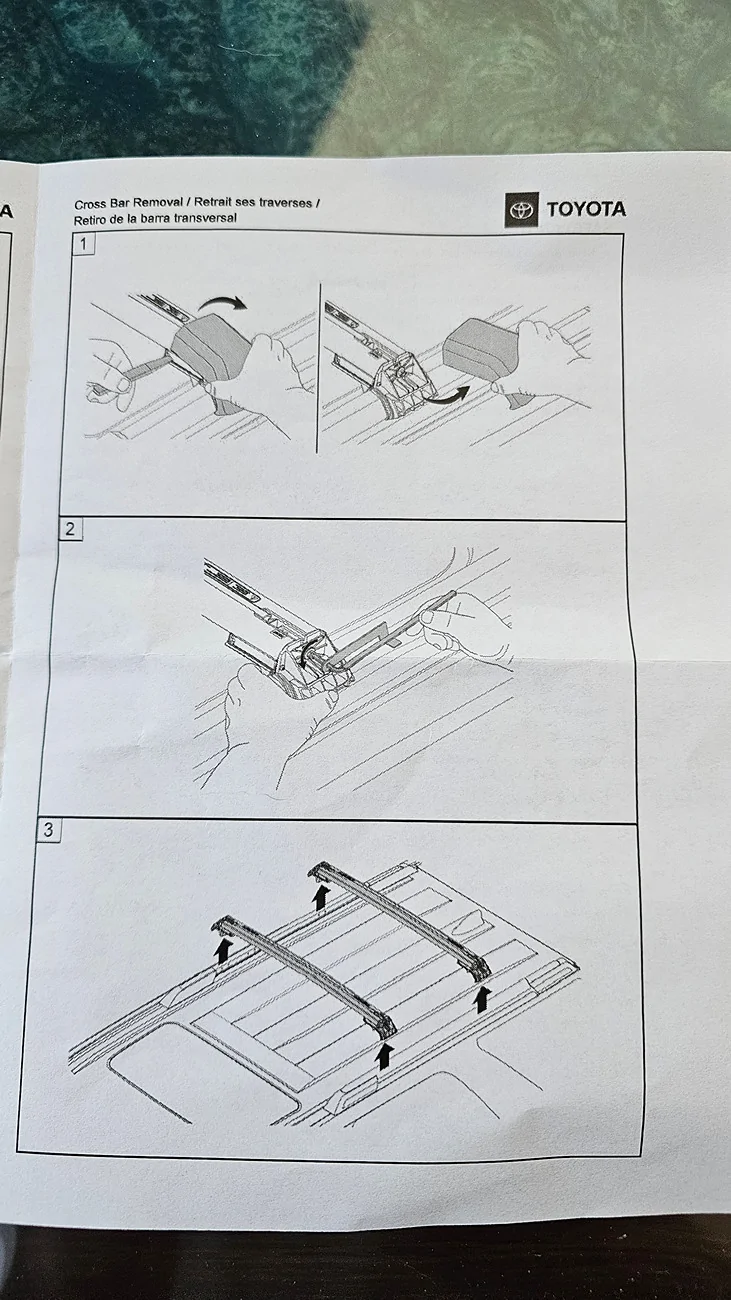

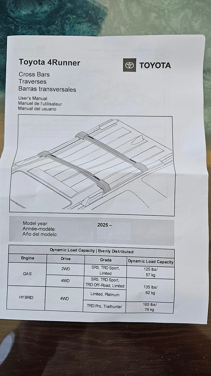

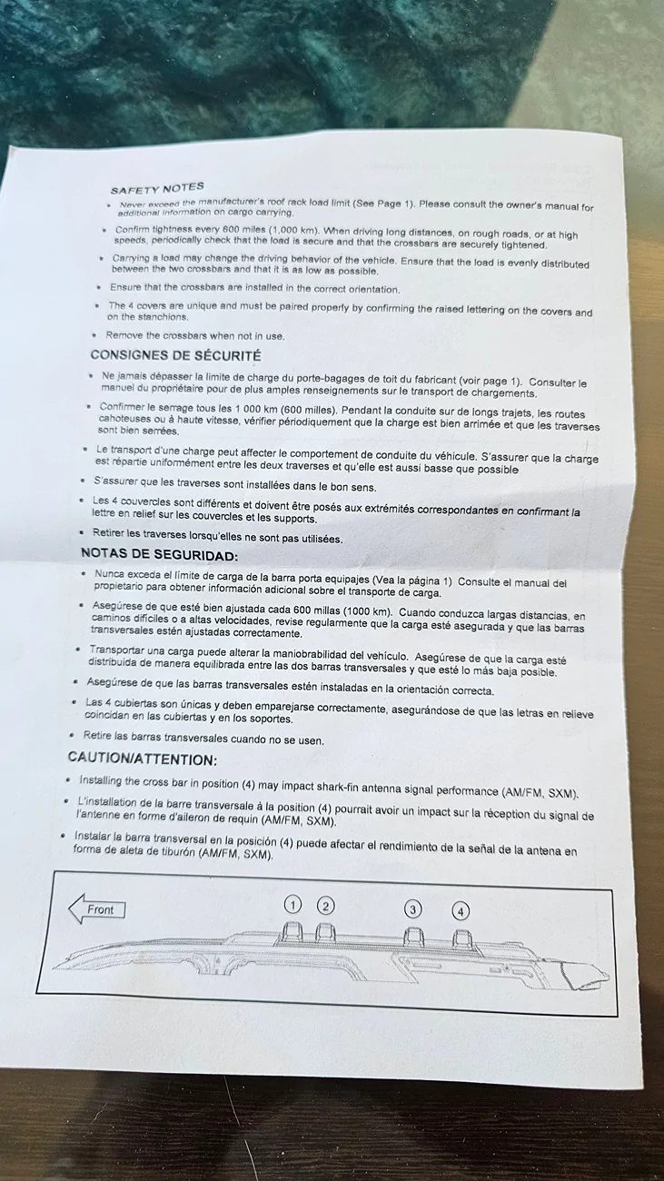

Instructions for the OEM cross bars (attached)
PdlMnk
Jul 19, 2026
101
61
6G4R - TRD ORP Premium Hybrid
I could not find the PDF anywhere and the one place that claimed to have them, the link was dead. I finally noticed I had paper instructions in my glove box, so I thought I';d share just in case anybody wants or needs them.
2025 2026 4runner 6th gen Instructions for the OEM cross bars (attached) 20260811_151539
2025 2026 4runner 6th gen Instructions for the OEM cross bars (attached) 20260811_151549
2025 2026 4runner 6th gen Instructions for the OEM cross bars (attached) 20260811_151553
2025 2026 4runner 6th gen Instructions for the OEM cross bars (attached) 20260811_151600
