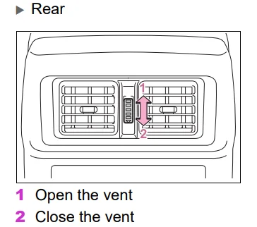

I don’t know if the SR5 has this option, but my TRD pro has a button that will turn rear HVAC on/off. I’ve noticed that disengaging that (I.e you want airflow to the back), then physically closing those rear vents will create better air flow in the front.

SR5 is old-skool
2025 4runner 6th gen HVAC Questions - 2025 SR5 1762542512057-yx
Higher trims have the same thing, a manual knob in rear
but if you can select S-flow on the A/C, it will only operate front seat vents
and not operate the rear while in S-flow mode
