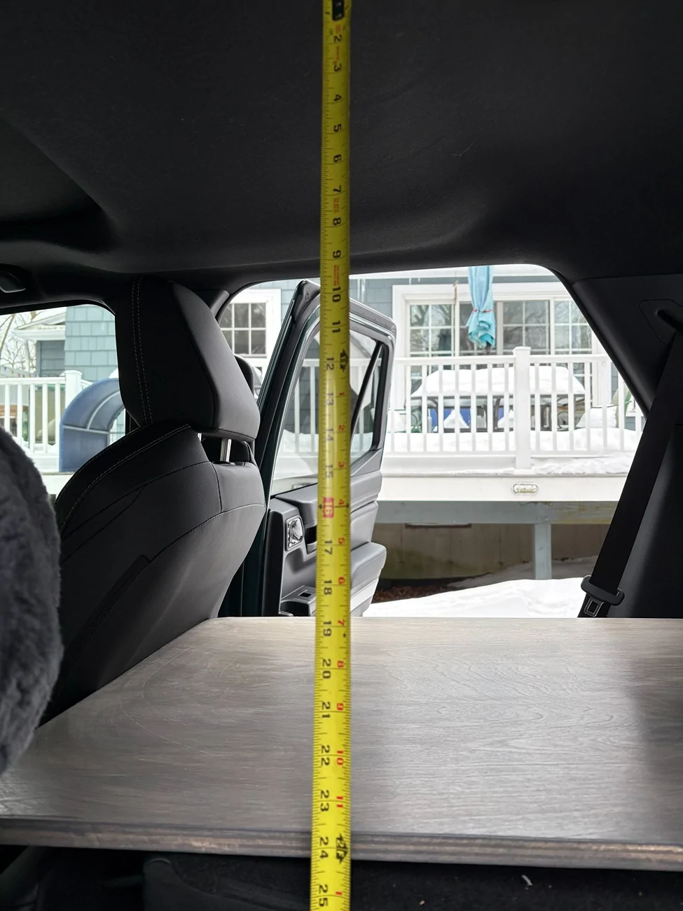

Quick question though, can you do me a huge favour and provide a measurement from top of bed board to ceiling inside cab? I run a similar design of a bed system on my gen 5 and want to get an idea if your design has less or more head room when inside the 4Runner for sleep.
Thanks!
Hi - I took a measurement and it is approx. 24" from top of bed board to the bottom of the ceiling headliner inside the cab (see photo). I certainly wish I had more space for when I get up after sleeping but it is what it is. I found that if I flip the seats all the way forward, I lose too much in sleeping length (I'm 6' 2") so I went with the approach of just flipping the rear seat back down (not the full seat flip forward).
Note that my 4R has a sunroof so as you can see from the photo, you lose a couple of inches height due to the bump out in the headliner for the sunroof.

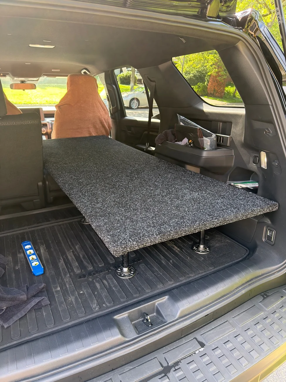

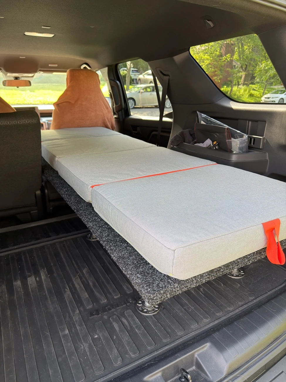

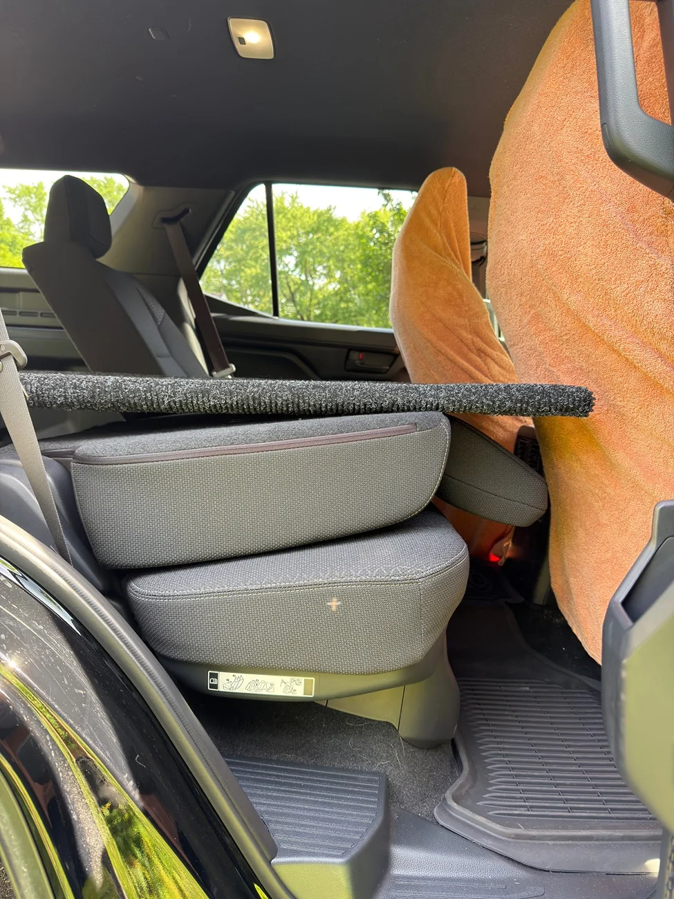

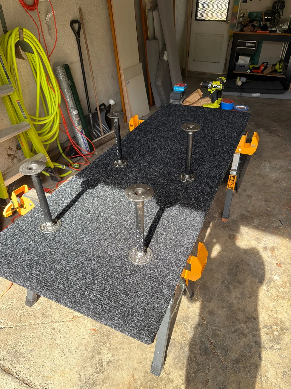

Thanks for all the measurements and information on this. I put together a version for my gas-only SR5, I'll share measurements here. It came out great!
Two key differences I made:
1. I did four points of attachment stability (i.e. feet/poles). I tried with two to begin with, and even though I'm a pretty small guy (~155 lbs) it was bowing a fair bit.
2. I wrapped it in carpet.
Supplies:
1. 4ft x 8ft 3/4 sanded plywood, cut at the store to 74 in. by 27 in. link
2. Carpet. Actually not sure if this is the right one - link
3. 4 x 3/4 threaded pipe, 10 in long - link
4. 8 x 3/4 floor flange - I got mine in 2 packs for ~6 bucks each - link
Also used:
A sander to round out the edges
Staple gun to attach carpet
3/4 in no 10 wood screws (x16)
An Ikea playmat/bed thing I bought a while back and apparently fits perfectly
Note:
From the bottom of the board, the first set of floor flanges are 10 in up
From the bottom of the board, the second set of floor flanges are 31 in up
Each set of flanges is 6 in. from the side (as you did as well)
The 10 in length seems to be virtually perfect to keep the platform level. Not that we always park in level spots of course...

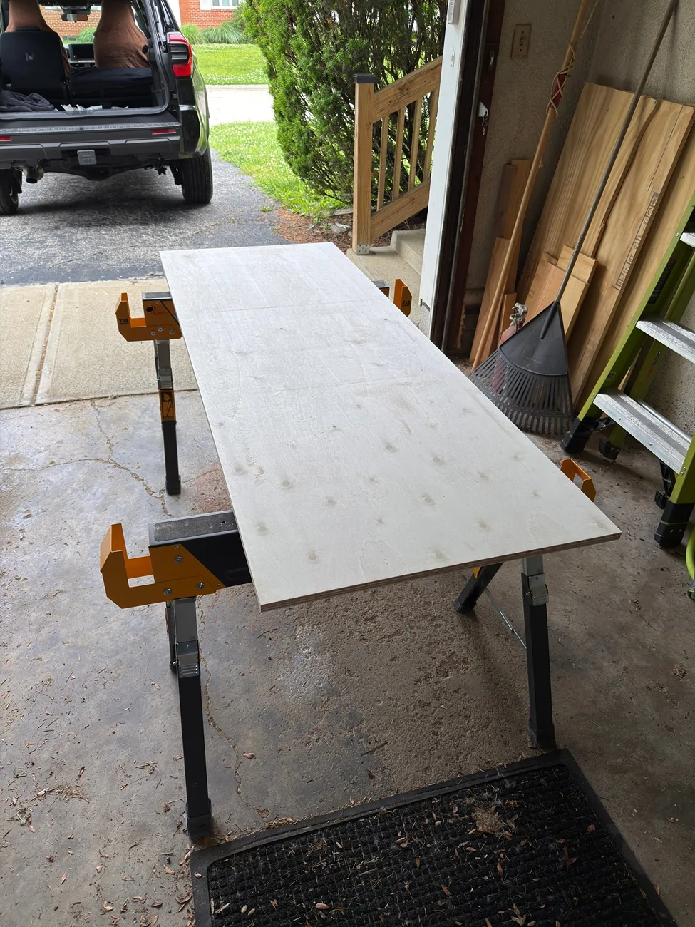

For my Limited, I took your ideas a step further and made one that is collapsible/storable. I used a long hinge off amazon:
https://www.amazon.com/dp/B0BM422FNV?ref=ppx_yo2ov_dt_b_fed_asin_title&th=1
Also got an outdoor carpet and 3M Super 77 adhesive from Home Depot to attach it.
For my posts, I only used one pair of 6" and 3.5" pipe to make it adjustable for my non-hybrid rear. The case was the perfect height in lieu of the other pair of posts.
Thanks to both of you, I'm very happy the way it came out! Now, let's see how much use I get out of it!
