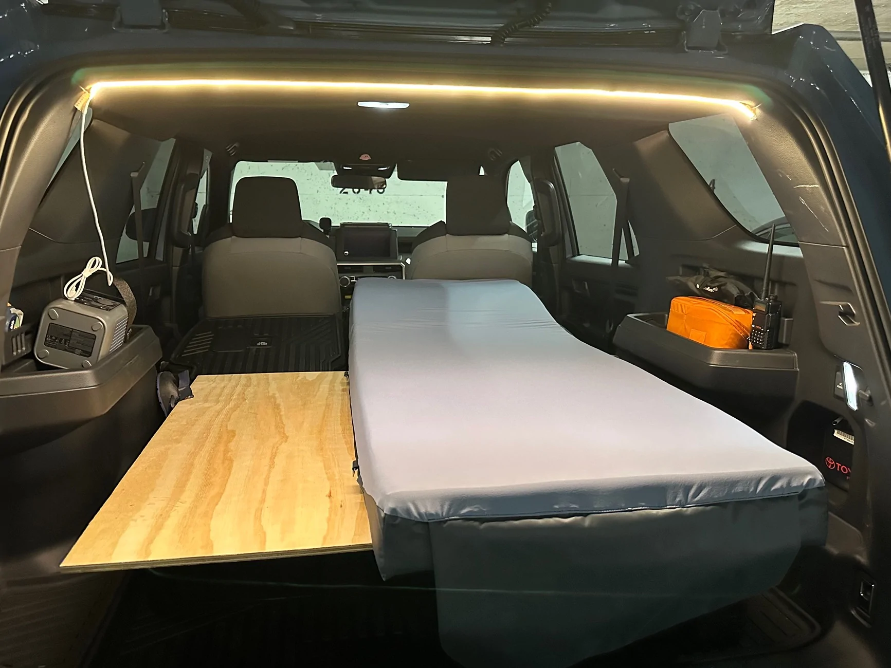

why not just get a plank of wood? thats what i did and put it on 2 front runner boxes.
As for getting out, it shouldnt be too hard to wire a parallel switch and a button so you can open tailgate from the inside

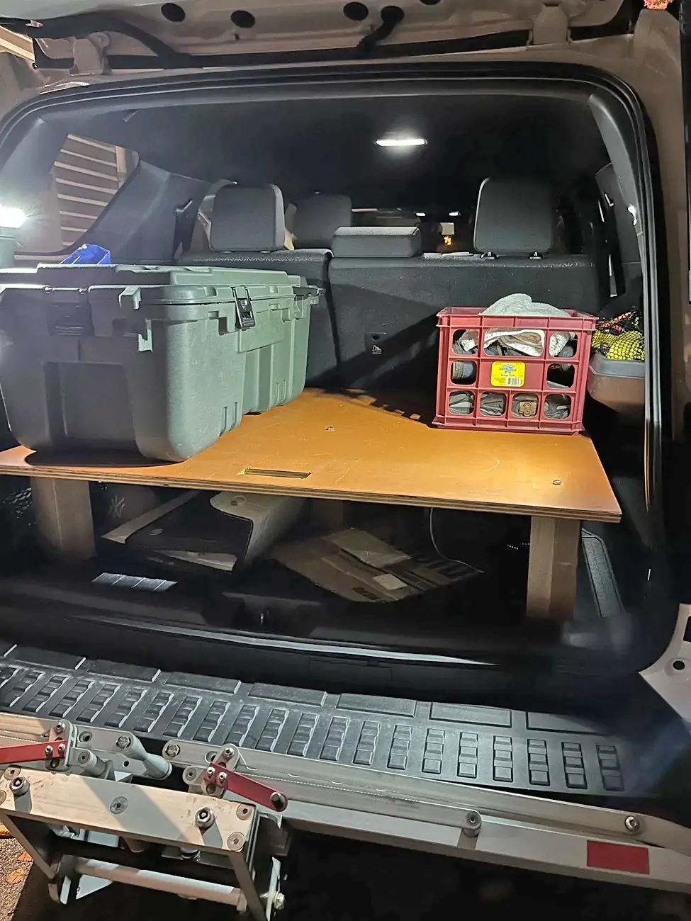

I built one. 42x46 worked great. Front legs 9.5”, rear 8.5”.

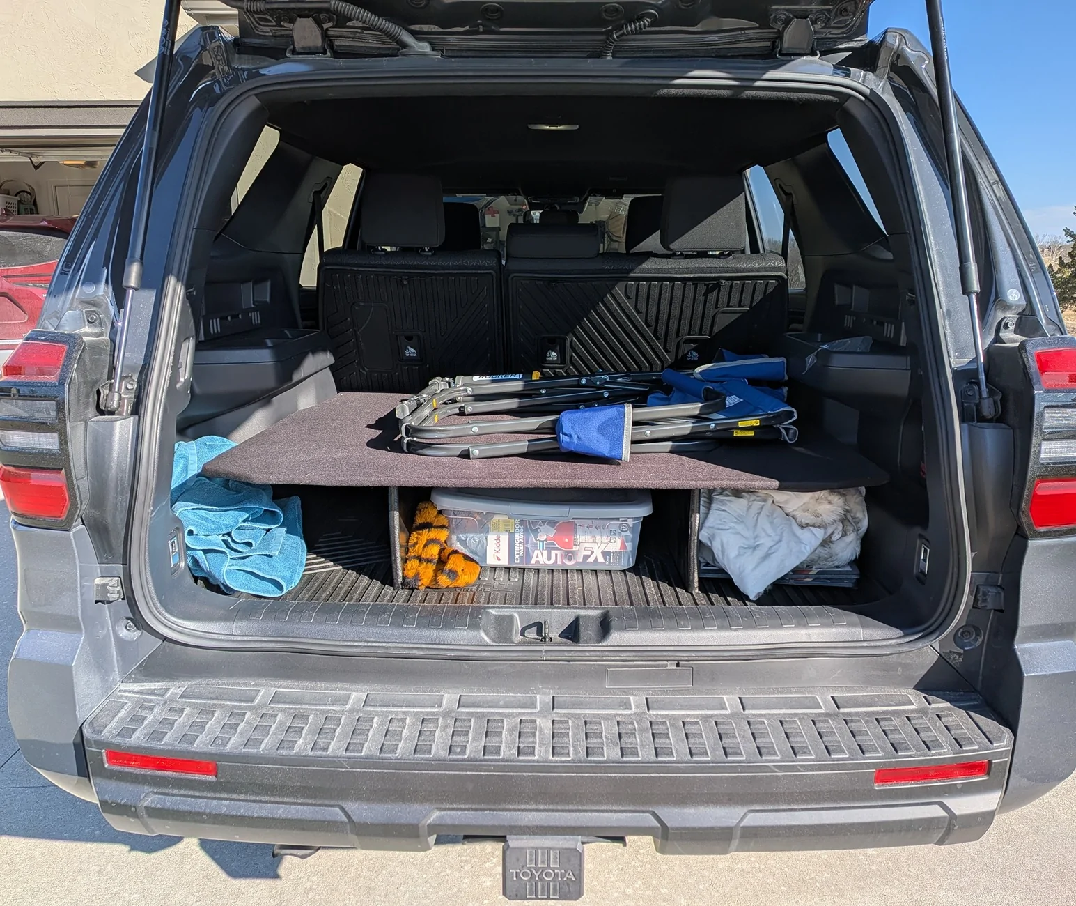

I did a similar DIY solution as well. OSB platform covered with non-pilling black fleece fabric. I don't plan to do any sleeping on it, mainly just to keep my cargo area more organized, plastic tubes underneath and groceries or random crap on top. I think it could hold my weight though, and its right at the height of the back seats when they are folded forward.
