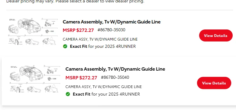

Crazy Idea.... I found 867B0-35030 and 867B0-35040 both say they are for the front... maybe its not software but an actual lens difference
Very interesting!! That's an expensive camera lens!!! I hope it's not the case and it can be a software load.
