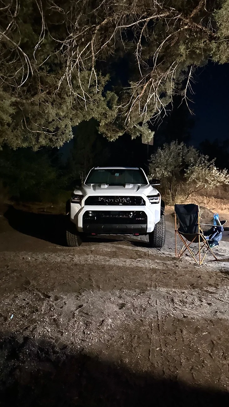

Hi all, it’s been a while—just checking back in. I took the rig on an 800-mile camping round trip. Filled up twice and averaged about 23 mpg. I love everything about this 4R…it’s such a capable vehicle!

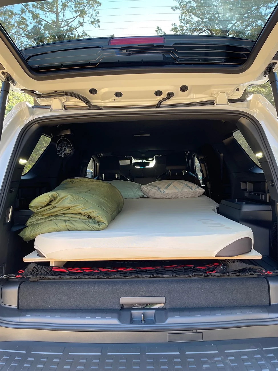

Our setup with Bam bed and Luno airfoam mattress. Let me tell you, we slept like a baby on this bed. Highly recommended.

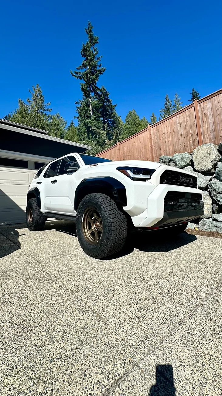

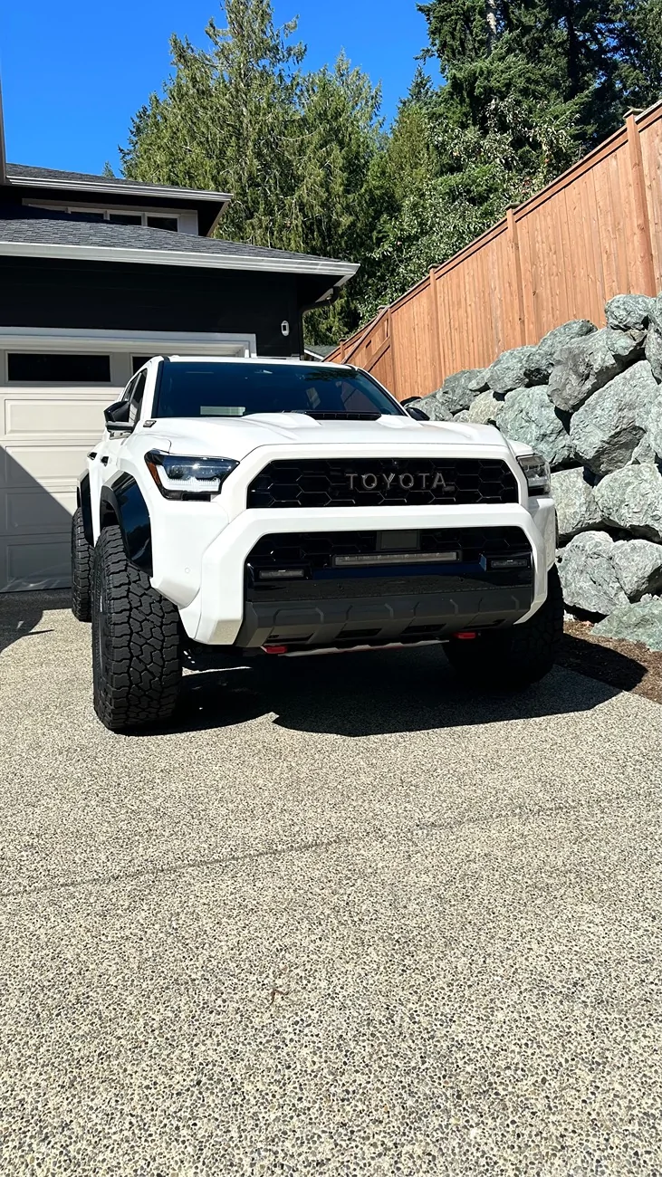

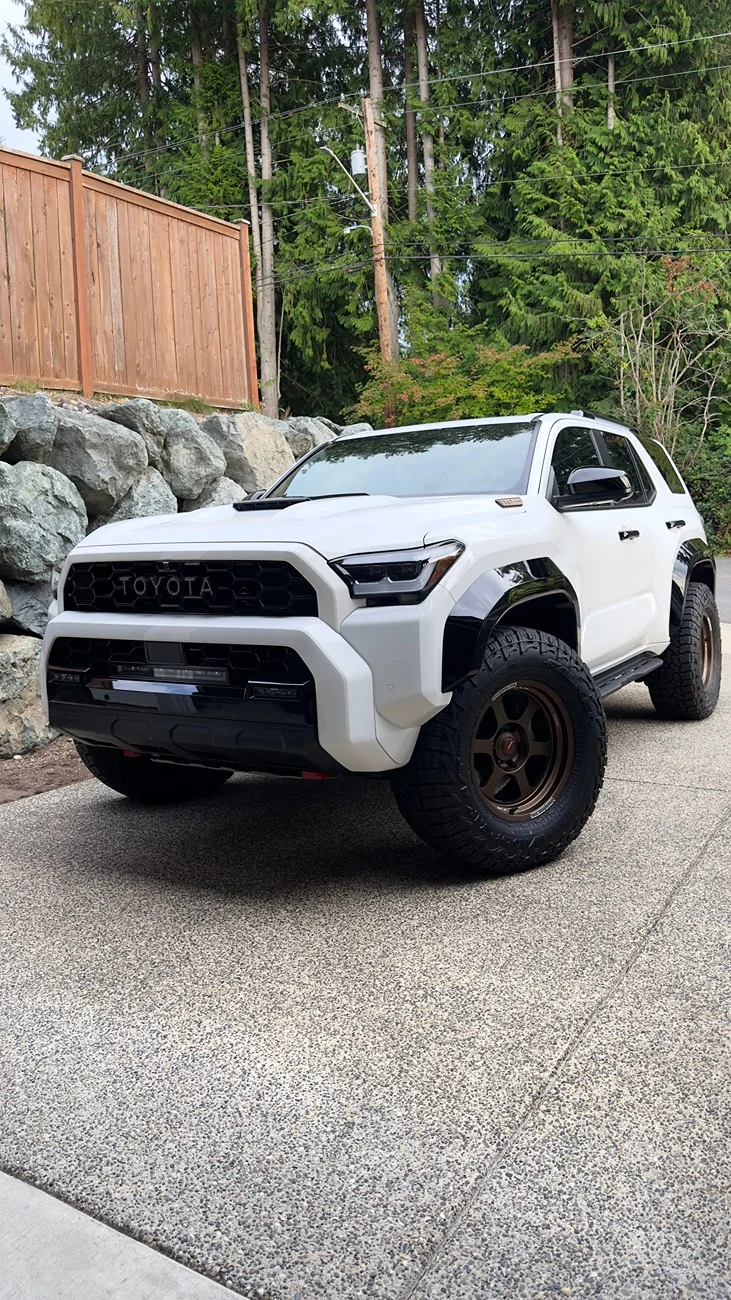

Then after the trip…put on TE37 wheels (0 offset) and Wildpeak 35s (actually 34.5" in 295/70/18). Amazing set of wheels and tires. Truly complete the rig imo.

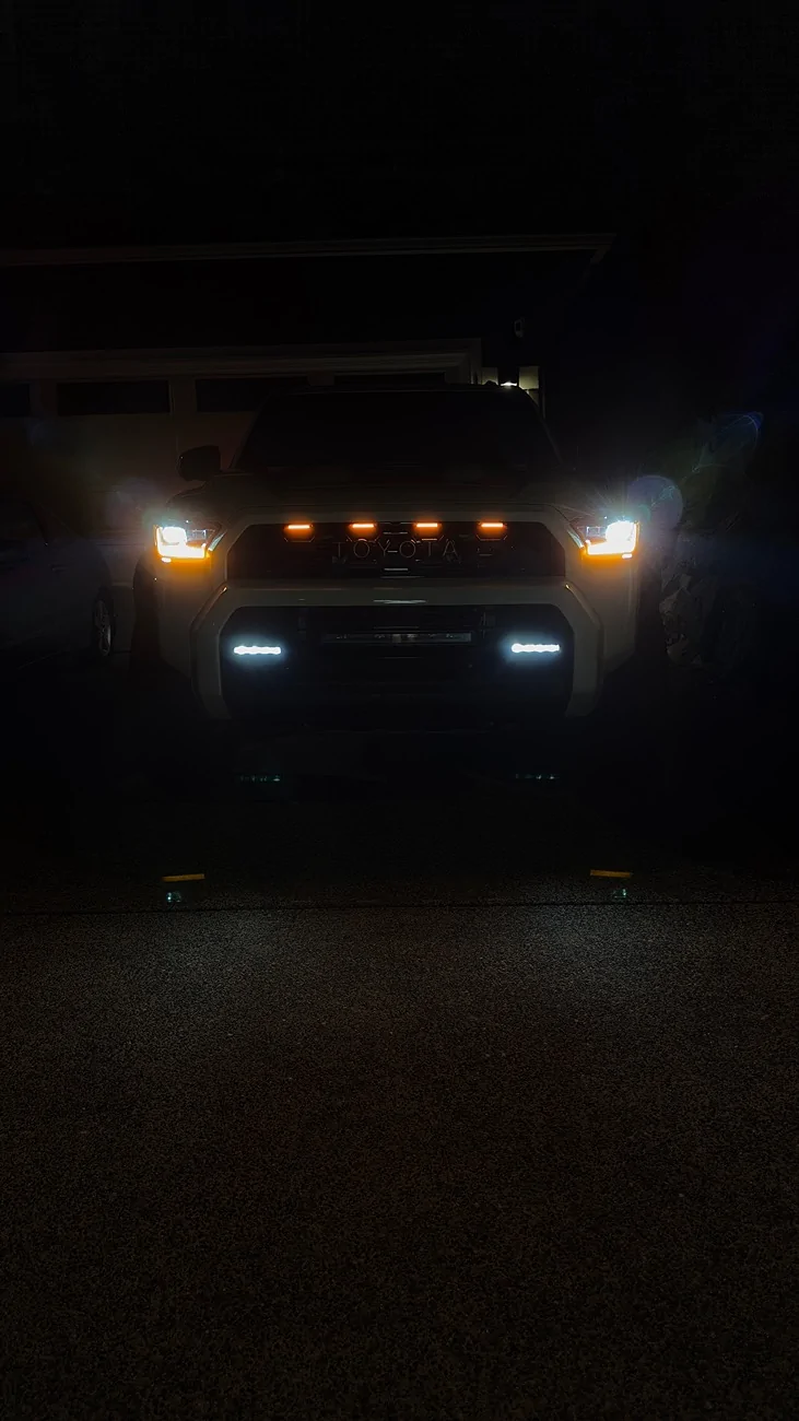

2025 4runner 6th gen Finally, MY Ice Cap 2025 4Runner TRD Pro is here!!! Thoughts, questions, reviews, and the build IMG_1469
Love the Raptor lights.

Hi! Are those the 35x11.5 at4s? The tes are +22 offset? Stock lift? Any rub? Out of curiousity, does the tire actually measure to 35? My 34s per falken’s website actually only measure a little over 33. Great build!

Thank you and it is 295 70 18 and offset is 0. So it’s not a true 35s but very close. Just measure it and it’s currently sitting at 34.5”. Wildpeak tends to be in the bigger size so prepare for that. Stock lift for now on trdpro fox suspension. There was rubbing but after the normal modifications. No more rubbing, it’s a very aggressive setup.

Normal modifications as in removed crash plate?

With this setup, you’re going to need to remove the crash plate, maybe trim the corner of the fenders by the crash plate less than half of an inch, would need an inch raise to clear the front bumper at full lock.
