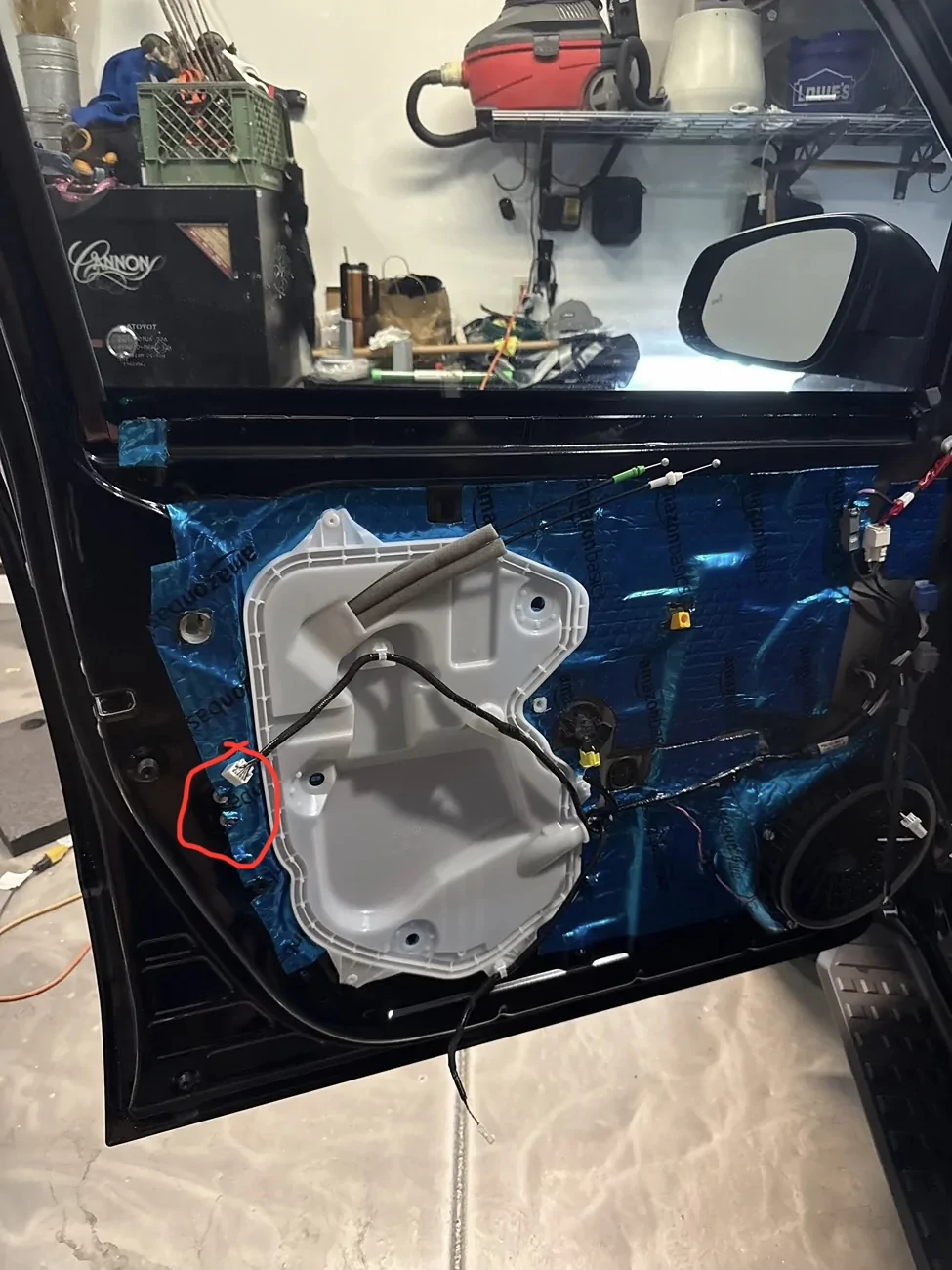

For those still wondering where to put the foam. The two bolts outlined are connected to a bracket inside the door. Unscrew the bolts, there aren’t any nuts to worry about falling in the door, and on the inside of the door panel place a piece of foam between the bracket and the door panel. Then put the bolts back through the panel and foam connected to the bracket and voila, you’re finished. I went the extra step and shoved some foam between the rubber window track and the metal bracket that’s inside the door panel but hopefully the initial foam piece will work for most.
My dealer said it’s normal operation and that some cars rattle. I knew at that point I was working with an idiot and didn’t feel like fighting that battle so I opted to fix it myself. Happy I did, now I enjoy my daily drives.
