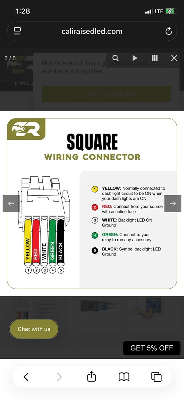

Did you hook the ditch lights to the oem switches
Yes. Backlight to Aux 5 and the lights themselves to Aux 3.

I got the cali raised oem switches. Looks solid af
Yea that’s what I was looking to put together. Exactly those two with the ditch light switch
Yup, I got the ditch light set, roofrack bar light, back up lights and the fourth slot is where I am undecided between rock lights or scene lighting.

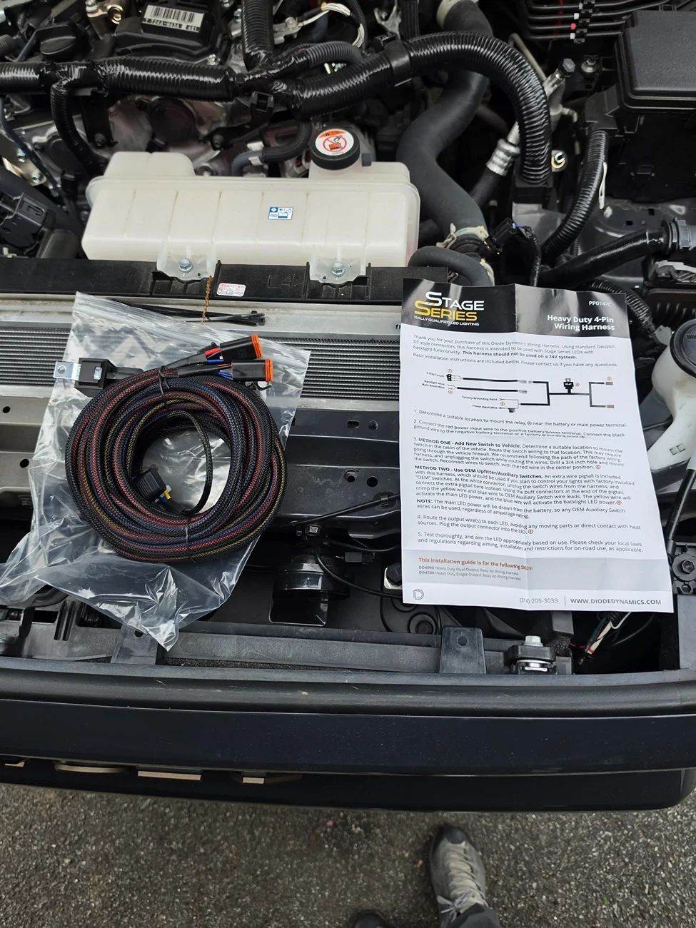

Is the pre-wired stuff already run to the battery so you just need to plug in the pigtail to the lights and no power or ground to the battery in the rear?
You splice them into the OEM pigtails for the Aux circuits. Pigtails are plugged in either under the dash kick panel on the driver's side or under the hood.

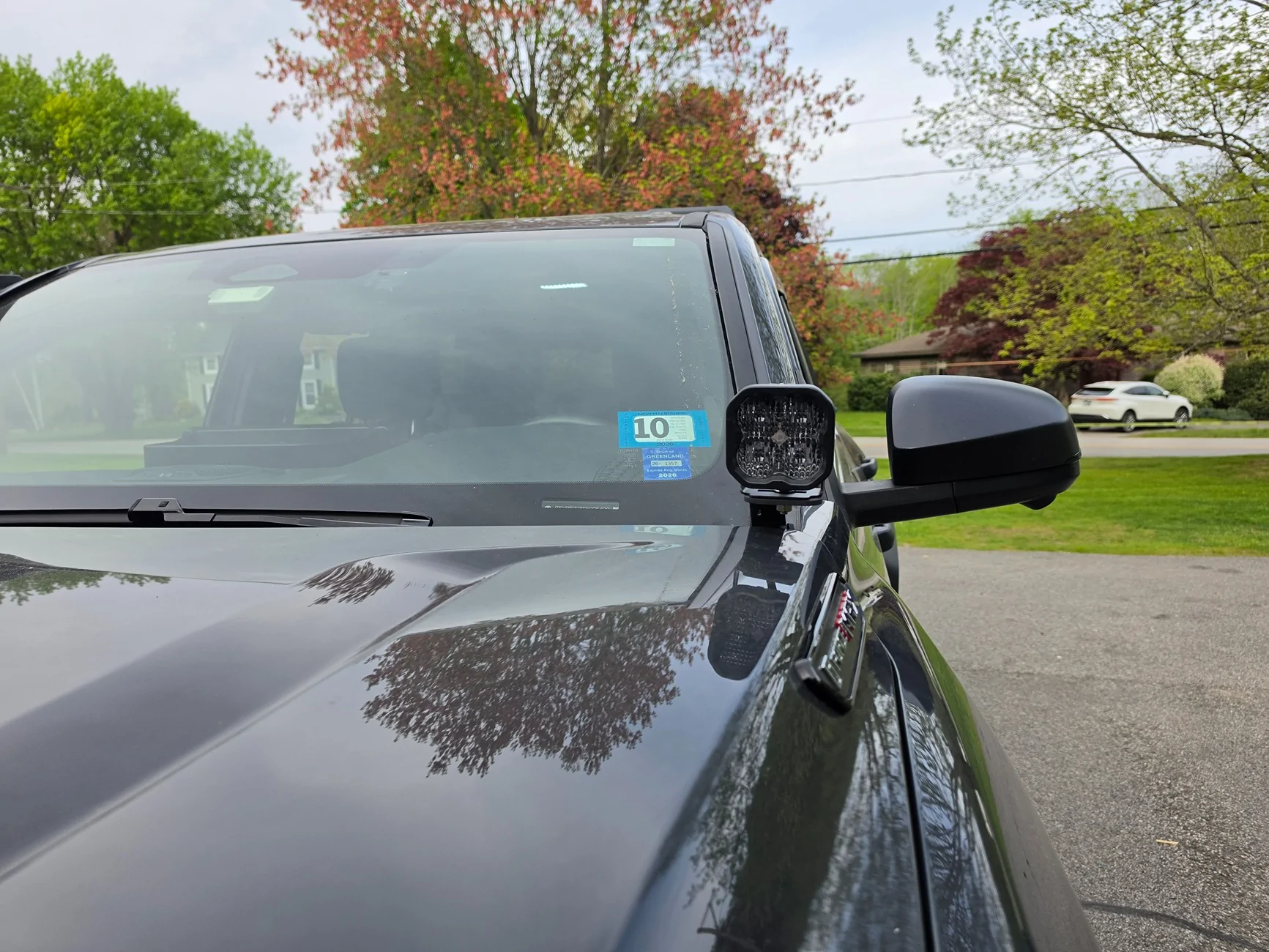

Nice. I was also going to go Diode since I've used their LEDs in the past. Which kit did you end up running from them?

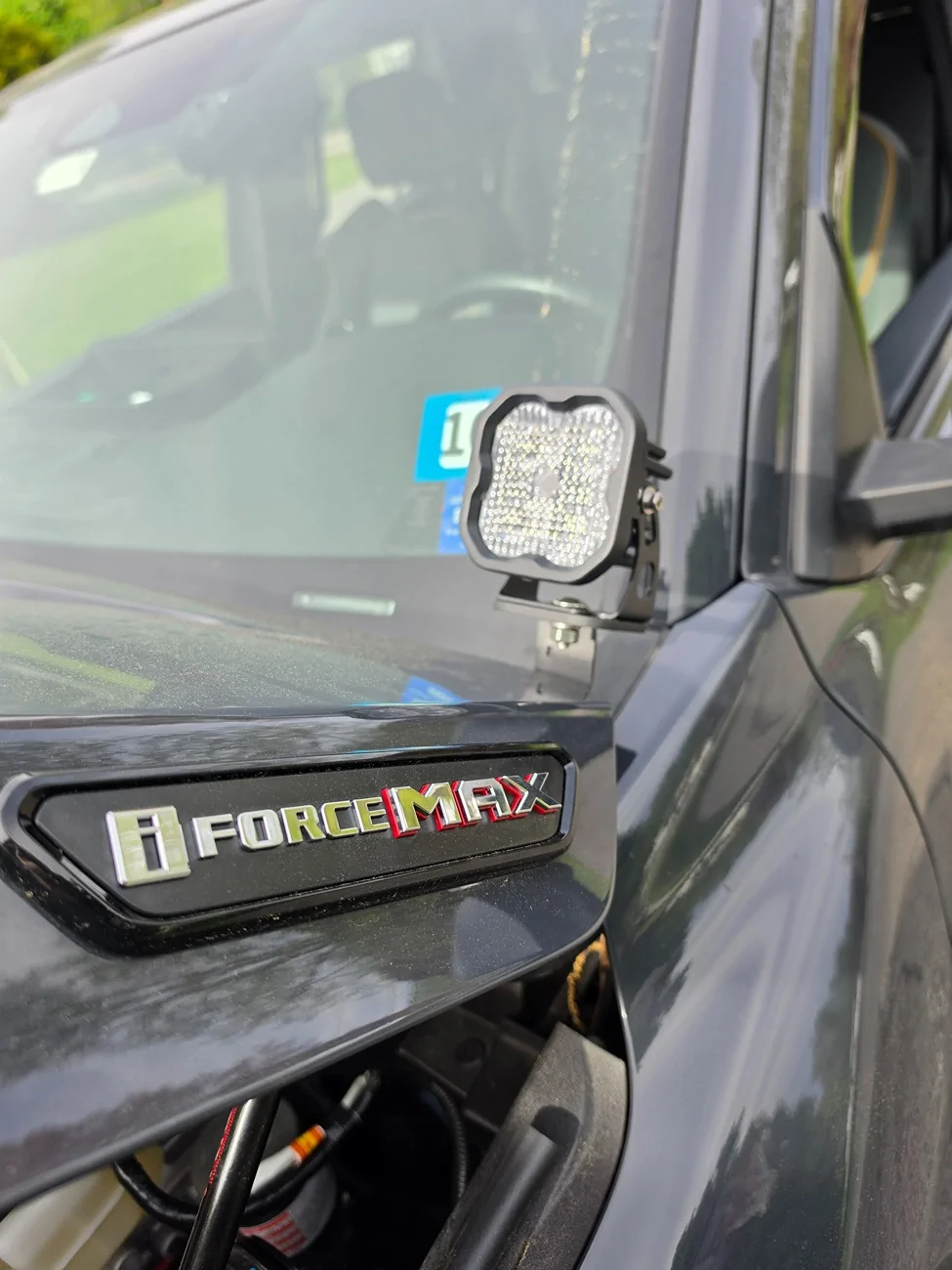

I’m glad to see someone running the morimoto 4bangers! How do you like them? Did you go with the Hxb or the NCS?
I went with the HXB. I really like them. They're super bright but a nice tone of amber. I had to use the on a really rainy foggy night and the cut through the mess with no issues. And they arent super big. I didnt want anything getting in the way of my field of vision.
