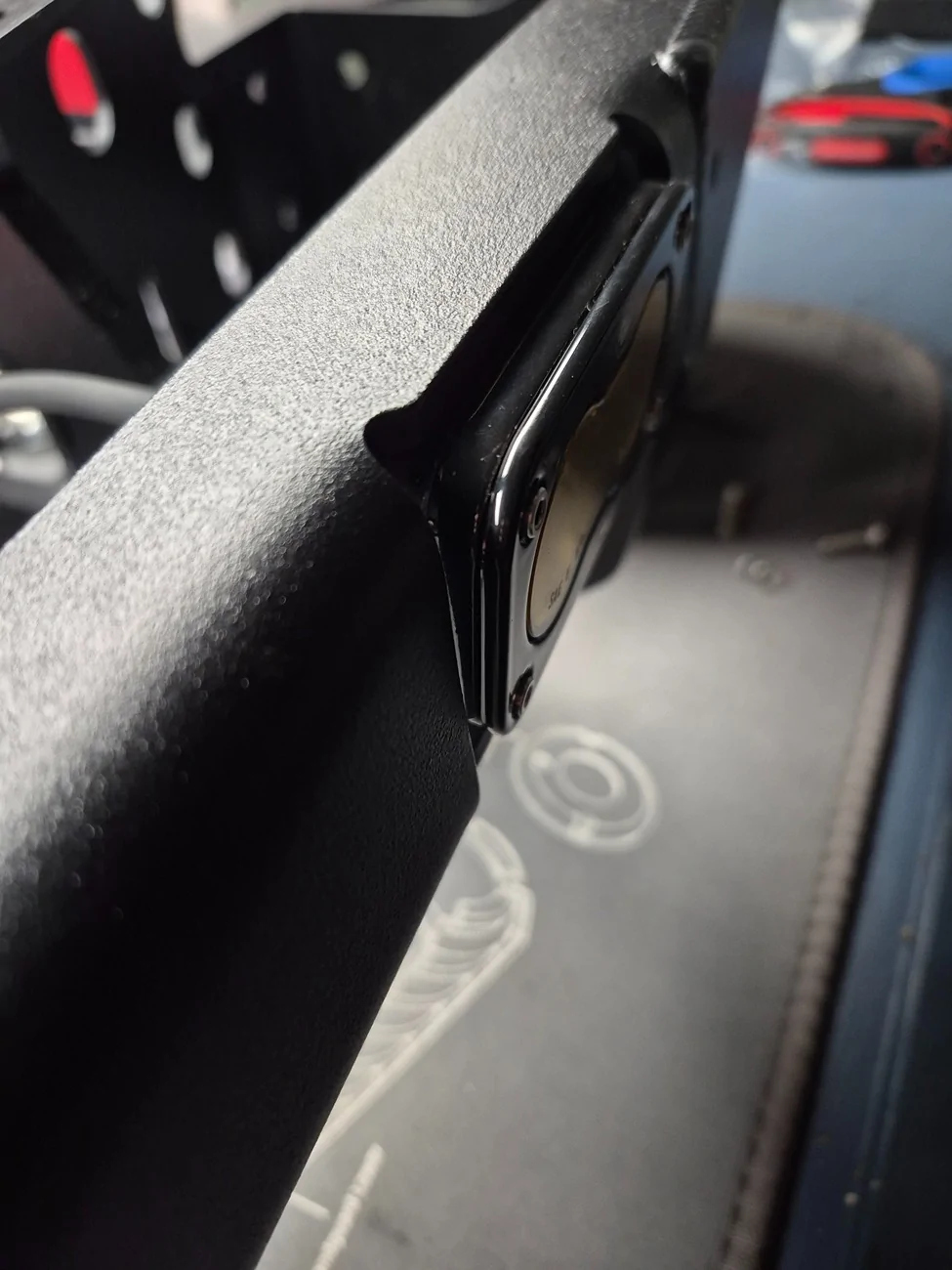

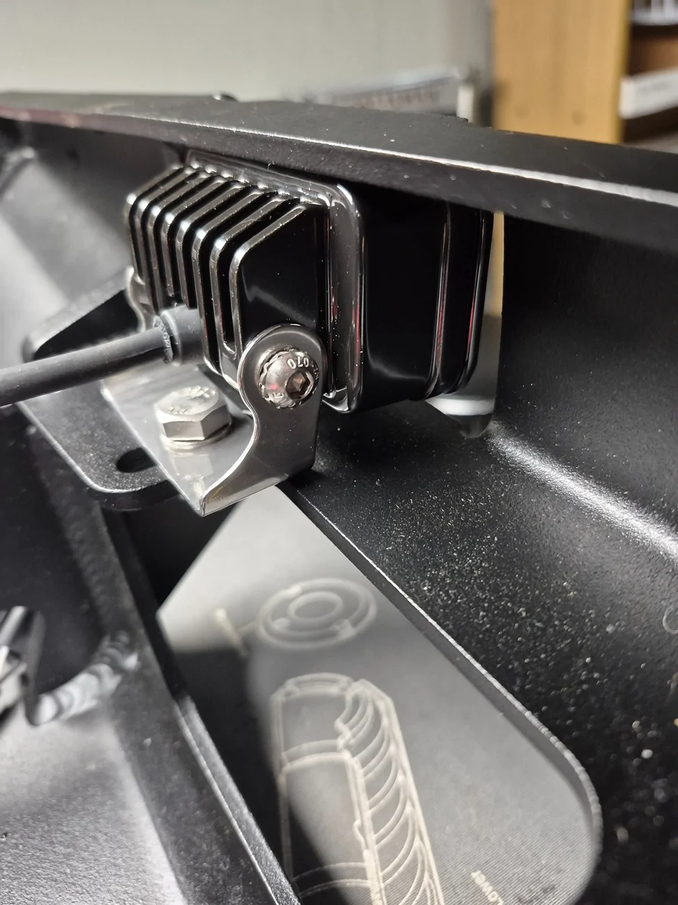

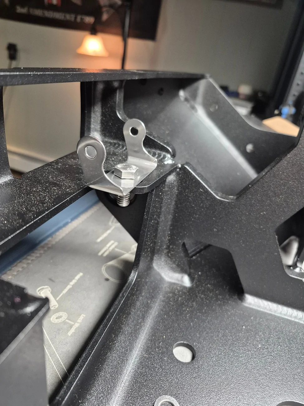

Anyone install the Dissent Offroad Low Pro Bumper? Do you have pics of the Baja Design light mounts? I believe they may have sent me the wrong mounts.

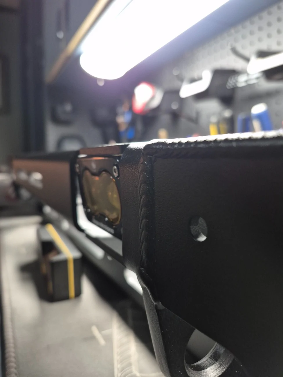

Started prepping the bumper for install and when I got to installing the lights I found they don't fit the openings in the bumper. Lights are suppose to be flush with the face of the bumper but as you can see in the pics it hits the top of the bumper and will have the lights pointing down way too far.
Hopefully they sent the wrong mounts because if the bumper was made wrong to the point that the lights they sell for that specific bumper don't fit what else is wrong and there is no way I'm going to trust to cut the bottom of a 75K vehicles bumper off only to find the Dissent bumper doesn't fit the opening.
Can't really see it being the case as any different as any other low pro bumper they make as these are formed and have to fit together to be welded up. If something was off it should have been caught when trying to put it together.
I sent them a message Friday but haven't gotten a response yet. Anyone with pics of the Baja Design light mounts for this bumper would be great.
BTW, this bumper is beef and I really like it and hope it's a simple fix.

Just learned there may be a second set of mounts that Dissent makes for these lights, hopefully that's true and they just forgot to pack them because this put the whole project on a standstill.

Great news, Dissent has taken the time to respond to me over the weekend, seems there are 2 sets of brackets for the sidelights, one from Baja Design, one from Dissent.
Dissent will be sending me the right brackets. Shout out to Customer Service.
