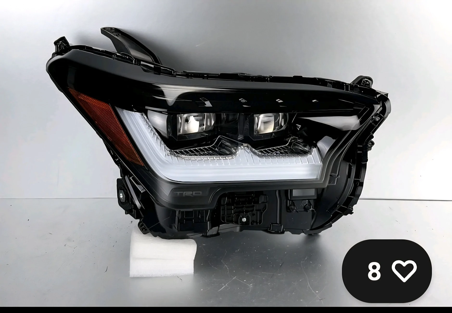

I tried everything you said BTW are you referring to the amber square shape by the headlight or what I read is called the lazy L the LED strip at the bottom of the headlight this is what's not working?. Thanks for helping
your 4runner does not have an LED strip that is why it is not working. Only Platinum, Trail Hunter and TRD Pro have that.
OMG last Tacoma had one my 21 Tundra had a cool loop around the headlight all the new cars have different types of white LED rope lights around the headlight and Toyota dropped the ball. I'm disappointed I saw the one your talking about
2025 2026 4runner 6th gen Daytime running lights not working? Screenshot_20251123_171238_eBay

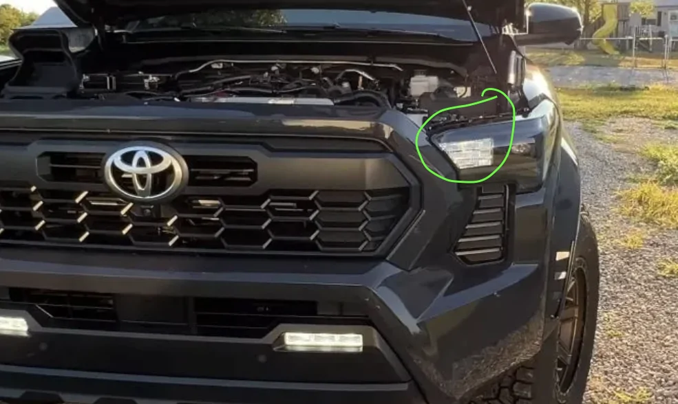

Im talking about the daytime running lights at the center. Not the LED strip copied over from Audi from 2012.
I can't post my pic to show you. For some reason it wont let me. Happened multiple times. Its only 180 kB...

Here go. Finally uploaded. This setting and then going into the infotainment setting as shown above.
2025 2026 4runner 6th gen Daytime running lights not working? 2
