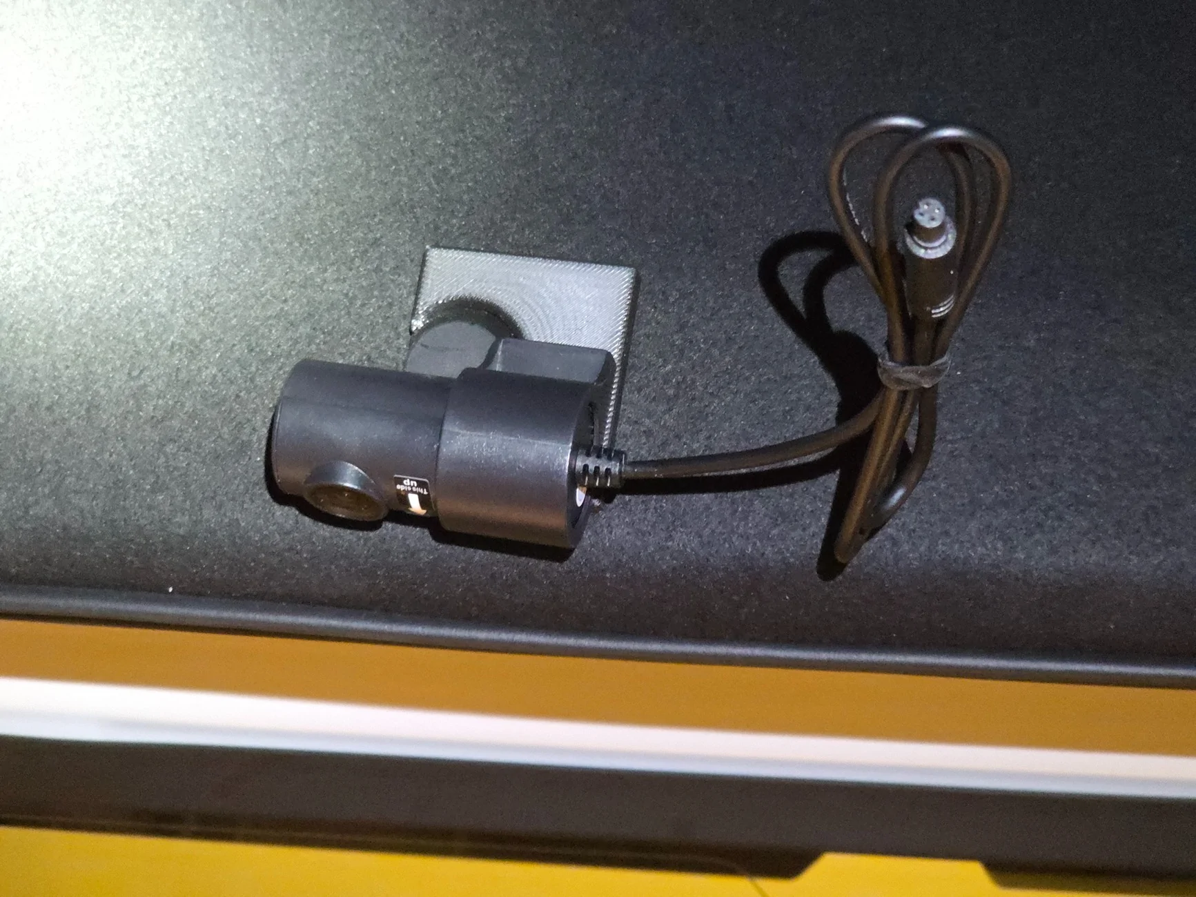

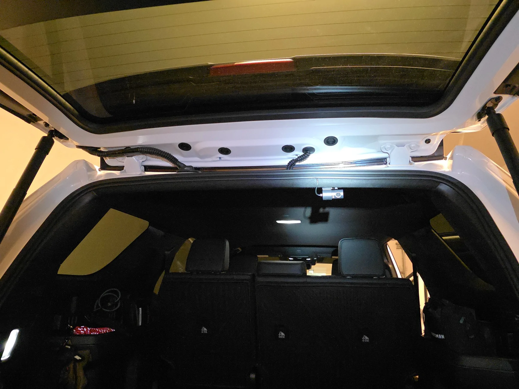

3D printed mount on headliner's clip:
https://www.thingiverse.com/thing:4963162
If you don't have a 3D printer, get it on Amazon for $13: https://amzn.to/45Cq8bz
Then mount like I did below. Run wire hidden in the headliner to the front.
2025 2026 4runner 6th gen Dash Cam - Rear Camera Mount 20260118_172850
2025 2026 4runner 6th gen Dash Cam - Rear Camera Mount 20260118_172125
2025 2026 4runner 6th gen Dash Cam - Rear Camera Mount 20260118_172835

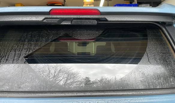

Protip: mount on the passenger's side clip, NOT center. This will allows the camera to see the rear when the window is dirty, like this:

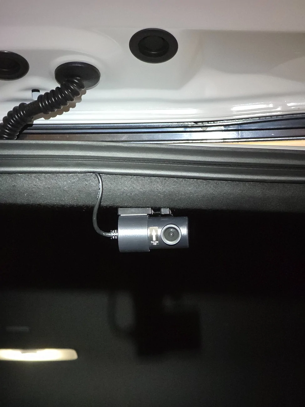

2025 2026 4runner 6th gen Dash Cam - Rear Camera Mount {filename}
This is exactly what I did for my 2026 4Runner. Used the existing mounting clip and that 3D printed piece from Amazon. Works well, holds it solidly, and I don't have to worry about outside moisture or having it stick to a moving rear window. :)
