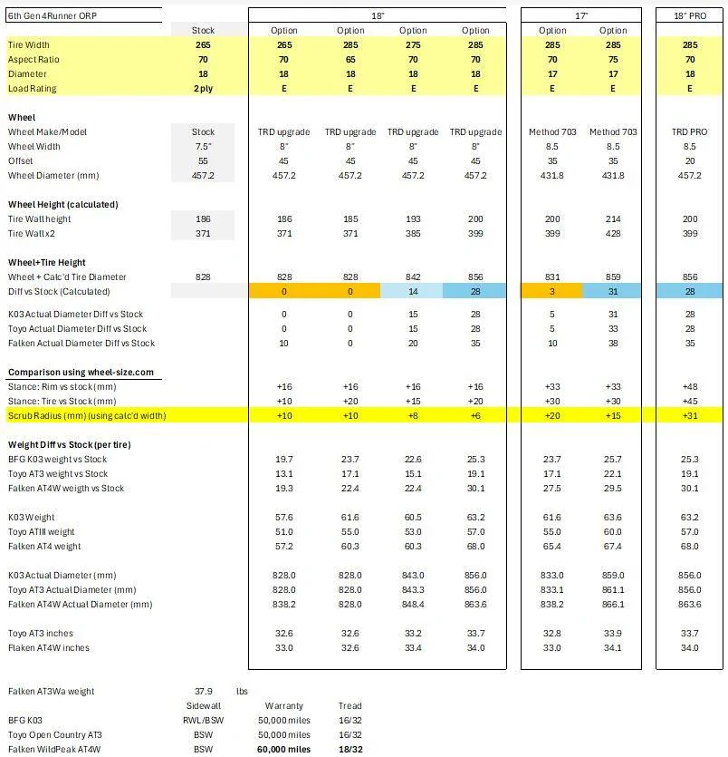

Decided to capture all the info I had been looking at on tire and wheel options I was considering. Used wheel-size.com for stance and scrub radius impact. Sharing in case it's useful to anyone else considering their options. I checked it, but I'm not guaranteeing I copied everything onto the spreadsheet correctly.
TRD upgrade wheel is PTR56-35242-F1.
Weights are in lbs. Tire measurements and offset are in mm.
2025 4runner 6th gen Comparison of different wheel and tire size options + difference to size, stance, scrub radius, weight vs stock ORP wheels 2025 4Runner wheel sizes

Ya, A few lighter weight options would be nice, especially in 18". I originally looked at a Load Range C in 285/70/R17 but there was no weight savings on the Toyo or Falken so I hide that column.
