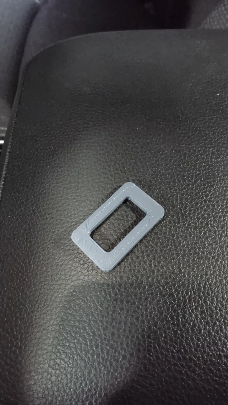

I disabled it with a Launch bi-directional programmer from aliexpress, x431 or something like that, $115 but no subscription and no limits. It disabled the continuous alarm but it does still do 5 dings once every time at first.
So I printed a simple pacifier that plugs into the buckle, now no alarm at all.
2025 4runner 6th gen Carista not actually disabling the seat belt warning? 20250822_213336461
2025 4runner 6th gen Carista not actually disabling the seat belt warning? 20250822_213409359
