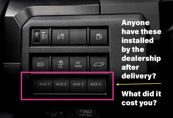

Anyone have these installed by the dealership after delivery?
What did it cost you?

I don't think you can. It's a lot more than just four switches. Pretty sure it's only for the hybrids, and it's also quite a bit of wiring from front to back of the truck, plus a whole ass alternator setup.

will be way less expensive and more functional to go with a switch panel. You can get them for a couple hundred bucks and install yourself.

Anyone know if you can switch the positions of the Aux switches inside the OEM cluster, I hate where the OEM Aux switches are located, would love to move them to the top row where I can actually see them.
its pretty easy to access the location and pry it open. I haven't seen anyway swap the locations but if the wires reach you should absolutly be able to move them. -
TIA

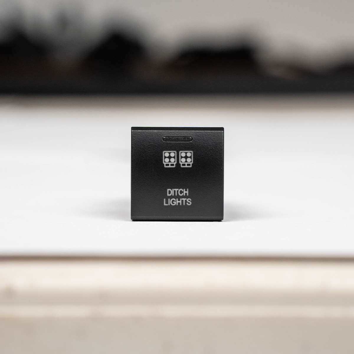

It really depends how much you want to install... I'm prob just doing ditch lights so plan to install a light that says ditch vs the generic Aux 1
