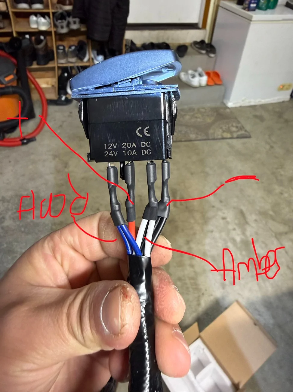

I have the rough country Ditch lights which I just installed the other day and used the factory aux switch for the flood. My ambers are powered by the ignition, so I don't use a switch for it. This is something you could do. Other wise read below
For Rough Country Ditch lights switch:
White --> Amber DRL
Blue ---> Flood light
Red ----> Positive (+)
Black ---> Ground (-)
Then you would need to figure out on Cali Raise switch what each color wire is for. Contact cali Raise for it.
Once you have it., cut the terminal ends off the RC ditch light switch and splice the wires into the correct color combo for the Cali Raised switch harness.
