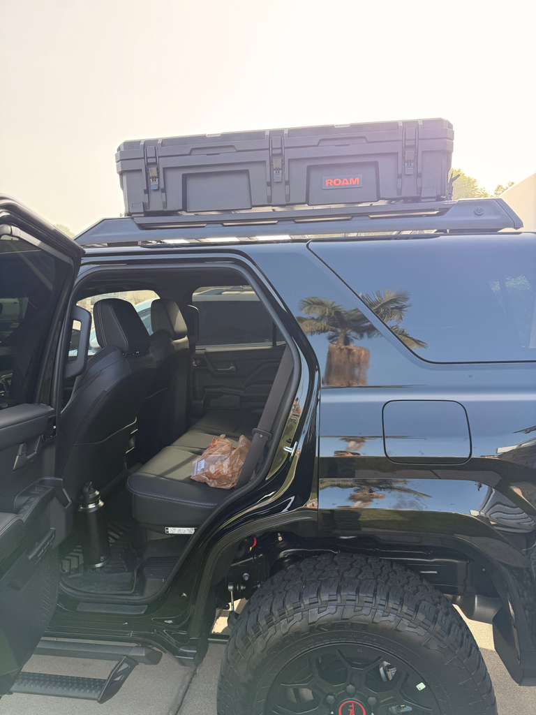

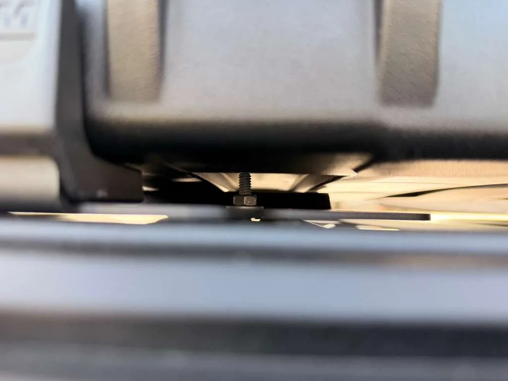

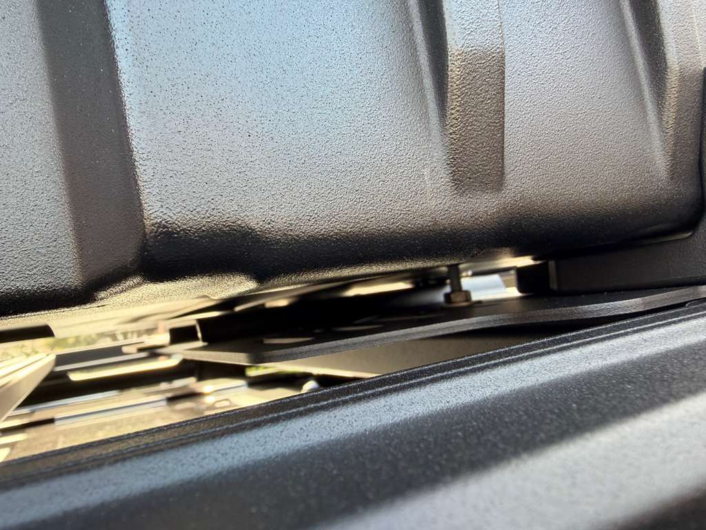

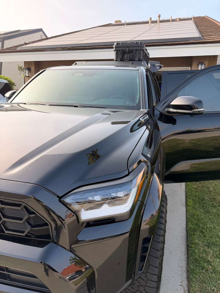

So I "temporarily" Figured it out !
Went to Home Depot and bought 1" M6 Hex Bolts , Nuts and Washers x2
worked perfectly where the bolt won't rub against the bottom of the Roam 95L Case
attached images of install along with items I bought from HD for ref

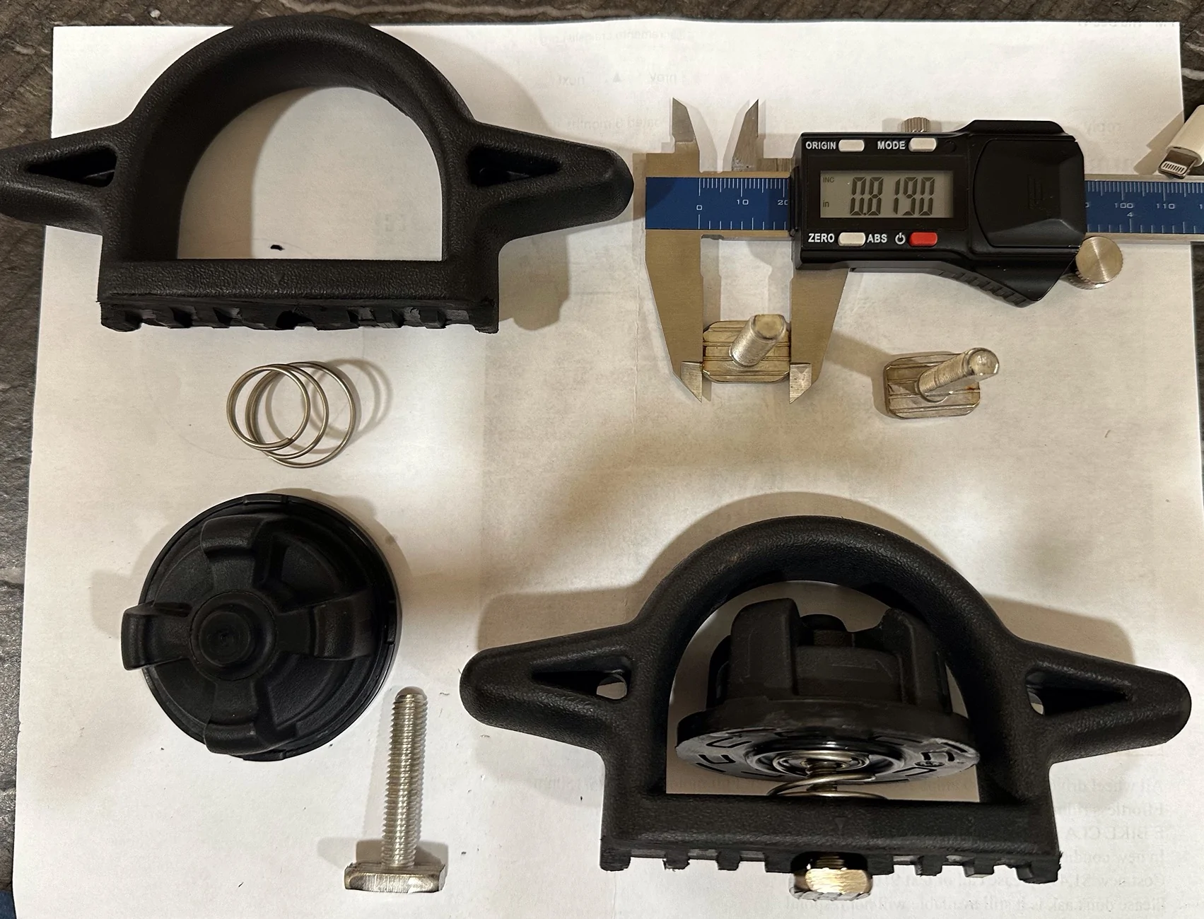

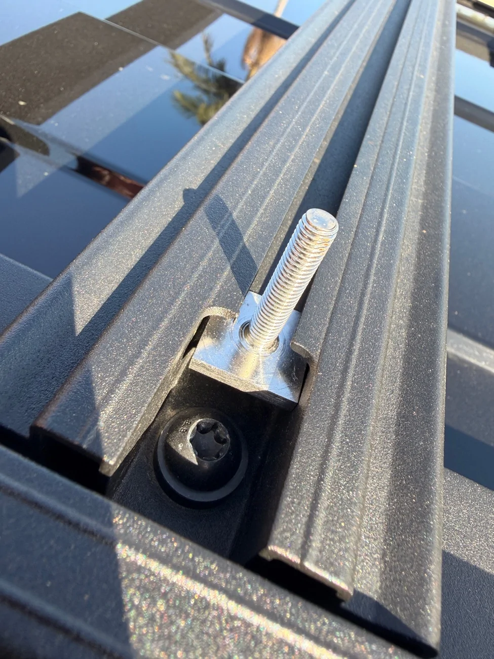

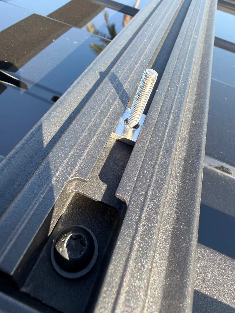

Update
Found these T slot screws and they fit perfectly
Pics of fitment and product link - will later post of images with Roam installed
DALQUIS 6 Pack T Slot Bolts for Roof Rack Cross Bars | M6x30mm Stainless Steel Square Track Adapters | 4mm Thick | Easy-Fit https://a.co/d/08GBzjrD
Nuts
M6 x 1.0mm Nylon Insert Hex Lock Nuts 50Pcs 304 Stainless Steel Locknuts, Hex Drive, Bright Finish, by SG TZH https://a.co/d/0j4TIpA9
