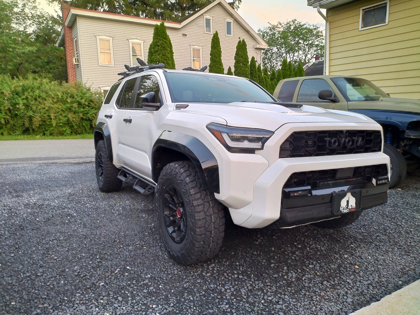

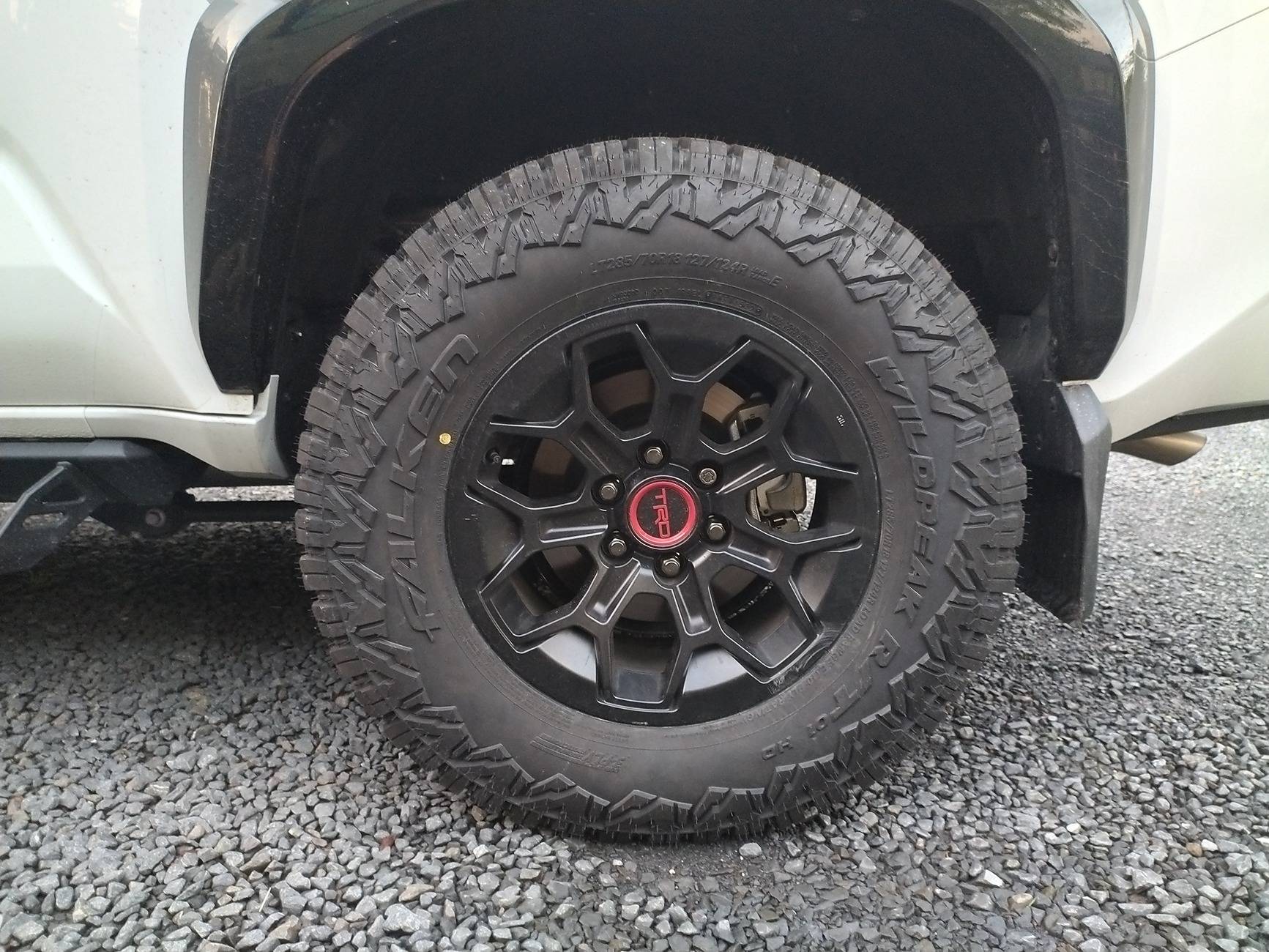

Decided on the Falken WildPeak R/T01 285/70/18 - 34" x 11.7" x 9"
Have my initial review in the Bigger Tire Compilation thread.
2025 2026 4runner 6th gen Any TRD Pro's running 295 tires? Offset, Backspacing? IMG_20250610_202126
2025 2026 4runner 6th gen Any TRD Pro's running 295 tires? Offset, Backspacing? IMG_20250610_202154
2025 2026 4runner 6th gen Any TRD Pro's running 295 tires? Offset, Backspacing? IMG_20250610_202536

That looks nice. Do you have a full size spare with the same tire?

Have it, but have to get a tire carrier to mount it. Maybe next month... :)

Did you have to do any mods to make these tires fit? And aren’t the premium wheels +45 offset? This looks great
