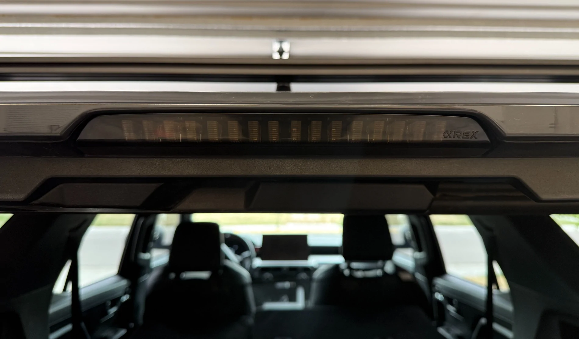

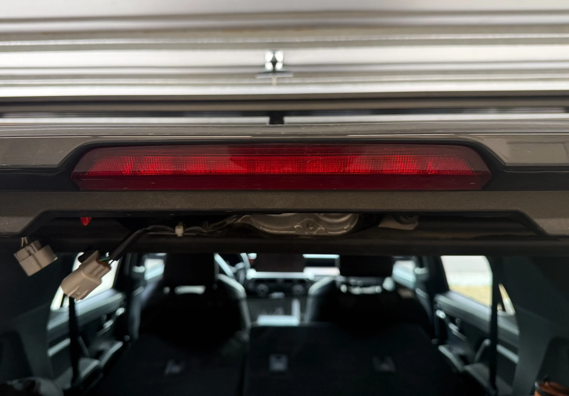

Added the Alpharex 3rd tail light. Was a bit of a pain to install but you know what they say right tool for the right job and got it done. Love the smoked out look and the flash.
Before:
2025 2026 4runner 6th gen Alpharex 3rd tail light installed - photos / video IMG_0570
After:
2025 2026 4runner 6th gen Alpharex 3rd tail light installed - photos / video IMG_0578
Lit up:

Looks great. I was going to buy the Diode hitch light, but I think I like this better for improved braking notification. Let us know what part of the install was a pain and what tool(s) came in clutch for getting it done.
It's just really tight so needed a 10mm wrench doing like a 1/4 turn at a time because the socket wouldn't fit to take out the wiper assembly and then a ratcheting L shaped screwdriver because to undo the light is a super strange angle on one side.

Just finished my install. Removing and replacing the wiper motor is tedious. I feel like it would've been 10x easier with a 10mm wrench with a ratcheting end, but sometimes even those are too thick to fit in a tight spot. Patience is key I guess.
Aside from that, really happy with the light.
