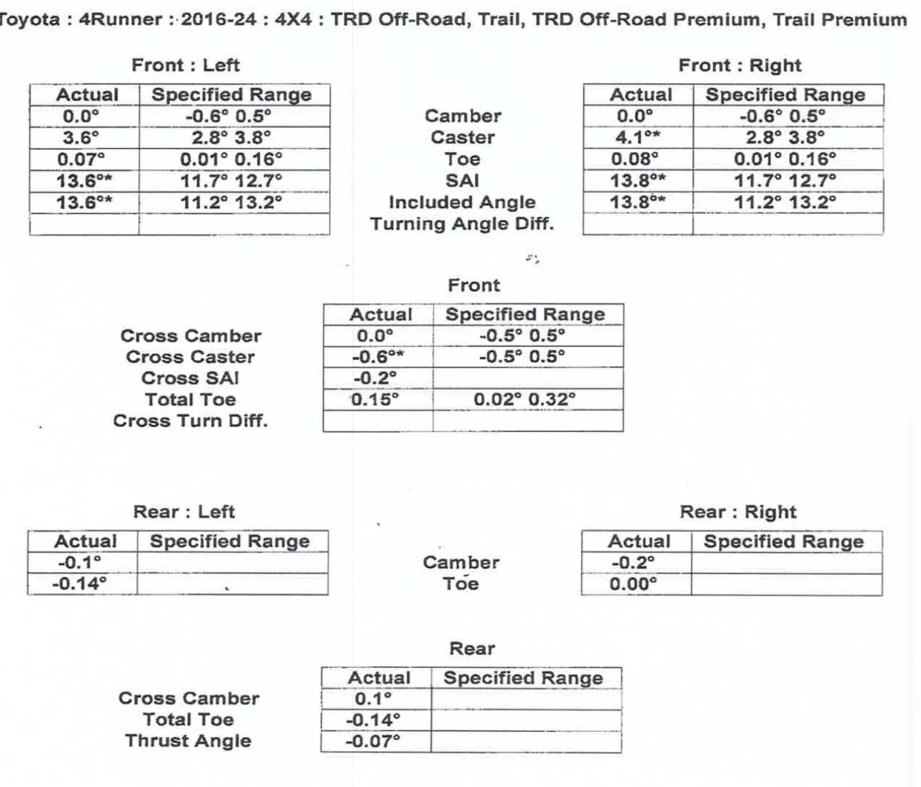

Apparently Toyota hasn’t released the alignment specs for the 6th gen 4Runner, so they had to enter their own custom values for the alignment based on the previous gen & their experience.
How has everyone else been addressing alignments specs post lift kit install?
I have the values they ended up at, but was hoping to see the actual 6th gen alignment spec ranges for my trim to have full confidence it is within Toyotas specs for this model. This was part of the reason I went with the pre collar lift.

I agree! I was quite surprised to hear this. Caught me off guard. Here are the actual values they arrived at.
2025 2026 4runner 6th gen Alignment Specs? IMG_5920
Have these numbers proven to be accurate, seems Toyota still hasn't released these numbers for the 25' yet. Do you know if the Pro's are the same as the other trims for alignment specs?
