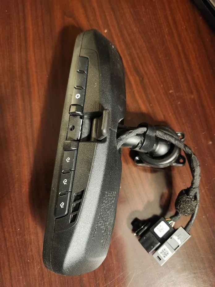

I don't actually know for sure whether you could just plug in the toyota mirror with camera and have it work, but I do know exactly what connectors you should look for - since I recently replaced my OEM mirror (with rear view camera integrated) with the Wolfbox G900TriPro - which means I have an OEM unit to sell. I assume you have the rear camera that shows on the big display when in reverse. I'm not sure if the camera for the rear view mirror is the same one but ... probably?
So, assuming you have a toyota-integrated rear view camera, the photos below show the connectors to the OEM mirror. If you have those and want to buy my OEM mirror, lets talk. (BTW, the housing in front of the mirror slides down the windshield and the center piece pulls toward you.)
Closeup of the two connectors:
2025 4runner 6th gen Adding features from other Trim Packages? 20251221_144803
Connectors on the mirror disconnected
2025 4runner 6th gen Adding features from other Trim Packages? 20251221_145116
Mirror removed

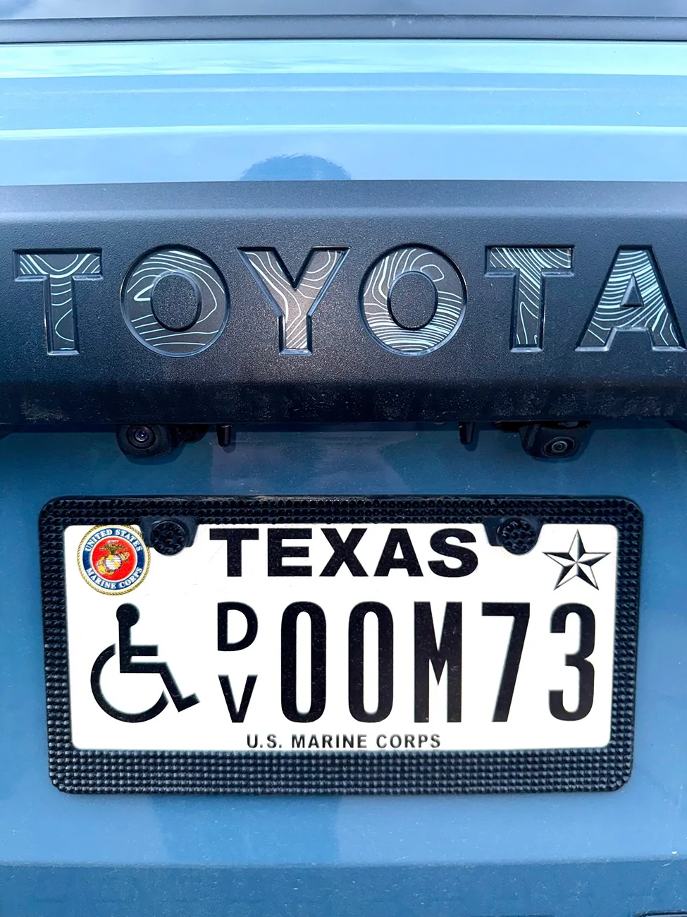

They actually use a separate camera for backup and rearview mirror. I’m trying to find a kit that will relocate the rear view camera up high near the wiper

That camera/mirror is only included with the tow-tech package as far as I'm aware, so I doubt it'll be that simple. It's an extra camera, wiring, and mirror. Probably five other things too lol. If you really want that feature, I know there are quite a few aftermarket setups that would probably legitimately be easier to install and work better (no customization on the baked-in setup).
Mirror removed
Thank you for showing the plugs. I will have to take off the mirror and compare.
