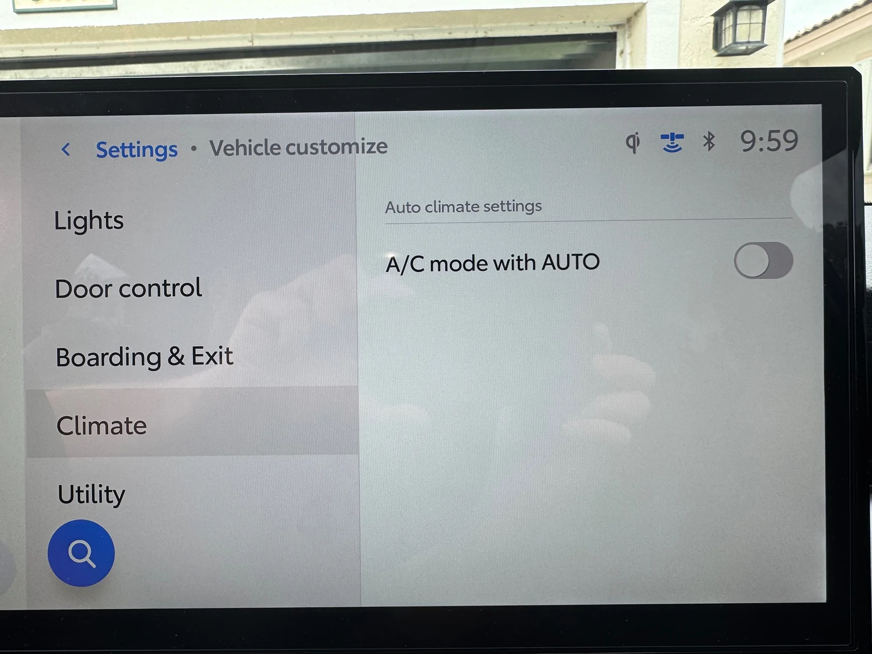

I have mine off. My ac button now stays on
If I turn that button on when I start my car my ac button is off….. EVERYTIME if I turn the button off like it is in my picture my ac button stays ON everytime I start my car. Take it how you will….easy to try yourself
first dont use auto (hvac controls, not the menu box), its sucks but thats my preference. turn off the a/c button and switch the flow to either vent or floor
its weird your works differently.
our 23 tundra and my 14 4R works normal as long as i
1. dont use defrost or windshield
2. dont use auto
it remember the last setting when ignition is off whether its 14 4R or the 23 tundra
now granted i tell the wife to always turn off the a/c before getting home to ensure the system airs out and reduce the chance for musty a/c smell due to just shutting off the vehicle while the a/c is on.
if it continues i would have a tech look into why the a/c is always on when ignition on, it should remember the last setting at ignition off outside of the auto button use

Here's my general summary of the way it works
-- If the AC switch is flicked and the screen shows AC on then its on
-- If the screen is blank but the AUTO setting is on, then the AC is on (can be disabled in infotainment theoretically)
-- If the screen is blank and AUTO is off but the temp is set south of the outside temp then the AC is on
-- If the car is parked in the driveway and your inside watching the game or having dinner just assume the AC is still on
The only way I've found to actually have it off where the fan is on but venting outside air is to hit the AC switch twice so the screen actually says AC Off. If you turn the car off in this configuration it does seem to remember it at next startup. But blink your eyes wrong and I'm sure the truck will interpret it to mean turn the AC back on.
