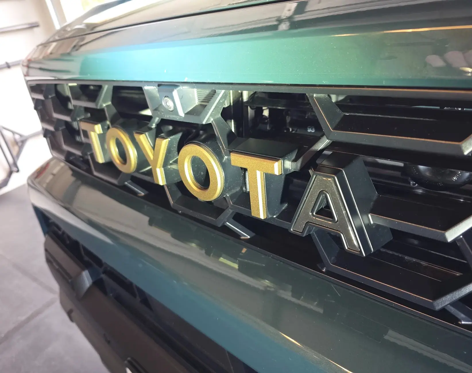

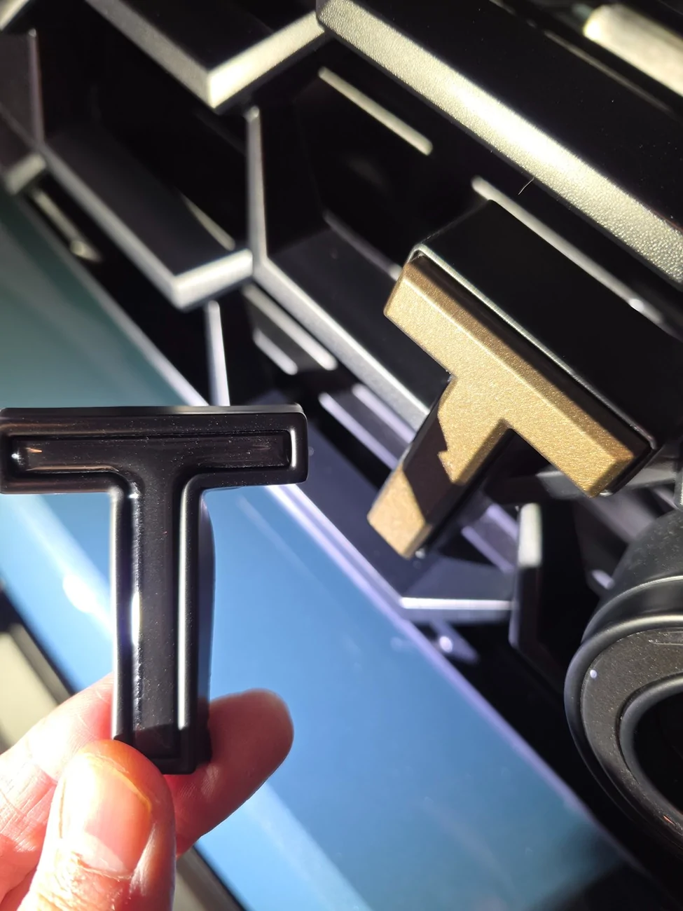

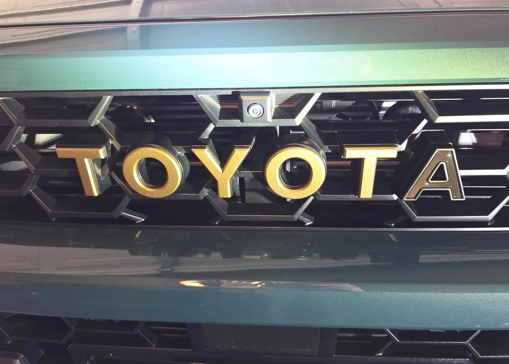

Wanted to make a thread on this because I couldn't find any concrete information on the letter swapping process.
My '25 Trailhunter came with the black reflective lettering on from the port and I wanted the bronze, which I ordered from this thread and picked up today from the dealer. LINK
When I popped off the first letter using a heat gun and a plastic pry tool I was surprised to see the letters underneath were already bronze and look much better than the caps as they stand out more. So I am returning the package I just got from Toyota since I never opened them.
You just have to be careful as the bronze letters are stuck with the same 3M tape in the plastic inlet as the overlays are, so when the overlay started warping a bit from the heat I stopped and used the plastic pry. With a little Goo Gone, the bronze letters underneath look great and the tape holding them in place cooled and seems strong as before.

Wow. Thanks for sharing. They really pop. Looks great!

Thank you so much for posting this, my Everest trailhunter also has the black reflective letters, and I’ve wondered from day one if they were just caps over the bronze letters, but was never brave enough to start prying and popping. The bronze letters look so much better, those caps are coming off tomorrow morning.
talmadge
Timothy
Jun 28, 2025
80
113
SLC, UT
Just as a note to anybody doing this, I discovered the bronze paint on the letters is not very chemically resistant. The solvent I was using to remove the adhesive residue wore through the paint in a couple spots before I realized what was happening and stopped using it. So use something gentle to get it off. Also, the bronze letters are attached to the grille with the same type of adhesive as the caps are to the bronze letters, so it's possible if you're not careful to pull out the entire bronze letter when you're just trying to remove the cap. I wasn't interested in preserving the caps, so I ended up just breaking them off and then heating the adhesive directly with a hairdryer and rolling it off. Looks much better now!
