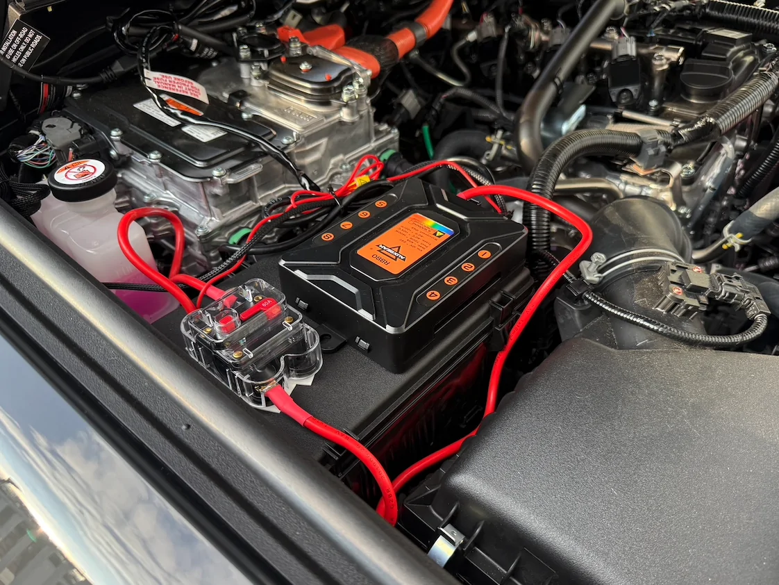

My Fellow 4Runner People,
On the HYbrid engine where do you hook up the main positive & negative cables that run from the battery into the AuxBeam Circuit Control Box under the hood?
The Battery itself is in the rear cargo area on a HYbrid. . . looking for a main positive lead under the hood for accessories, lights, etc. . . .
Thanks in advance.
Update: this is the final install. . . . feel free to ask me anything . . i'd be glad to help

I was looking for the same thing for another light installation… I found this procedure that explain how to get the positive and negative in the engine compartement, for our hybrid version. Cheers!
https://www.bajadesigns.com/wp-cont...ota-4Runner-BTG-Squadron-Kit-Instructions.pdf

Hey Guys. . . i found this. . very helpful is you have a hybrid. . . . .

OK. . . so now i now have a Hybrid System malfunction message on my dash board. . . any suggestions ???

I grounded the negative in the engine compartment and ran the positive cable all the way to the battery in the rear. I didn't want to mess with the fuse box, as some of the other people who have posted on here have. Not willing to potentially void any warranty by splicing/tapping into it.
there are two dedicated positive feeds in the fuse box on the passenger side specifically for accessories & to jump start the car if need be . . . .
Toyota knows everyone like to customize their 4Runners !

Thanks for the information! Can you point out where exaclty?
