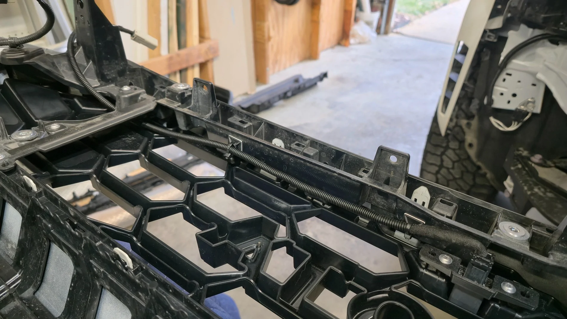

There are several videos out there showing how to remove the front bumper (also the easiest part), so I'll skip that. After removing, I set the bumper face down on a moving blanket on top of two sawhorses. You'll definitely want to be able to put it somewhere that's easy to access.

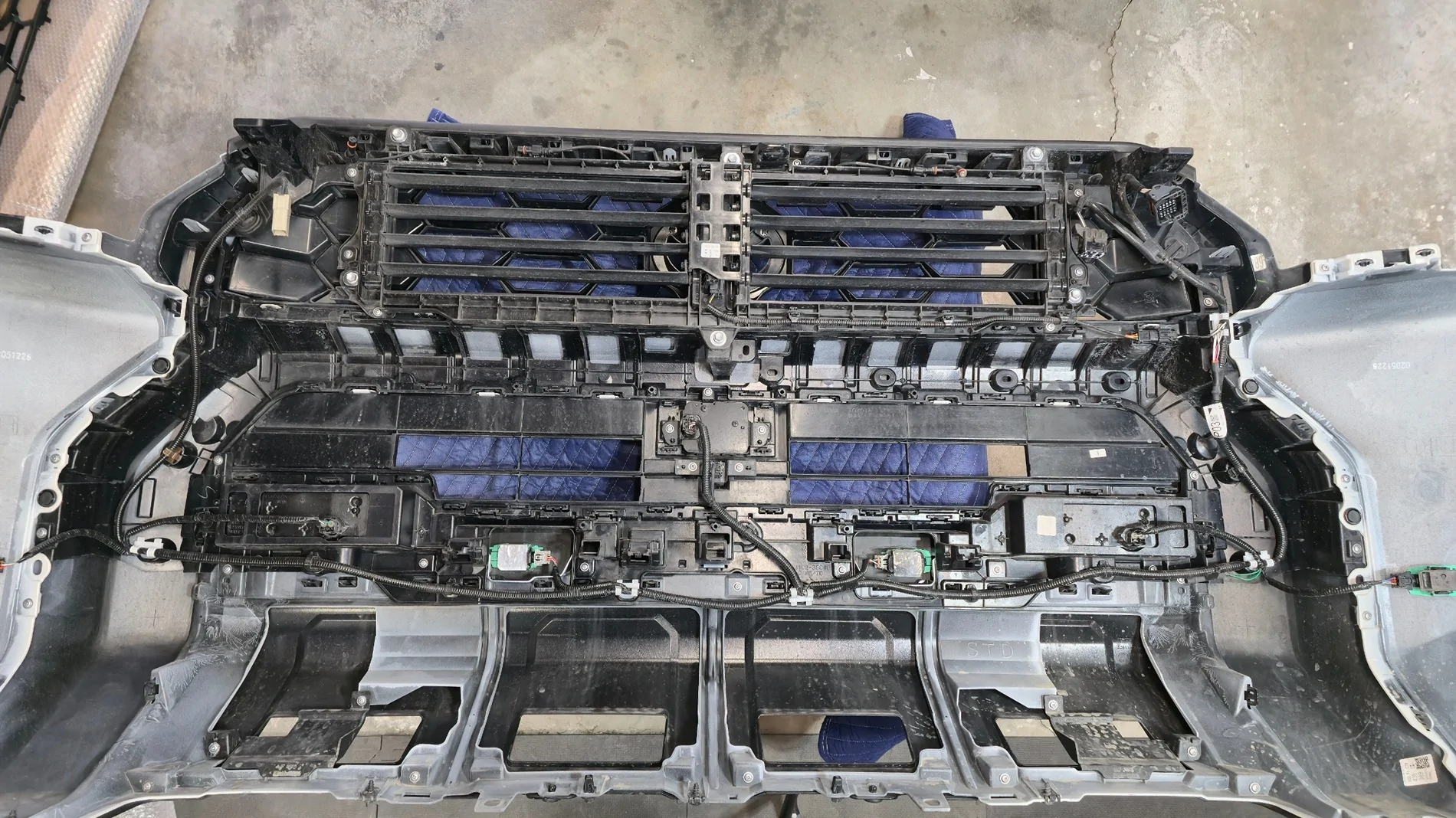

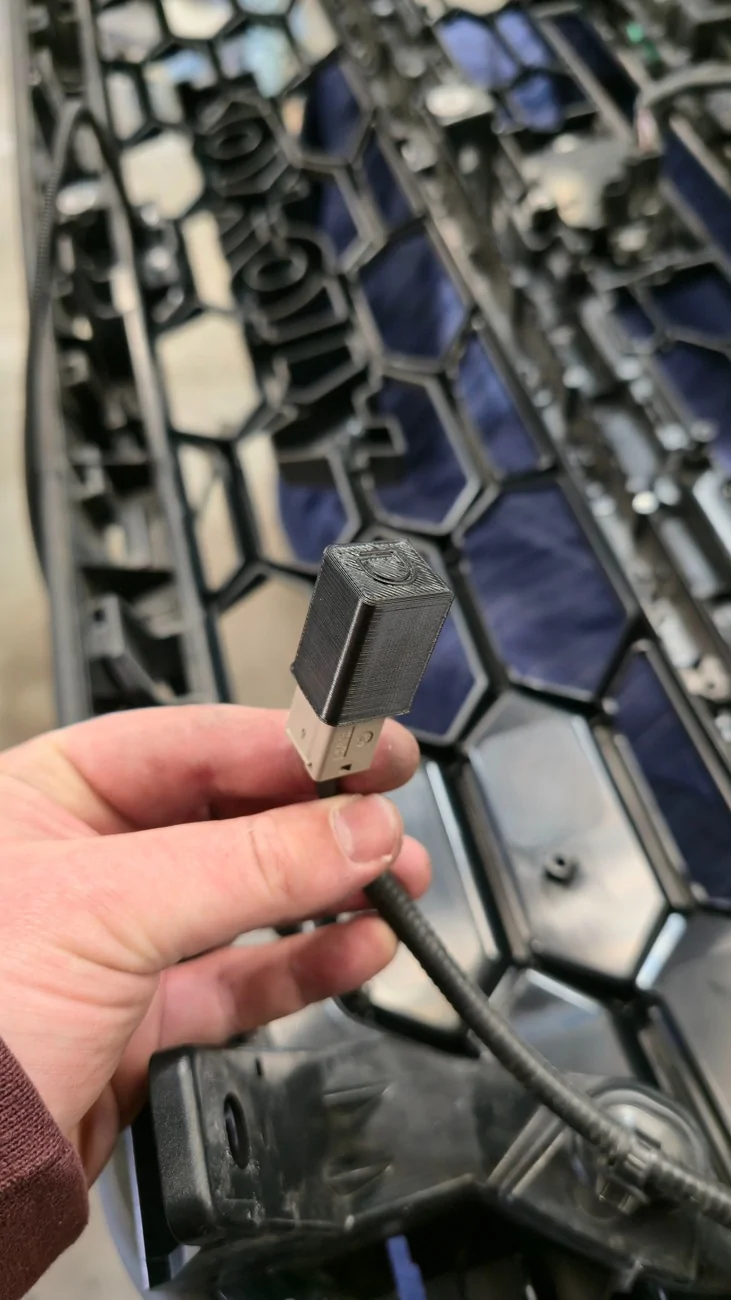

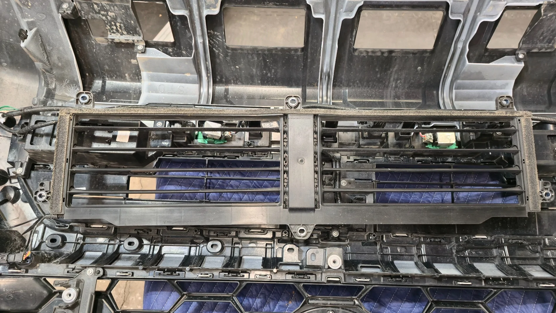

First, remove the active shutters. 6 10mm fasteners. You'll want to fully remove this from the assembly. The clip holding the plug to the assembly is tricky. I ended up mangling mine to get it off after trying to blindly find the hidden release for 5 minutes. The plug itself was unscathed. After fiddling around trying to do the swap in sections, I realized that you need to remove the entire large black assembly. The grille sections are sandwiched between this frame and the bumper cover itself. There are roughly 32 Phillips head screws holding this on, as well as endless clips. Trim removal tools and a small flathead screwdriver are your friends here. I also suggest removing the outer sections of the bumper to make it a little easier to maneuver, it's just a couple extra clips on each side.

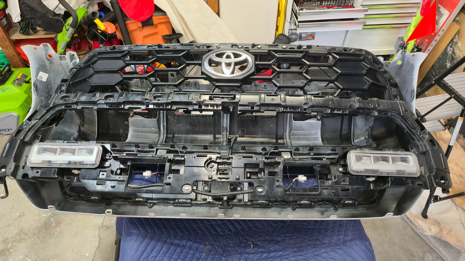

Once you tediously work your way around all the clips, you can separate the bumper cover from the inside assembly. Don't forget to disconnect all the sensors before trying to separate everything. You can continue your unclipping journey to separate the grille sections from the assembly. The Diode Dynamics kit provides plug dust covers for the camera plugs since it will be relocated to the upper grille and use a new harness. They also include a new camera bracket.

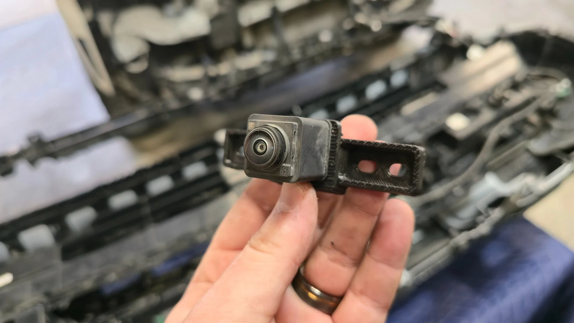

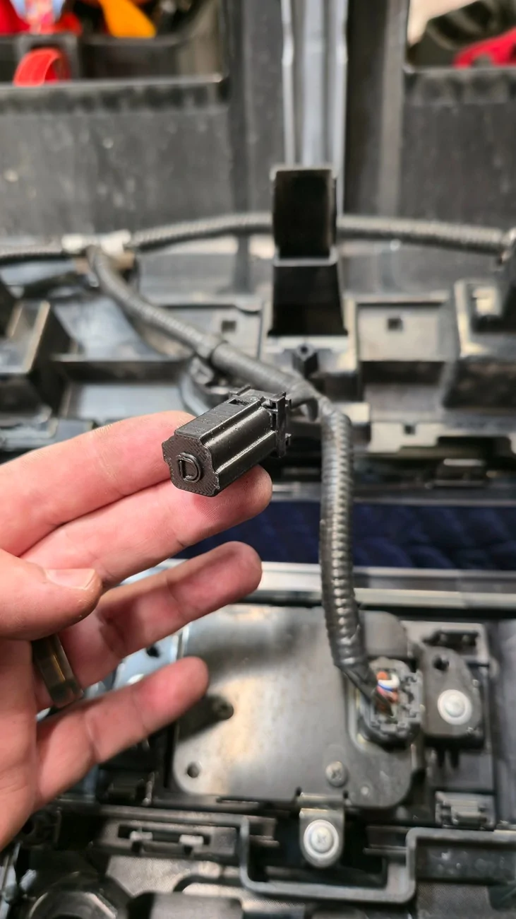

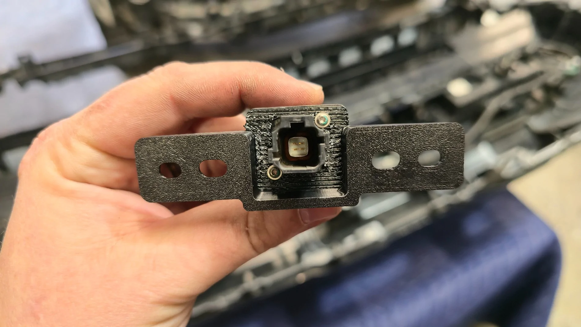

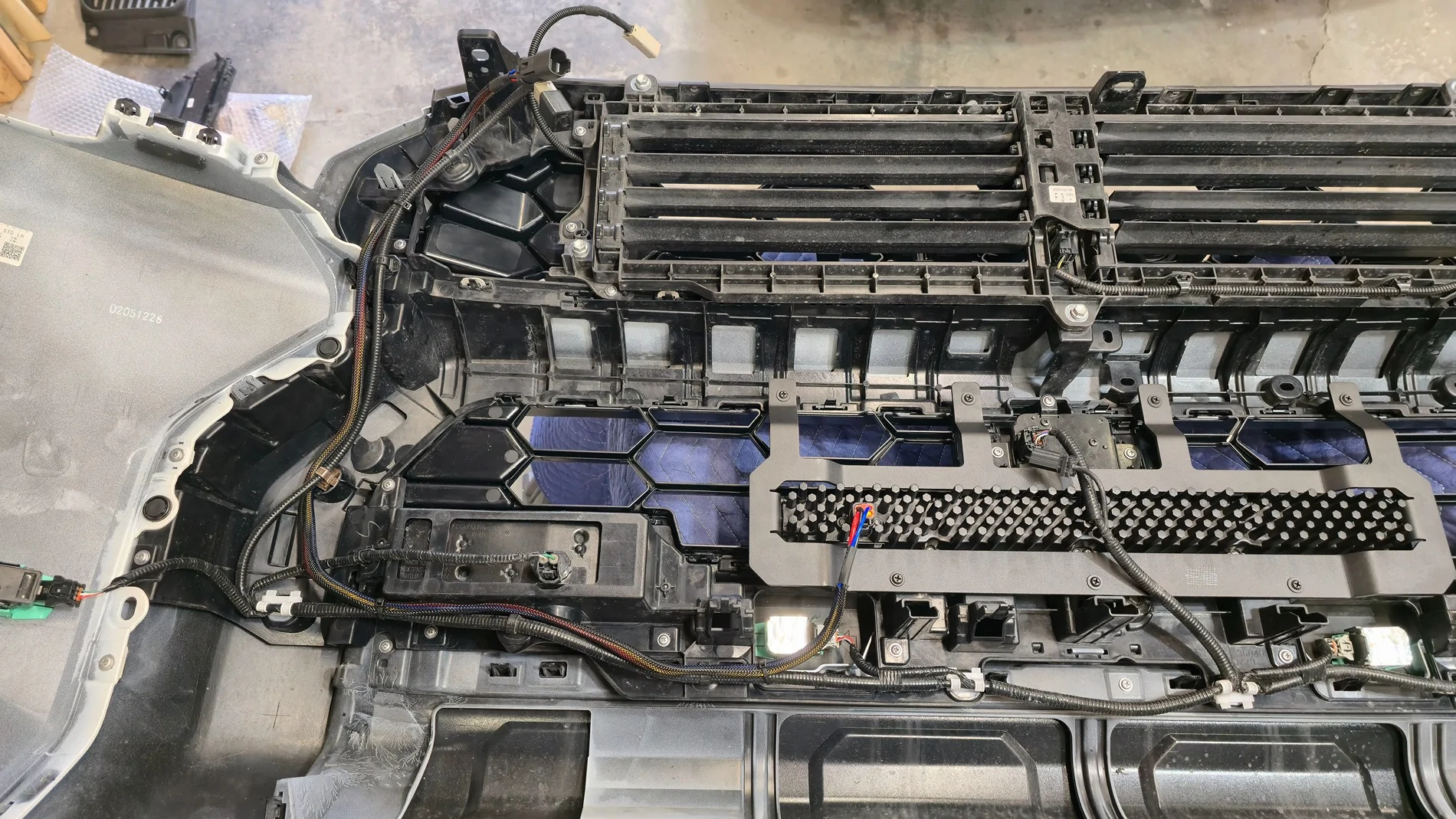

The TSS module gets relocated to the new lower grille section along with the original cover. Pretty self explanatory there. After you get the camera and sensor swapped over, you can start clipping the new grille sections into place. After you get it all clipped in, you can start getting the inner assembly mated back to the bumper cover and the outer bumper sections if removed. I broke a couple clips during this process, so just take your time and don't rush it back together. Install the new camera harness before reinstalling the shutters. Secure the harness so that it won't interfere with the shutters.

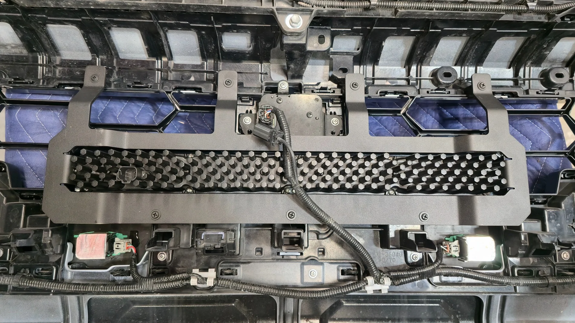

Reinstall all of the silver Phillips head screws. Reconnect all the sensors you previously unplugged. The bracket for the Diode Dynamics bracket screws into factory blank holes in the bumper cover. Install the light bar into the bracket before installing the bracket. It won't fit if you try to install the light bar afterwards. You'll need to clip the zip tie attaching the harness for the TSS sensor before installing the bracket and light bar.

The bolts for the light bar are accessible after the bumper is reinstalled, so don't worry about getting them too snug at this point. I routed the light bar harness along the OEM sensor harness.

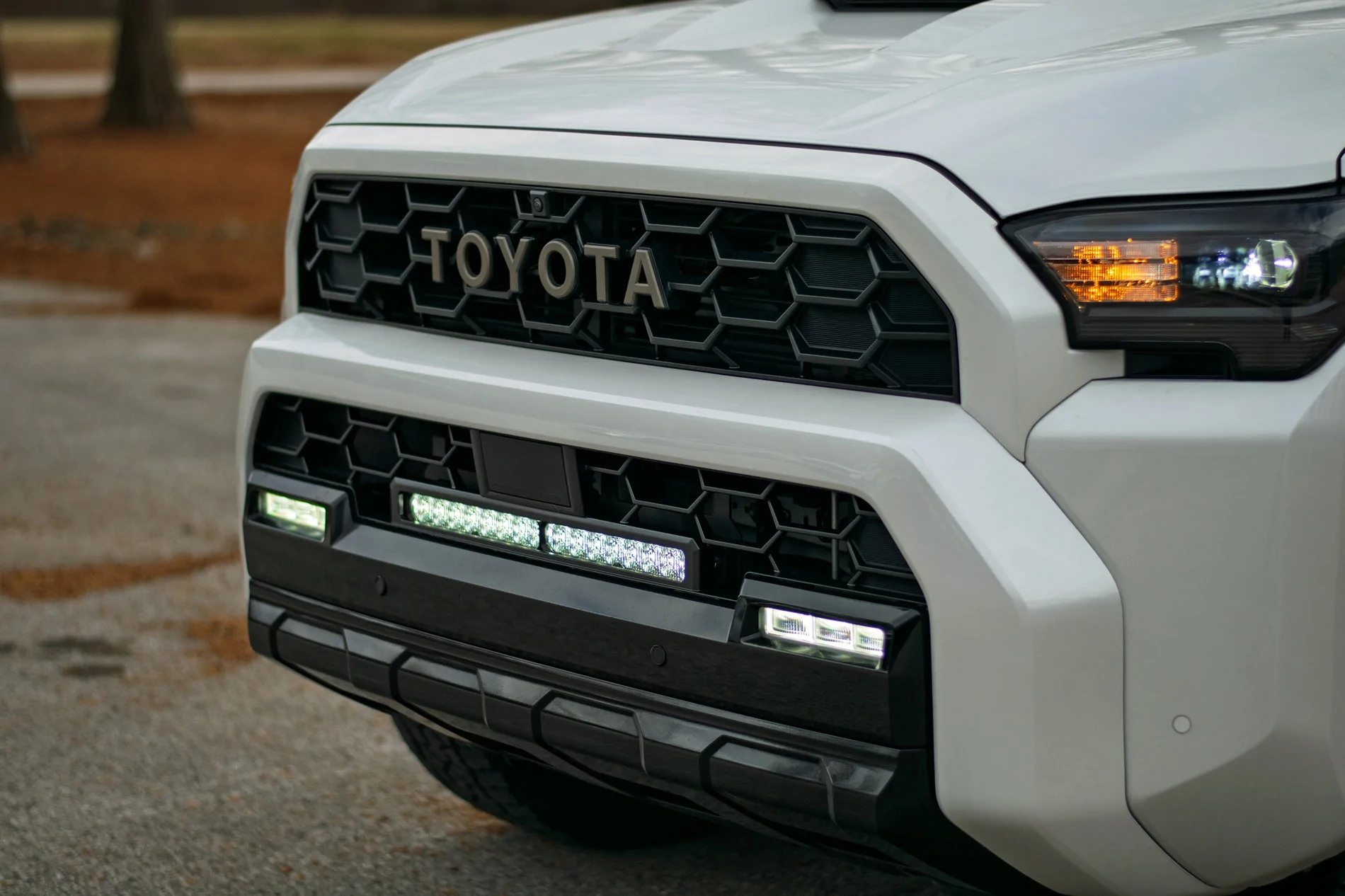

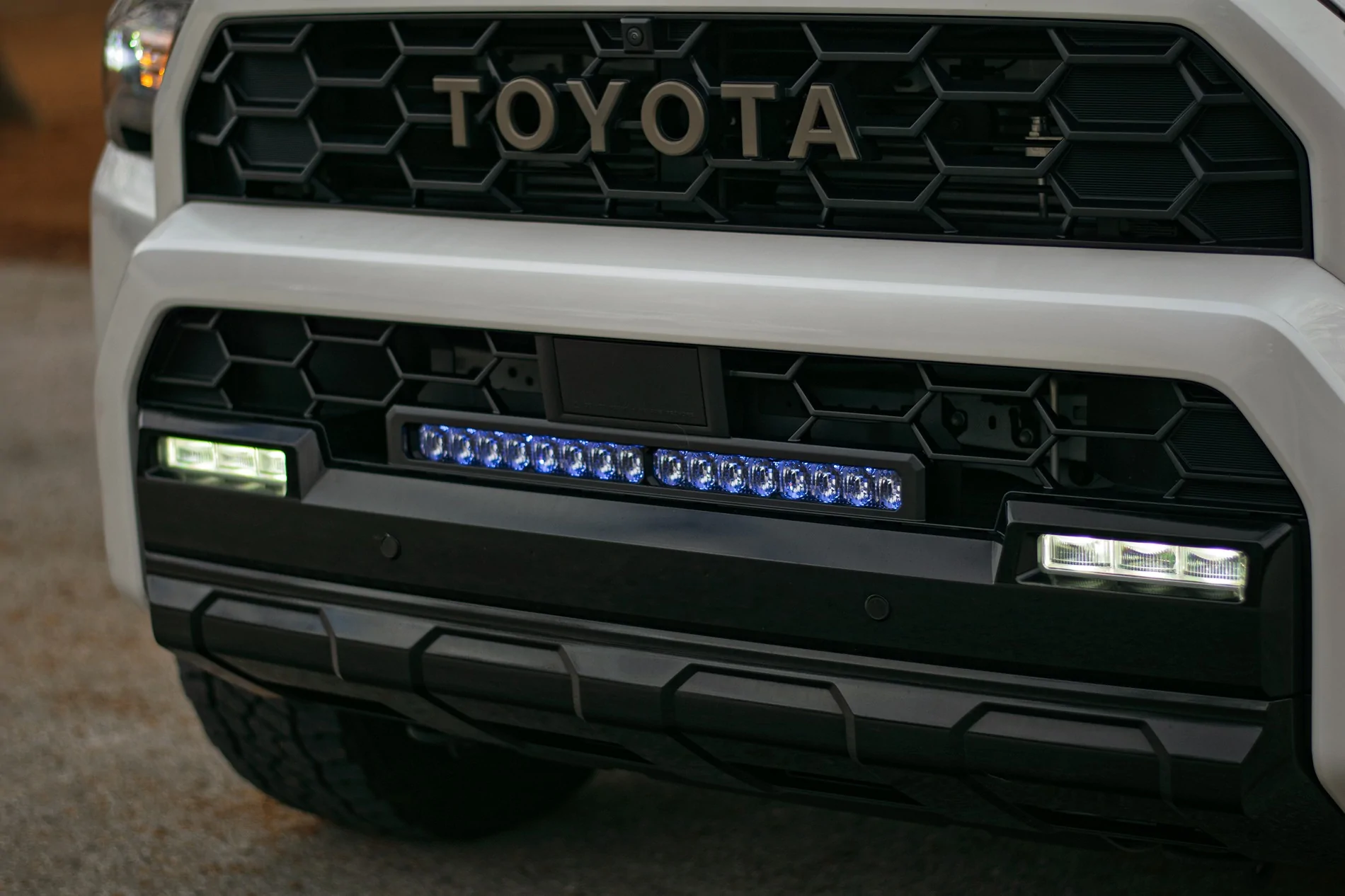

Install the provided harness for the light bar as you see fit. I am personally running OEM style switches from StickerFab for my ditch lights, so I spliced the new harness into what I already had set up.

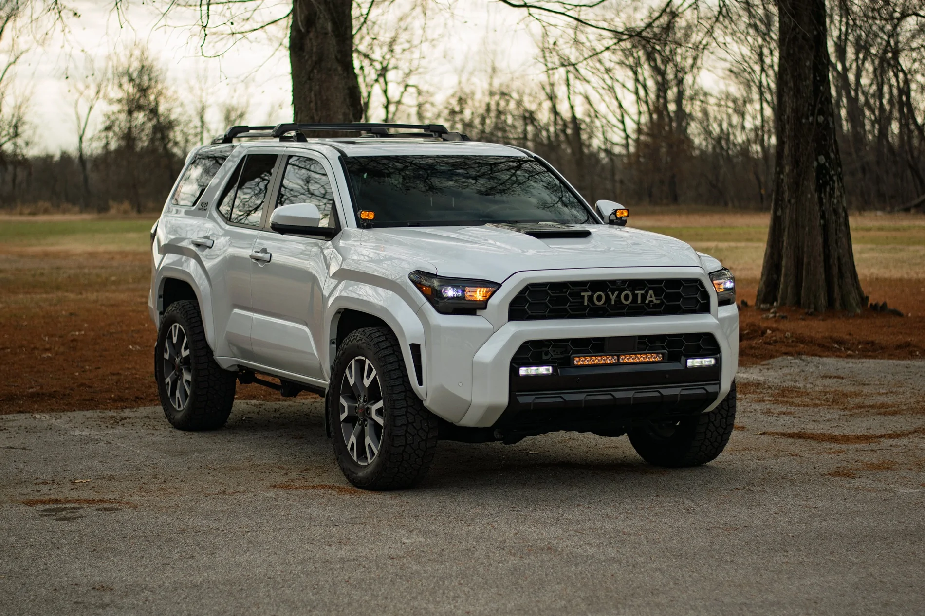

Overall, this took roughly 5 hours for me from start to finish. If I had to do it again, I could probably shave an hour off knowing what I know now.

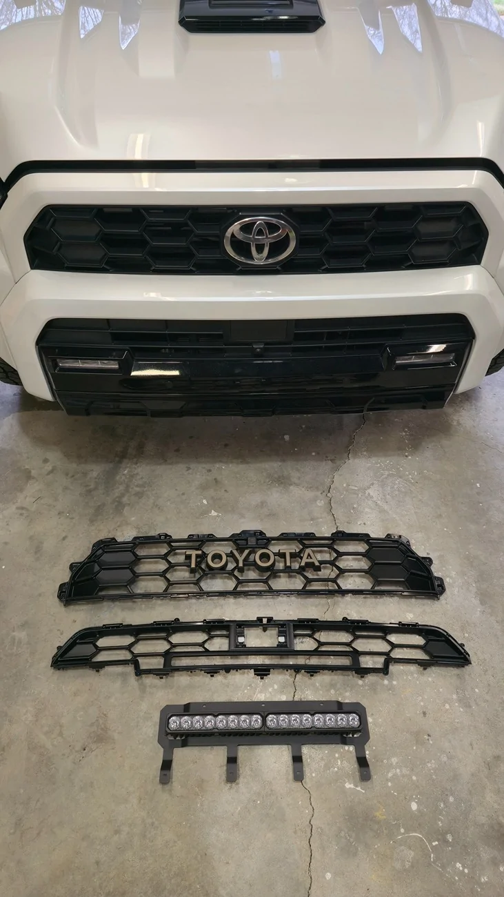

amazing! Looks like the light sits flush with the grille opening, exactly what I was hoping to get with the rave off-road setup. For anyone reading this that wants a flush, oem+ look, do NOT go with the rave kit. Be smart like @ngfilla94, not dumb like me. Also makes me regret getting rid of my white 6th gen… okay, going to go cry in a corner now while I rethink my life choices.
It sits pretty close to flush. The light bar is slightly larger than the opening so it can't sit fully flush with the front. Not sure how the Rave kit looks but the fit on this is great.

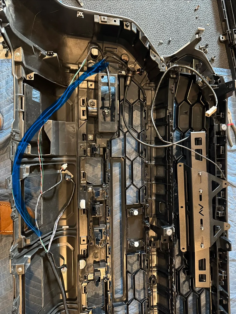

The diode dynamics kit sounds amazing but worst case you can reroute your existing camera cable. It was pretty easy honestly.
I got carried away with mine, I think you really only need to back it up along the blue line.

If you don't mind me asking, what switch are you using? And what did you do about the backlight? I thought about trying to tie into the headlight so the backlight comes on with the headlights, but I hesitate to mess with the OEM wiring.
I'm using two OEM Style switches from Stickerfab. One for the backlight and one for main beam. I have my ditch lights tied in to the same two switches as well.
