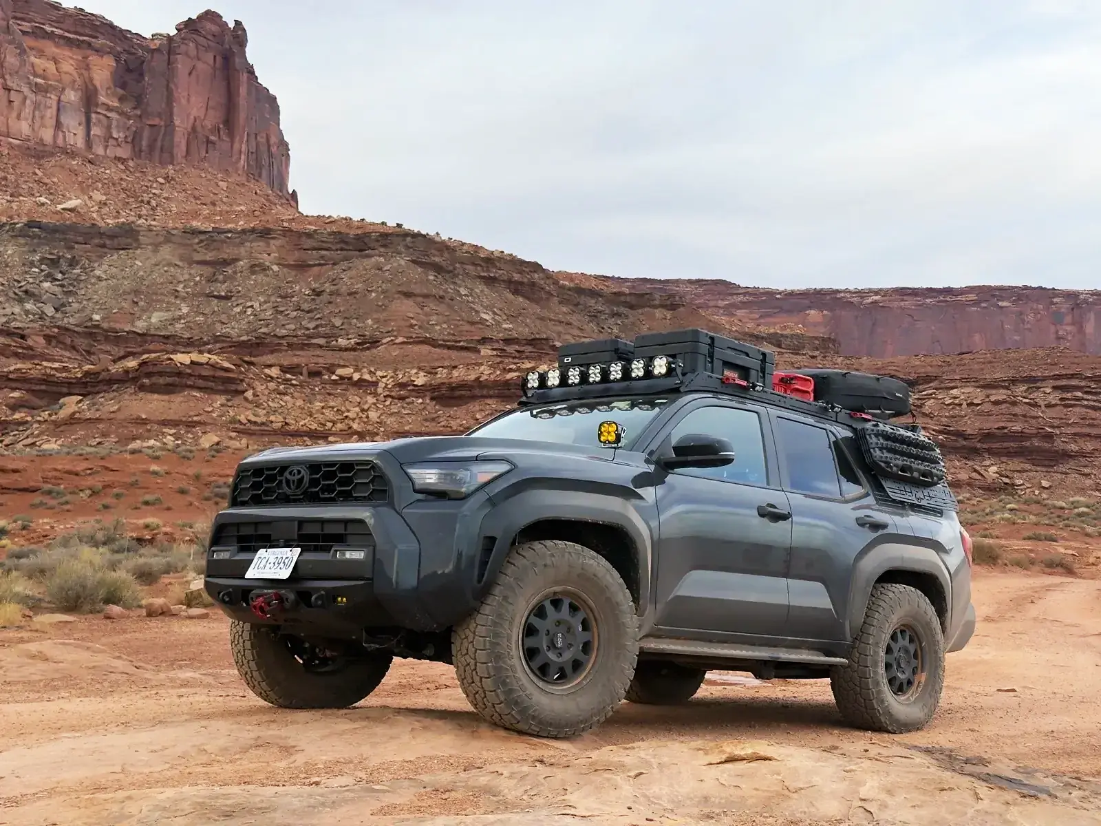

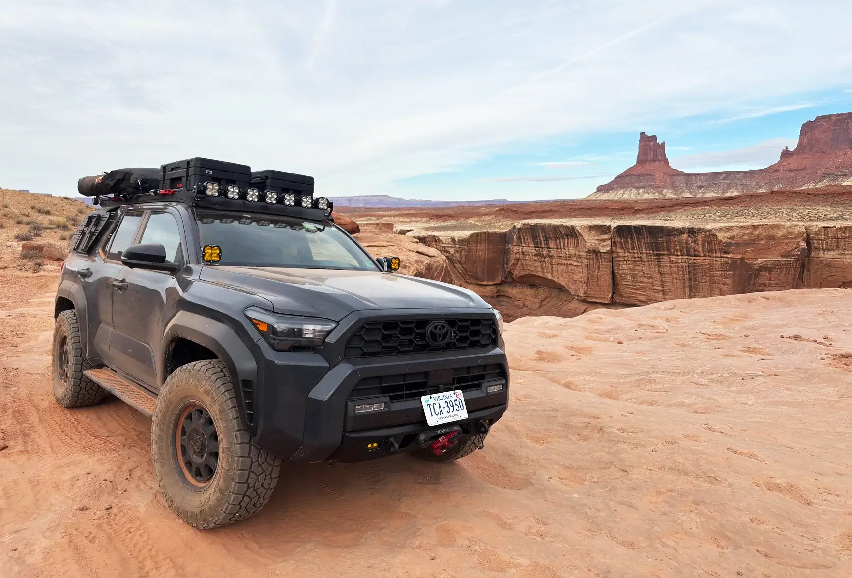

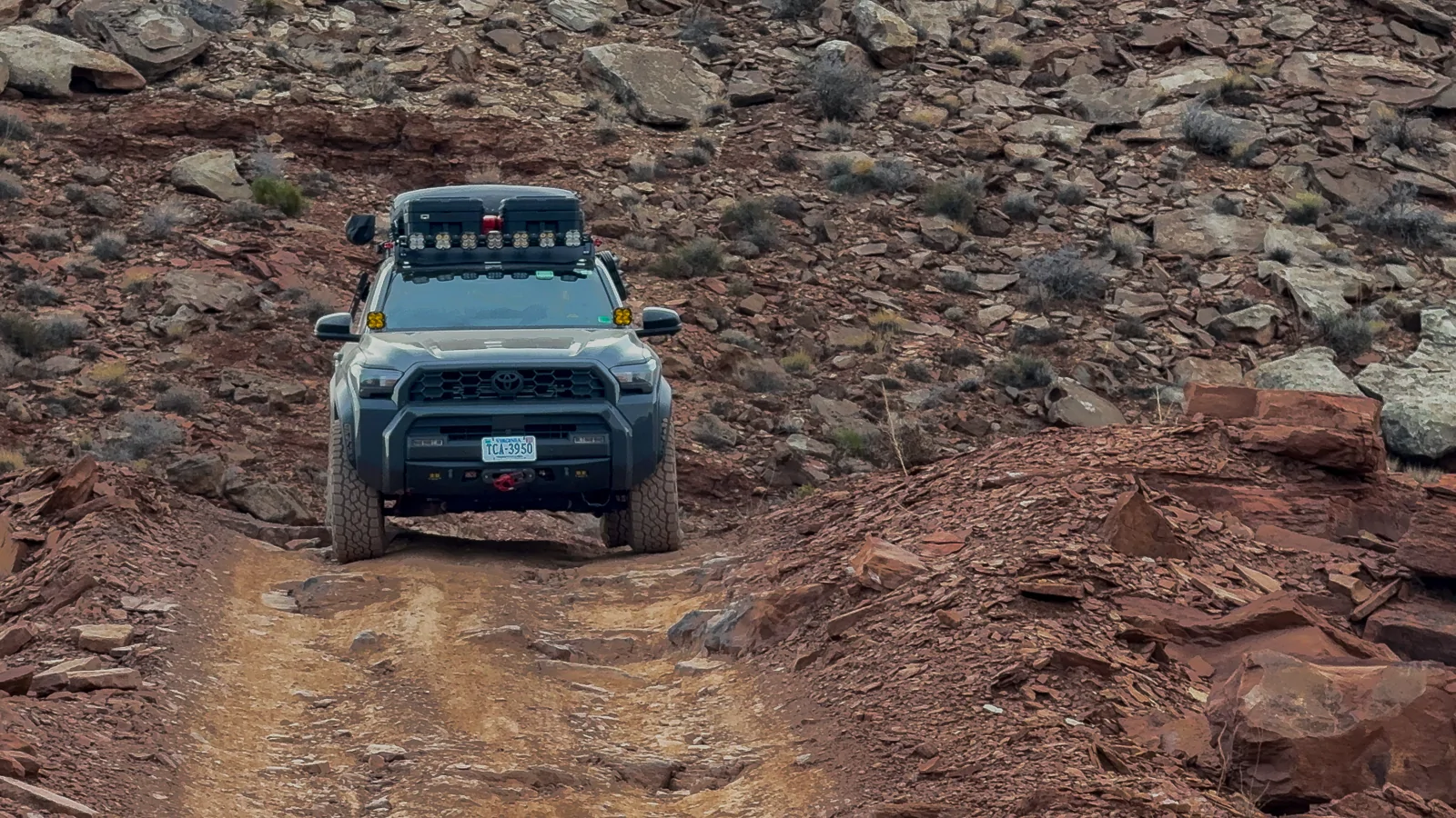

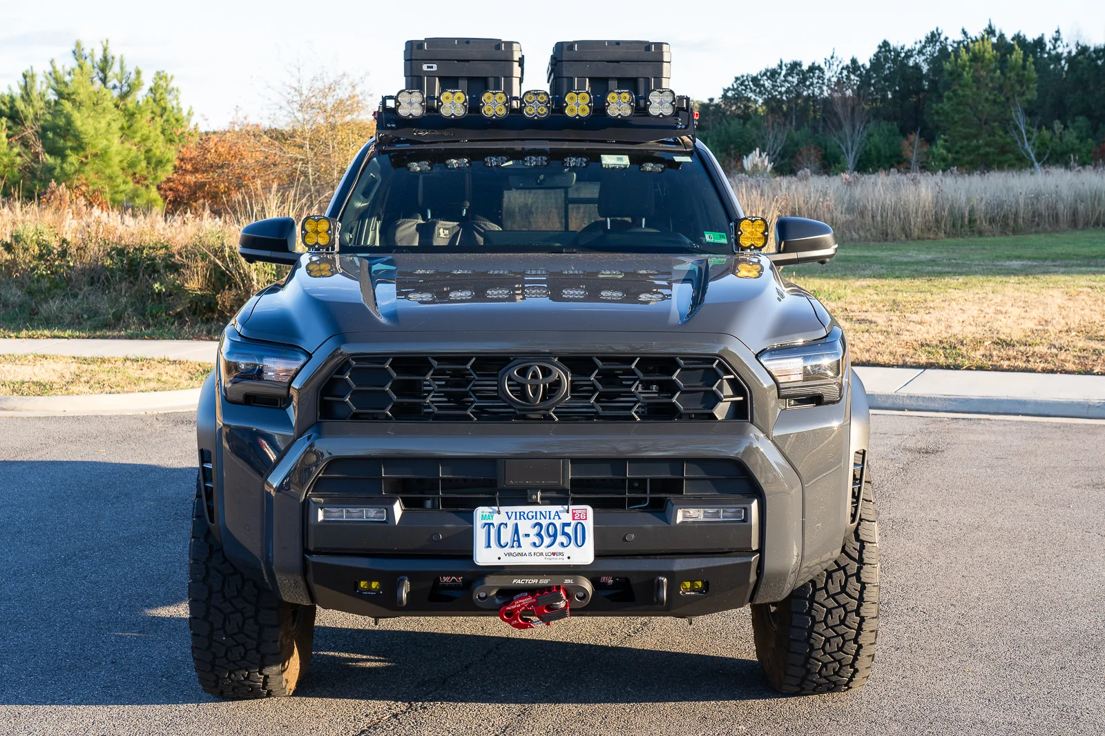

Hey everyone,
Got my ORP back in March and after spending some time with it, decided to make some mods/upgrades. This is my daily driver and also what my wife and I will use for our once or twice per year trips. In fact, we just spent 10 days camping in SE Utah earlier this month. The 4Runner has been a lot of fun and we made good use of almost everything on this trip (except the winch and other recovery gear, thankfully)!
Here's what I started with:
2025 ORP (non-hybrid)
2025 2026 4runner 6th gen My first 4Runner:  2025 ORP (Underground) build 8ad1d8a2-6bb5-457b-a85a-f3f39bd5e6
Here's what I've added:
Westcott Lift Kit
17" Black Rhino Stadium +35 offset wheels
35x12.5 Toyo AT3 tires (35's / 35")
Prinsu Pro Roof Rack, window panels, and ladder
Cali Raised internal molle panels and shelves
CBI low profile front bumper
Warne EVO 10s winch
ARB dual compressor w/ Bullet Proof Fab. mount
BD XL linkable light bar
BD XL ditch lights
BD SAE fog lights (in bumper)
BD S2 Sport scene lights
Garmin PowerSwitch + Blaze Offroad wiring harnesses for lights and compressor
Dirtcom TrailSwing tire carrier
RCI rock sliders
RCI skid plates
As far as plans for future mods, I've got some more SAE fog lights that I'll swap in for the factory fog lights. I'll do that at the same time the Trailhunter front grille comes in :).

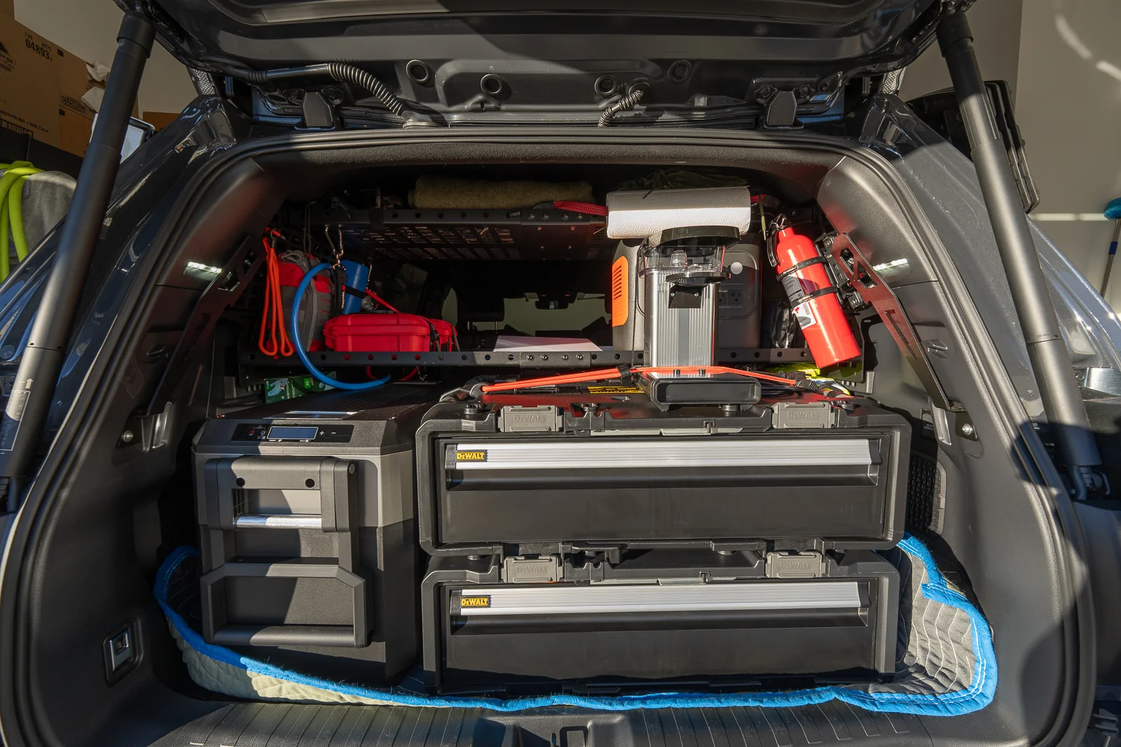

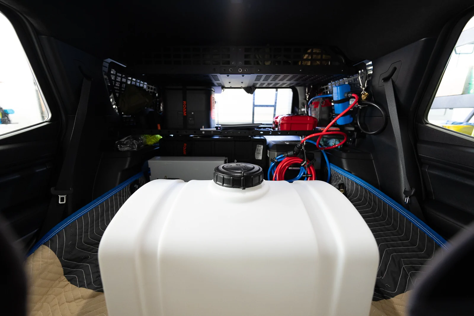

A couple photos showing our camping setup inside the truck:
2025 2026 4runner 6th gen My first 4Runner:  2025 ORP (Underground) build ILCE-1_2025_11_28_131253
The water tank is a 26 gallon. I've got it connected to a pump that splits the water to both my Joolca water heater for showering, and a cold water line for drinking water to fill our water bottles. Behind it and on the sides is quite a bit of empty space where we'd normally have a duffel bag with our clothes and a smaller toiletry bag. There's also a portable toilet folded up (grey colored object just to the top left of the water tank in the photo).
2025 2026 4runner 6th gen My first 4Runner:  2025 ORP (Underground) build ILCE-1_2025_11_28_131255
Not as slick as the custom fabricated slide outs and drawers, but this setup does what I need it to do. The drawers have our kitchen stuff, food, and propane. The only mod I'd like to do for this area is run DC power so I can plug in the Jackery and have it charge while we're driving.

Incredible first 4Runner build man. :love:
What offse are your Black Rhino Stadium wheels?

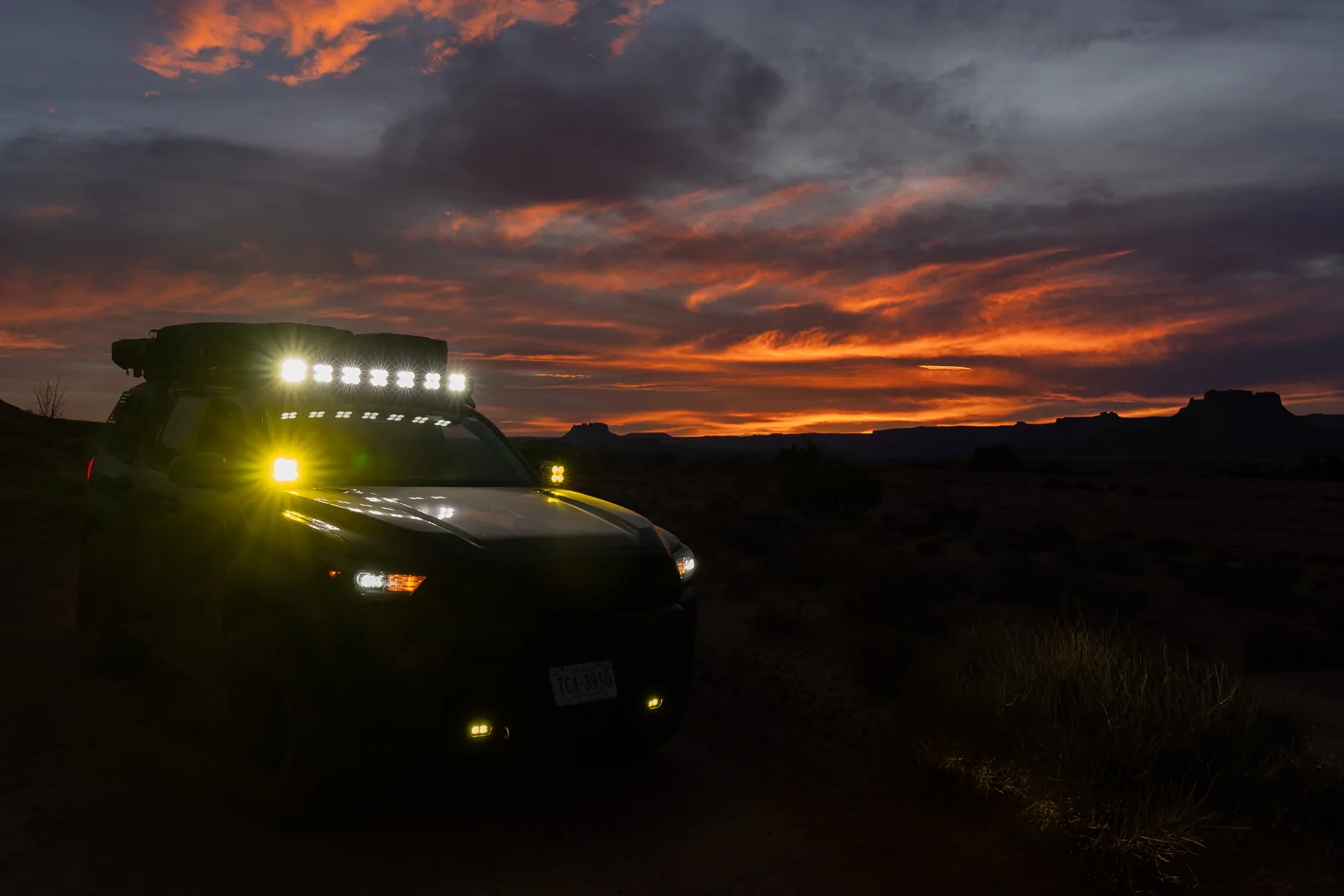

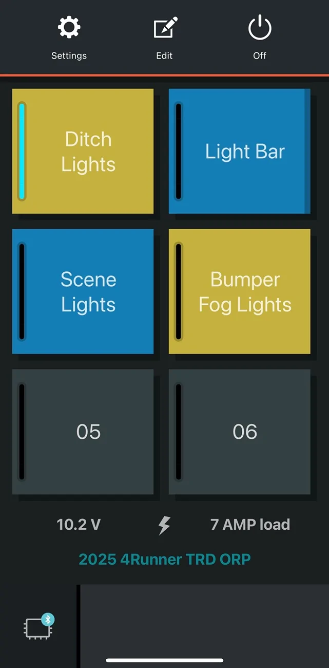

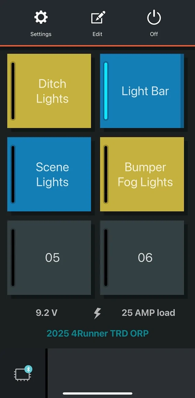

Wow! That looks great. Have a quick question on your power draw for your light bar and ditch lights. Have you checked what kind of power draw you have on that when they are on? Just wondering if you have another power source for them. If it's too lengthy of a question I understand. Thanks in advance.
VB4Runner
Mitesh
Nov 26, 2025
80
144
VA
2025 TRD ORP
No problem - easy question! The light bar draws about 25-27 amps, and the ditch lights draw 6-8 amps. I haven’t given any thought to an alternate power source, primarily because I don’t expect prolonged use of those lights when driving, and I’d never use them when the vehicle isn’t running.

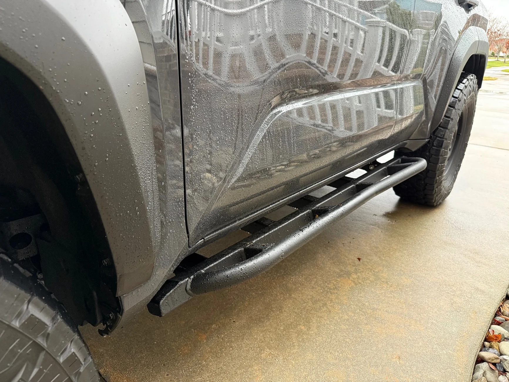

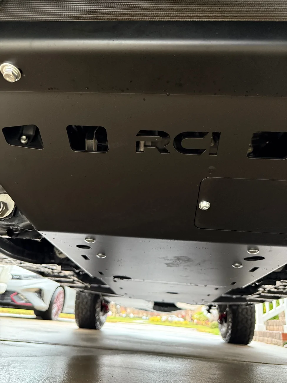

Couldn’t resist the Black Friday sale over at RCI… rock sliders and full skid set installed today.
Sorry for the poor quality photos)

Can you set the Cali Raised internal Molle shelf to any height? On their website it looks like there’s specific mounting holes placed at the very bottom of the side Molle panels, but it looks like you have yours a little higher.
Thanks!
VB4Runner
Mitesh
Nov 26, 2025
80
144
VA
2025 TRD ORP
Sweet build man!
Thanks!
Thanks! There are two sets of mounting holes for the shelf. The top set puts the shelf at about 20” off the cargo floor (this is where mine is set), and the bottom would put the shelf at about 18”.
