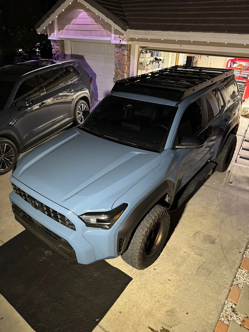

10/19/25

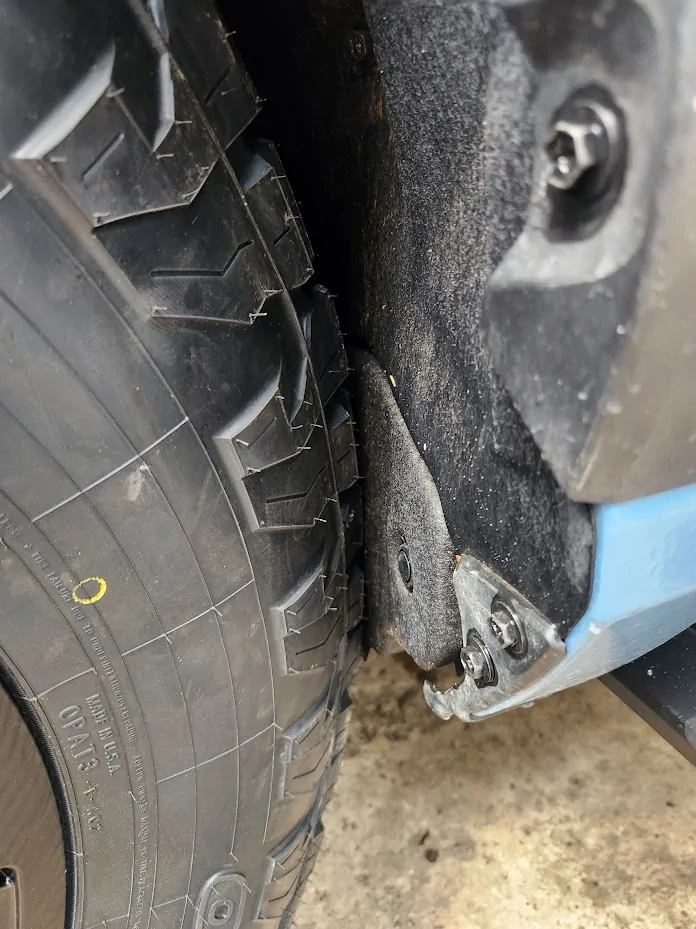

I got some Rays Volk TE37 (-10 offset) on 295s and I was rubbing on stock suspension… was kinda bummed lol. Definitely need to lift this bad boy
2025 2026 4runner 6th gen AJ123's TRD ORP Build on TE37 -10 Offset and Toyo Open Country R/T 275/70/17 tires IMG_8901
2025 2026 4runner 6th gen AJ123's TRD ORP Build on TE37 -10 Offset and Toyo Open Country R/T 275/70/17 tires IMG_8916
2025 2026 4runner 6th gen AJ123's TRD ORP Build on TE37 -10 Offset and Toyo Open Country R/T 275/70/17 tires IMG_8919
2025 2026 4runner 6th gen AJ123's TRD ORP Build on TE37 -10 Offset and Toyo Open Country R/T 275/70/17 tires IMG_8905
10/22/25
Fast forward to today. I kept the 295s for future use & I had to throw 275/70/17 Toyo Open Country R/T on and I rub VERY minimally compared to before. Now she’s ready for some driving 🙏🏽

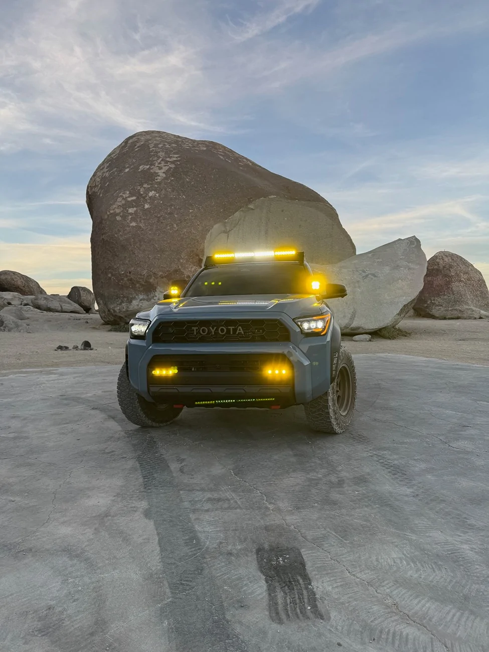

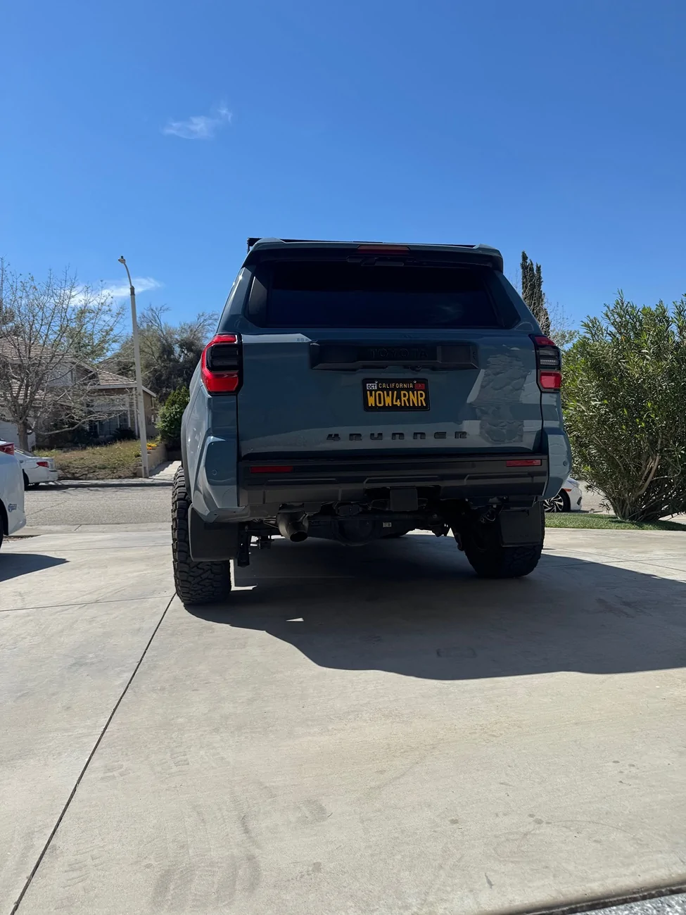

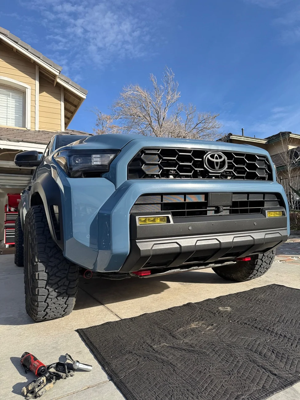

UPDATE 3/22/26!
It's been a LONG couple months. Nothing but installs and goodies.
- Alpharex Headlights NOVA Series Alpha Black
- Alpharex Double Tab Foglights
- Toyota Heritage Bronze Grill from Trailhunter
- Sherpa Roof Rack
- Diode Dynamics SS40 SmartSelect Light Bar
- Diode Dynamics SS3 Ditch Lights
- Diode Dynamics C2 Chase Lights
ORDERED FROM OVERLAND EXPO SOCAL and awaiting install!
- MaxTraxx Boards
- Molle Panels
- Roam Case
- Kammok Awning
- DWOS Shovel

They look great, but am curious what offset those Volks are. Offset makes (as I think I understand it*) a big difference re: rub. Your 275/70/17 = 32.2" are 0.4" less diameter than stock 265/70/18 32.6"(and 10mm wider, which matters). But surprising to for you to report even minimal rub on a smaller diameter tire - and I am trying to learn how much offset matters in this mix.
I ask because although most of the Volk TE37 17" wheels have positive offset, if you've got one with low positive (+20 or less) or negative offset that can aggravate the rubbing (I think).
The rest of this post is just my personal experience for context:
I've got Toyo A/T III 285/70/18s (33.7" dia.) on TRD Pro 18x8.5" +20 inch wheels with the Peak 1.25" leveling spacer. I was able to make them fit by removing crash plate and bending up the tab for the outer screw on the air dam. Here are shots of just touching the air dam screw (before removal) in front and crash plate cover (before removal) in rear.

Just rubbing on full locking turns and just reversing due to hitting the bolt on the front bumper. Driving straight was perfect though. Wanted 275 to have a peace of mind, i still rub on reverse while on a full locking turn but its managable lol
