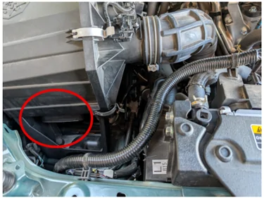

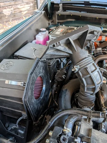

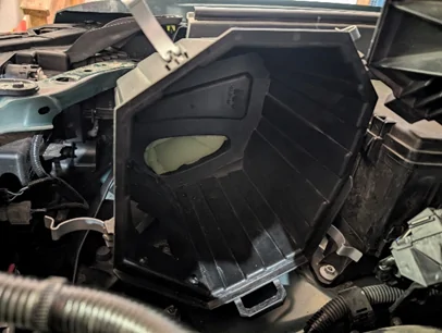

  1. Unclip the four clips and move the air box cover to the side. (pic #1) Helpful hint: Use a small bungy cord to hold the air box cover out of the way.
  2. Remove air filter.
  3. Insert an oversized oblong shaped piece of foam (4” bedding foam works great) into the snorkel inlet (pic #2).

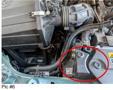

  4. Remove black cap from the lower outside of the air box (pic #3).
  5. Reinsert air filter and secure air box cover.
  3. Remove the air box by simply pulling the air box straight up and out of the snorkel inlet. The air box is held in place by three pins and is very simple to remove and reinstall.
At this point you have two methods (4A or 4B) to plug the snorkel:
4A. Insert an oversized oblong shaped piece of foam (4” bedding foam works great) into the snorkel inlet (pic #2). Go to step 5 below.
OR

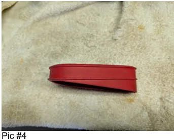

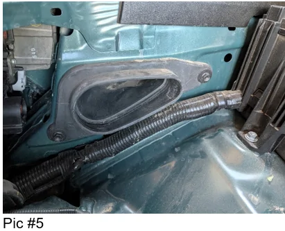

4B. a). Using the red plug that comes with the Coupling Kit, (pic #4) plug the air box snorkel inlet.
b). To make room for the red plug when reinstalling the air box, you need to remove two bolts and the elbow going through the fender wall (pic #5).
5. Remove black cap from the lower outside of the air box (pic #3).
6.Connect red elbow that comes with the Coupling Kit to the air box, same point that you removed the black cap.
7. Reinstall the air box by lining up the pins and pushing the box down into place.
8. Reinsert air filter and secure air box cover.

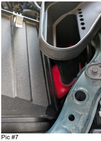

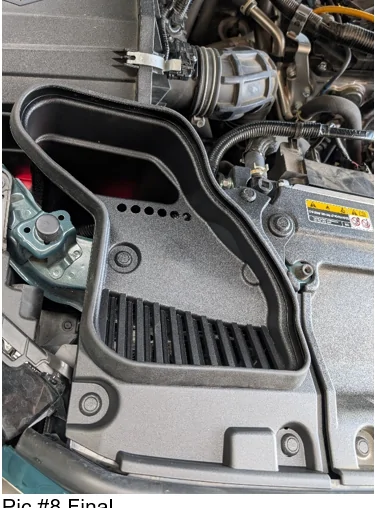

9. Remove a small plastic support held in place by two clips (pic #6). Helpful hint: The clips can easily be removed by depressing the center of the clip then pulling them out. These clips will be reused.
10. Install Inlet, Air Cleaner by lining it up with the red elbow and installing a total of 5 clips. (pic #7 & #8).
