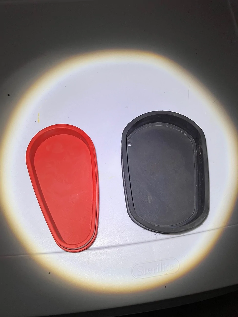

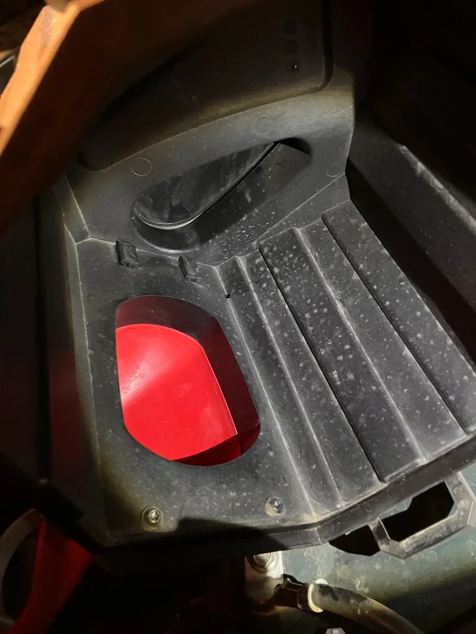

Here is an update on this mod :
- A tip for anyone doing this: there is a small plastic cover that needs to be removed that gets replaced by the " basket" assembly. To do so it will require removing and replacing 2 of the snap cap things. Just push on the middle of them to release and once out "rest" them with your nails.
- the black cap is the one existing on the air box and the red one comes with the TRD elbow.
- The elbow itself seems to be "impossible" to fit without removing the airbox, but at the right angle it works its way in there and fits like a glove. Then then goes in the " basket" and snap clips.
I still plan on making a cap that I can block the "noise" from the inside of the air box when "needed". For now I am running them both open and did not notice a difference on sound or performance. Only a few days int it.

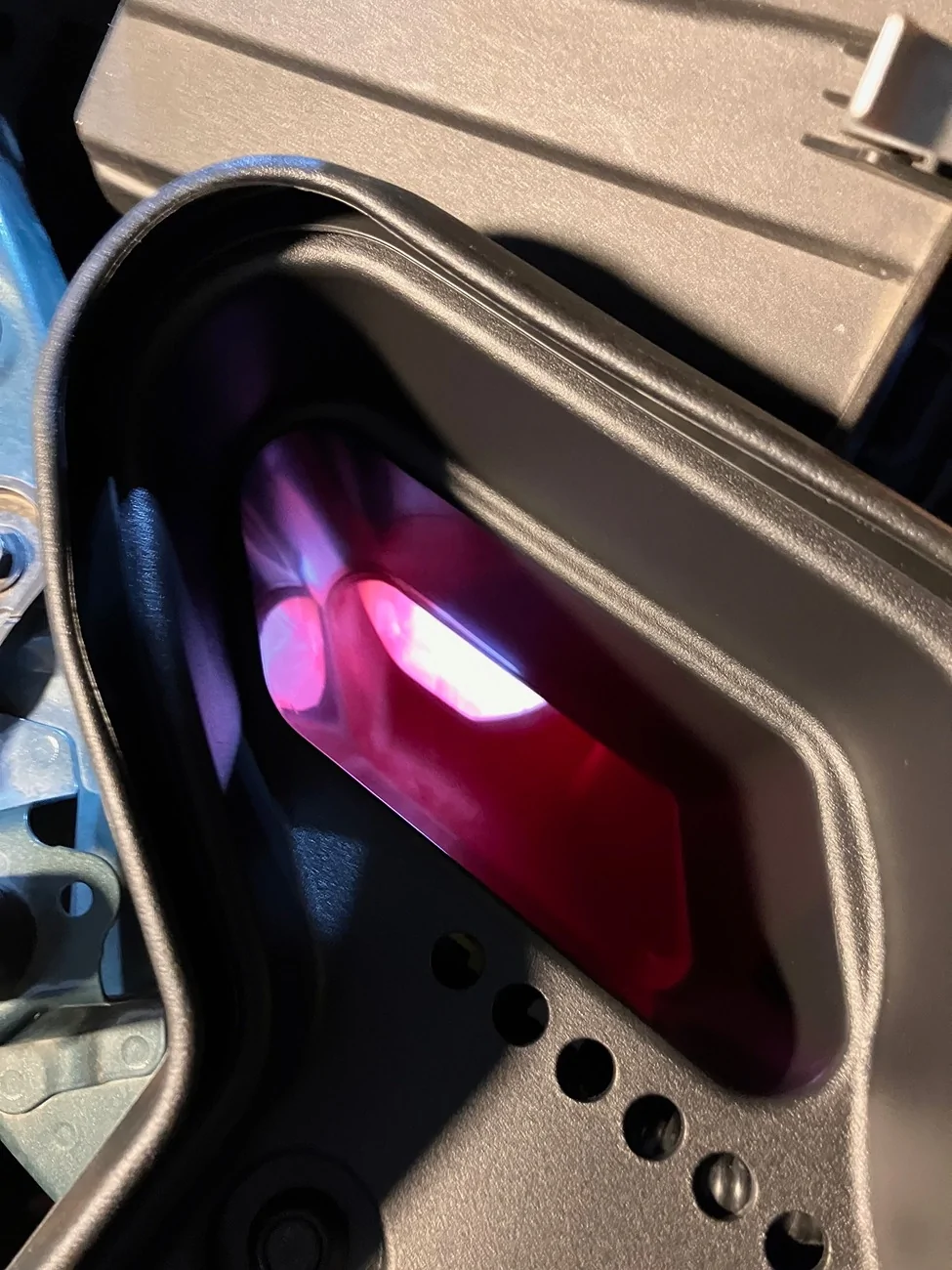

If you like the Trailhunter, but don’t like the snorkel noise, this post is for you. This post builds on many other threads on this and other forums.
Here are two options to eliminate the Snorkel noise:
Option#1: Plug the Snorkel
Steps:
  1. Unclip the four clips and move the air box cover to the side. (pic #1) Helpful hint: Use a small bungy cord to hold the air box cover out of the way.
  2. Remove air filter.
  3. Insert an oversized oblong shaped piece of foam (4” bedding foam works great) into the snorkel inlet (pic #2).
  4. Remove black cap from the lower outside of the air box (pic #3).
  5. Reinsert air filter and secure air box cover.
Pros:
  • Simple, requires no tools, 10-minute job.
  • Can be reversed in minutes.
  • No air restrictions, gain the 3HP lost due to the snorkel.
  • By plugging the snorkel at the air box, you eliminate the ‘echo’ sound in the snorkel.

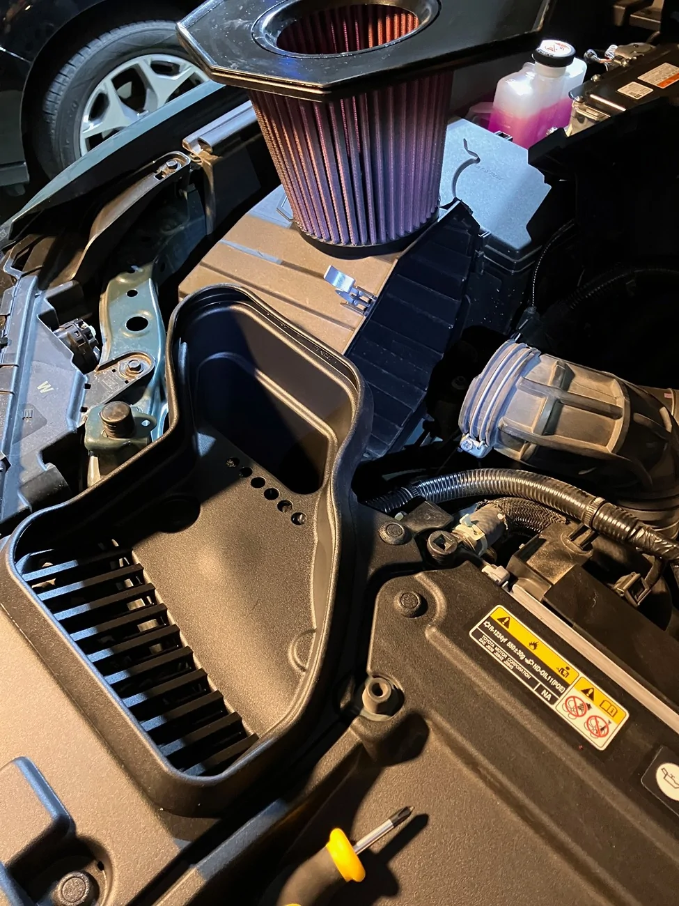

  3. Remove the air box by simply pulling the air box straight up and out of the snorkel inlet. The air box is held in place by three pins and is very simple to remove and reinstall.
At this point you have two methods (4A or 4B) to plug the snorkel:
4A. Insert an oversized oblong shaped piece of foam (4” bedding foam works great) into the snorkel inlet (pic #2). Go to step 5 below.
OR
4B. a). Using the red plug that comes with the Coupling Kit, (pic #4) plug the air box snorkel inlet.
b). To make room for the red plug when reinstalling the air box, you need to remove two bolts and the elbow going through the fender wall (pic #5).
5. Remove black cap from the lower outside of the air box (pic #3).
6.Connect red elbow that comes with the Coupling Kit to the air box, same point that you removed the black cap.
7. Reinstall the air box by lining up the pins and pushing the box down into place.
8. Reinsert air filter and secure air box cover.
9. Remove a small plastic support held in place by two clips (pic #6). Helpful hint: The clips can easily be removed by depressing the center of the clip then pulling them out. These clips will be reused.
10. Install Inlet, Air Cleaner by lining it up with the red elbow and installing a total of 5 clips. (pic #7 & #8).

PIC #2
PIC#3

Pic #4 shows two 'caps' (one red and one black). The red cap comes with the Coupling Kit (PTR03-35241-AE). The black cap comes with the truck (located on the bottom/side of the air box, it needs to be removed to install the red elbow).
Hope this helps!
