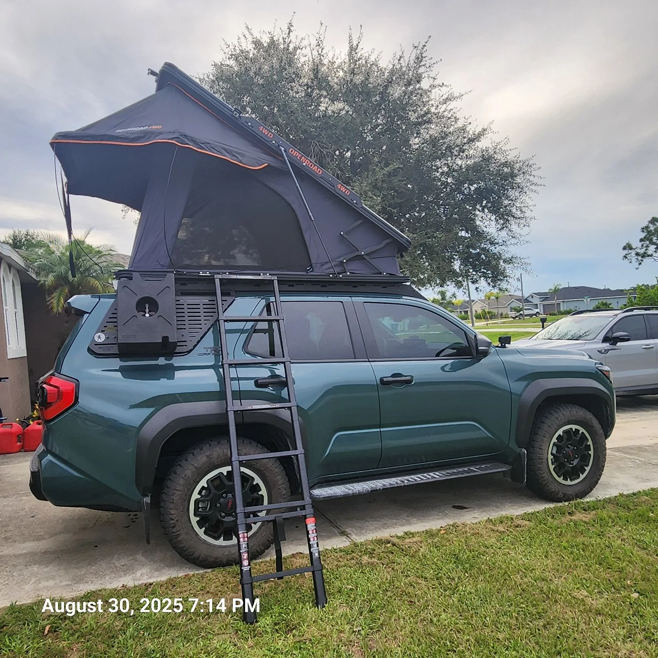

looks good! where does the ladder go when the tent is collapsed?
It collapses and comes with a storage bag. I haven't tried yet but I believe it will fit inside the tent. However, I will probably store it in the back of the 4runner so I don't have to climb up the side to get to it. Rather just pull it out and hook it up.

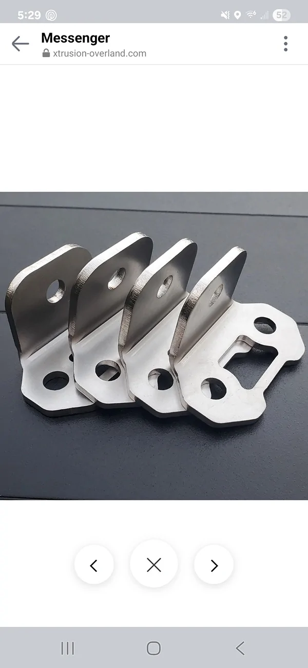

I just asked on your other thread with the CBI bumper, but I think this would be the better thread for it. How did you mount your rtt to the rack? Did you use the westcott rtt mounting brackets?
I originally used the brackets that came with the tent however with only 4 brackets and as flexible as they were the tent would smack the cross bars on the rack so I actually ordered 2 sets of the brackets from Xtrusion. I had to uninstall each bar and mount it directly and precisely too the tent before lowering the tent back onto the rest of the rack. Time consuming but well worth it. Zero movement or rattle now. I used a total of 14 of the brackets in the attached pic. Probably overkill but it damn sure ain't going anywhere lol
That was one of the other options I found too. Im starting to lean that way since that keeps it lower than the Westcott mounts. Thanks!
