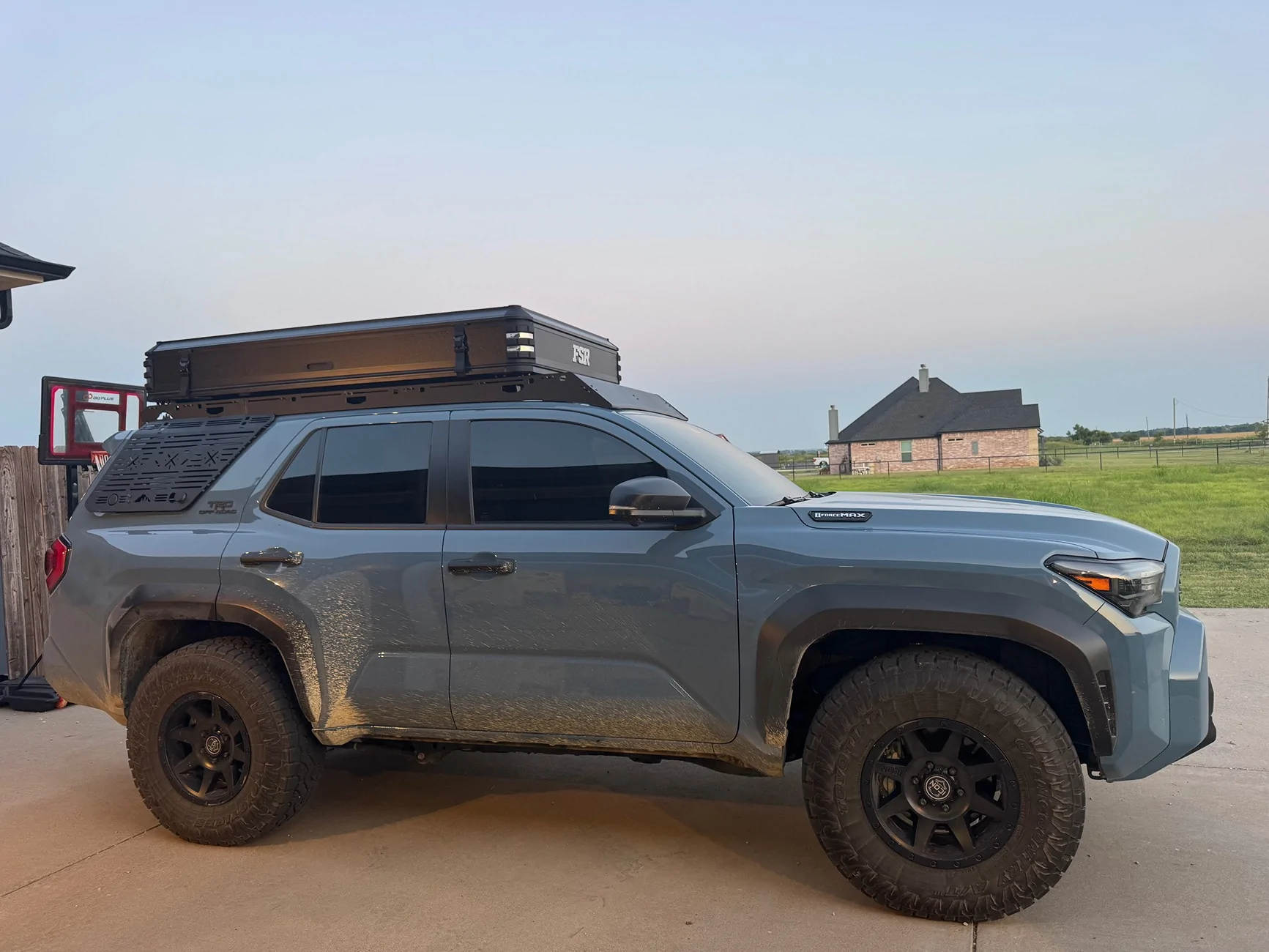

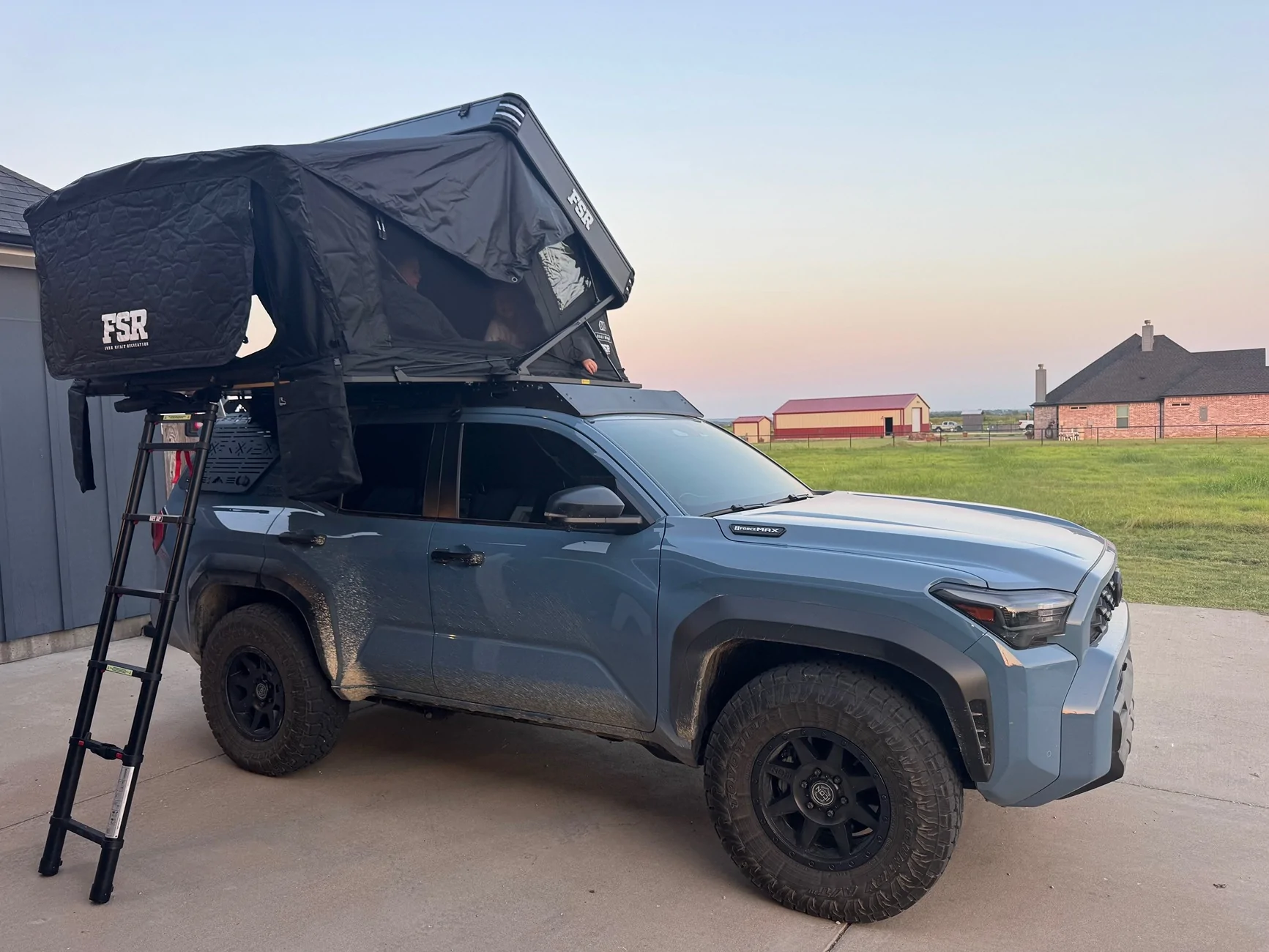

1 - I am an RTT fan boy but its important to start out by saying, spending money on an RTT to "start overlanding and camping" is NOT necessary. Get a ground tent and cot so you can decide if this is something you even want to do. RTT are expensive no matter how you slice it.
2 - What is your budget?
3 - hardshell tents are superior in every way to soft shell tents
4 - a side open clamshell tent similar to the FSR kali or Ikamper mini would be the best choice almost certainly. Those "should" leave the moonroof clear
5- check the dynamic load rating and static load rating of that OEM rack. IT must be able to support he weight of the tent and people sleeping in the tent.
6 - be cautious with tent resellers (people who buy a generic tent from a Chinese manufacturer and just rebrand it). Look for people who actually design their tents and control the manufacturing of their tents.
Feel free to DM me and I'll help sift through the options. I just did this for my own purchase earlier this year. I've got a pretty good pulse on the market right now.

I’ve been eyeballing the Kali FSR RTT and plan on running it year-round — daily driver included. The only installs I can find online are on truck beds, which isn’t super helpful for visualizing it on a 4Runner (open and closed). It checks all my boxes, but I’m a little hesitant to throw a massive box on the roof when the closed profile isn’t exactly subtle.
How are you liking yours so far? Do you notice it up there day-to-day, or does it just become part of the vehicle?

I have the kali king and I only keep it on when we are camping and about a week or so after because I’m lazy. Just be aware of mounting to low profile racks. That’s the biggest challenge. I bought van ultra mounts and had to modify to make it work.
The tent is amazing. I’ve never had one that I’ve enjoyed this much, full stop. You definitely know it’s there though, it’s heavy and not aero at all
