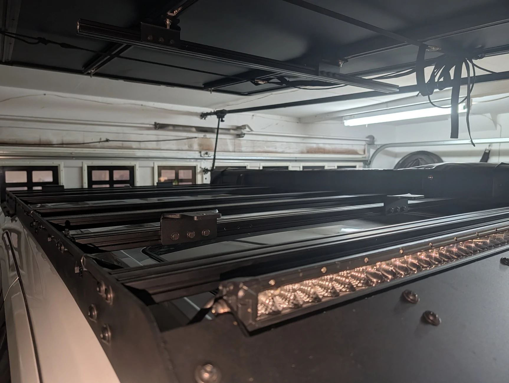

The westcott brackets attach to the side rails of the rack for the awning. The tent for me is using the Sherpa tall mounts (1" above cross rails). I used 8 mount 4 at attached to rail near the center and stays mounted to the top tent. You can see it hanging off bottom of the tent.
2025 2026 4runner 6th gen OPENROAD Aluminum Hard Shell LT Roof Top Tent RTT installed PXL_20260406_140511230
There are other options as far how to meet the tent and the awning. The tent will always mount to cross rails and some awning mounts will mint to cross rails too. The tent is off center. The awing sticks out about 6" outside the side of car and the tent is about the same on the other side. There is a few inch gap between the two to allow me to get install cross rails and get to latches for the tent to open and close it. Length wise it's sits right above is it the light bar in front and about an inch from where my liftgate stops to clear my garage door when open.

Ooooh okay, this makes so much sense now! I didn't know there were tent mounts that could create a gap, this was the missing piece. Thank you so much responding with the pictures!

Clean setup.
What are you using to lift & suspend the tent from your garage ceiling ?
