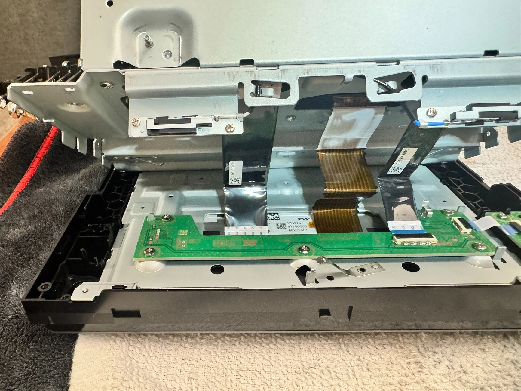

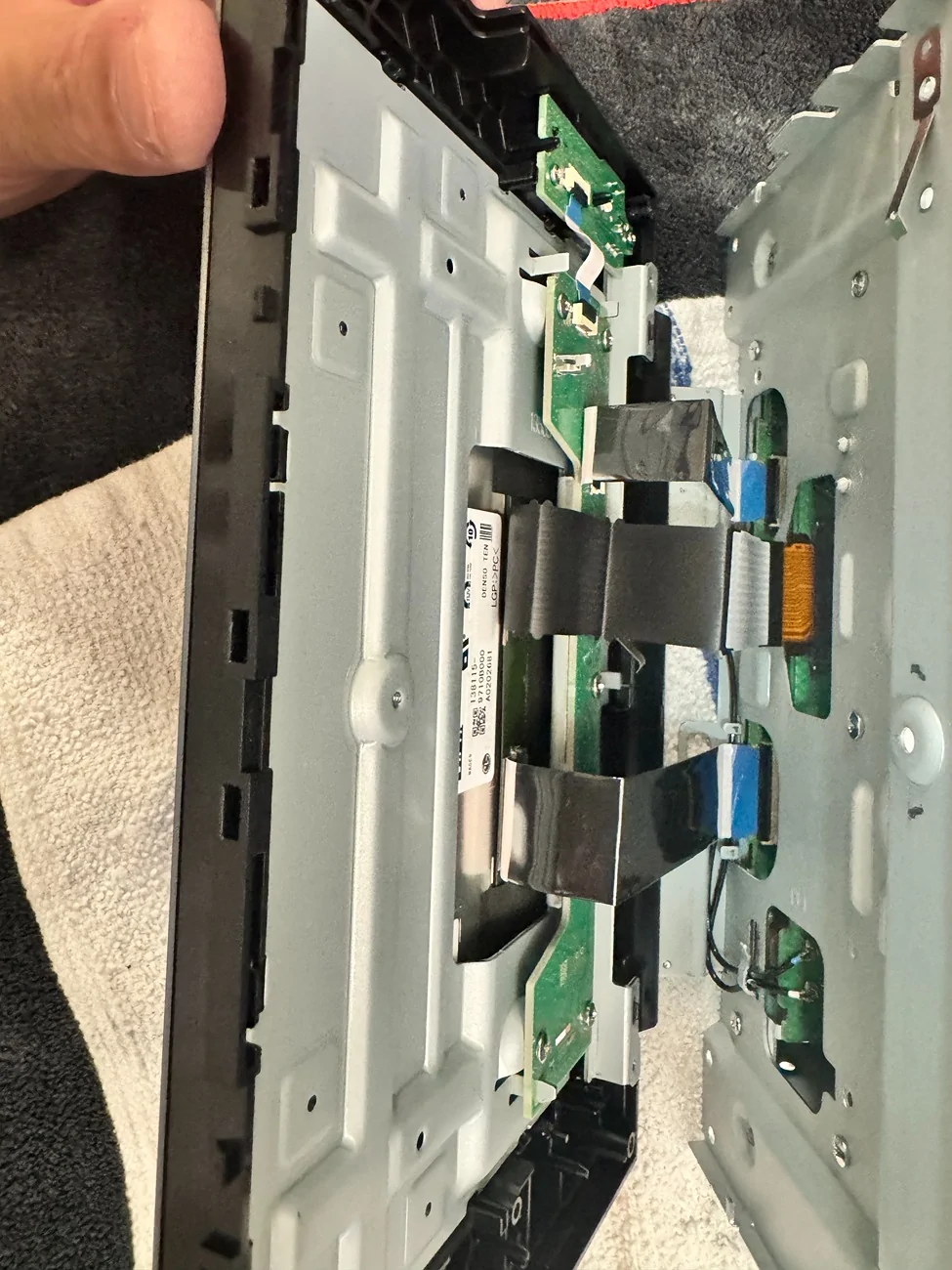

Someone mentioned the possibility of using Tacoma parts to upgrade the screen, which made me curious. I took some measurements, compared online pictures, and opened my 5th-gen 4Runner 8-inch multimedia unit to see if this swap could actually be possible.
My findings are interesting. I don't think it's a simple plug-and-play swap, but I also don't think it's impossible. With the right fabrication and electronics knowledge, someone (possibly an aftermarket company overseas) could probably make this work.

- The screen mounting points are completely different because the 14-inch unit is much larger.
- The 8-inch unit uses a ribbon cable for the volume control and some controls, which would need to be addressed.
